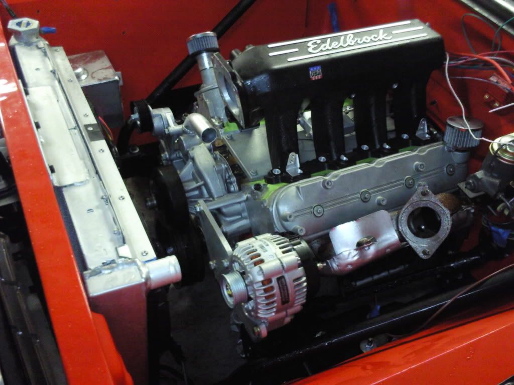

Building a pro street 64 nova Using a 100K junk yard LQ4 stock bottom end
So Far
ARP head studs
ls7 lifters
SDPC cam 230/236 @50 615ish lift 116 LS
ls2 timming chain
MLS head gaskets
comp pushrods
patriot gold springs
C6 manifolds flipped
Need some help picking turbos intercooler and injectors
looking for 600-800 RWHP depending on boost
This is street/strip mostly street car running pump gas with meth [/IMG]

looks good. have you seend BoostedOne's Thread on his TT nova? similar set up. I like your water pump mod, I have that planned for mine also.

decided to go with precision 6265 ported turbos and a treadstone intercooler
still trying to get the other turbo mocked up

i really like how the IC is flipped and stuffed in the grille, gives tons more room, how is the ID to TB pipe going to go, under the rad and up? Good stuff.

I notched the core support to fit a 90 degree elbo on the intercooler so the piping will go under the core support and radiator and then come up from there this was the only way I could get everything to fit the nova has a ton of room every were but around the grill

do you think there is enough room between the intercooler for the A/C condenser?

Its a very tight fit on a 64 not sure about a 67 I had to pull the bottom of the grill out to get everything to fit
