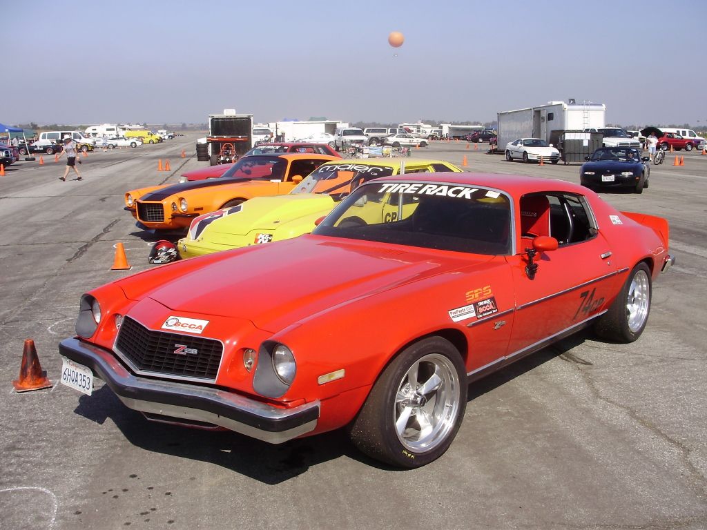

Here is a pic of a real CP car just to give you an idea:
Even the less serious guys like me are on slicks with gutted cars:

Posts: 3
Its all about the sway bar and spring rates. I have a 1.25 solid front bar, and a 7/8ths adjustable rear bar, AFCO 950 front springs and Landrum 325# rears. Pro Shocks rebound adjustable shocks, gutted the interior, yanked out the windshield wipers and ac, pulled out all the seats and put in a Kirkey (THE beest thing ive ever done to the car) and a removable steering wheel with a SCCA GCR legal cage, engine is a unremarkable 350 and way underpowered (the orange car in the background is putting down 560 at the wheels through a Mast engine). Wheels are 17x9.5 with continental road racing slicks 275/40/17.
Plans for the car are to lose weight first, fiberglass good, doors (and ditching of the windows), trunk lid, bumpers, and dash. I have several ideas for the engine, I will either go high compression race gas 383, or just hunt down a 6.2 from a new camaro at a junkyard.
SLO_Z28 is offline   Reply With Quote
