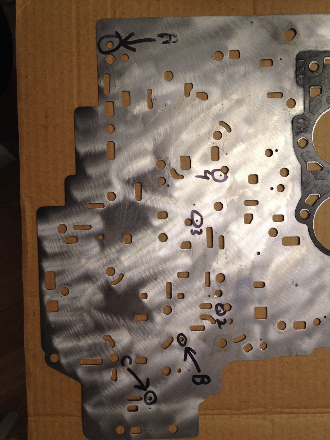

Where can I find hydraulic circuit diagrams to try to figure out why someone drilled out holes A, B and C in the separator plate?
I have the ATSG and it doesn't have enough info.

Looks like they installed a Transgo HD2 kit and drilled the plate like required from the kit. I don't recall it being that many holes needed to be drilled though
