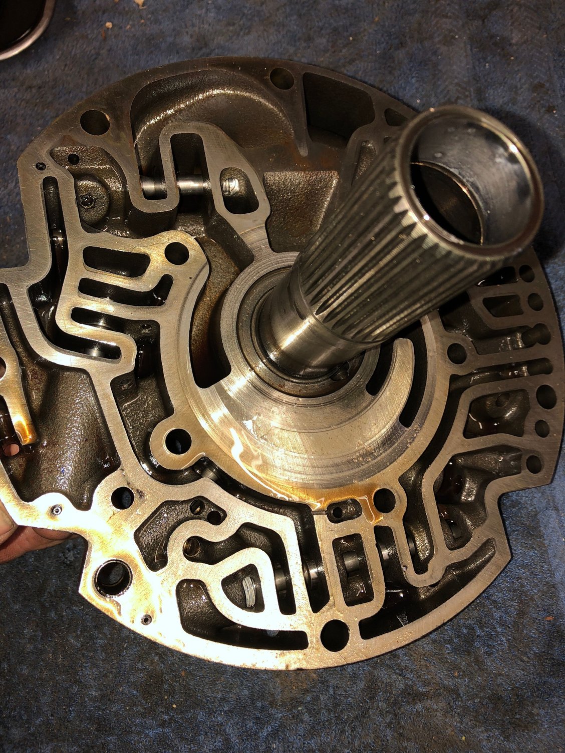

Well it’s tore down and I see no problems other then rear case bushing was walking a bit

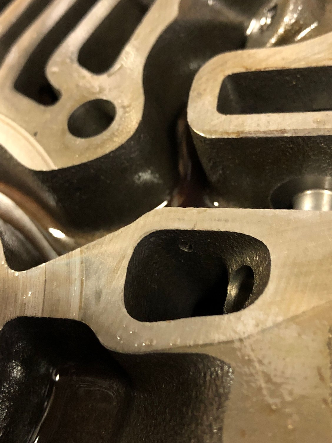

What size hole for the line to lube?
Hows the stator tube look?
Old Nov 1, 2018 | 12:35 PM
sbcfarmer's Avatar
Joined: Feb 2013
Posts: 34
From: michigan
.065 line to lube
stator tube looks fine

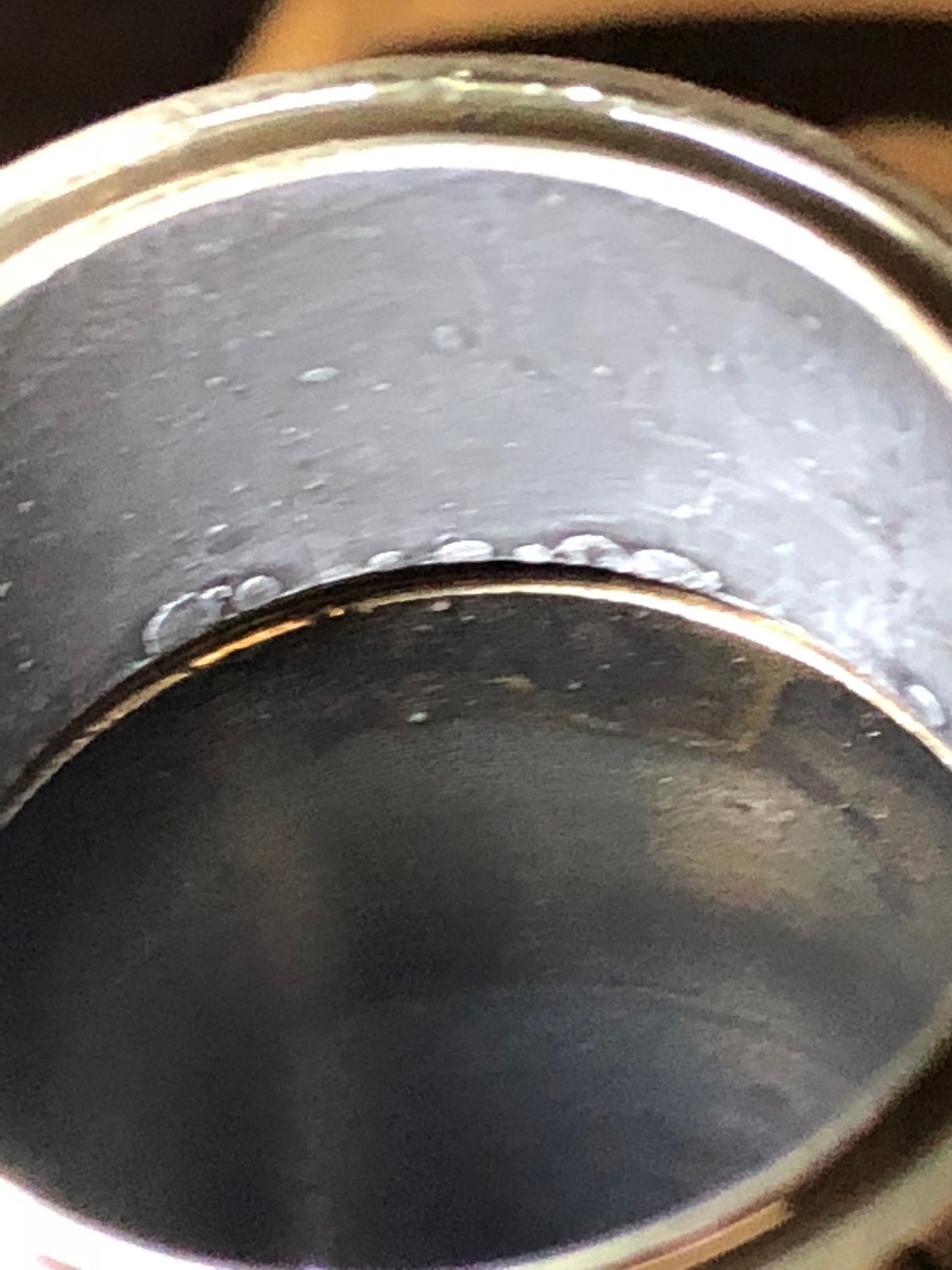

Maybe it's just the picture...but that oil looks brown and the stator tube bushing looks wiped out bigtime.
Like I said...maybe just the picture

your right and it looks to be a grounding issue as well a picture goes a long ways. that was a new bushing year and a half ago. I run hydraulic oil and some atf
its usually a bit darker but there is definitely some clutch material in the pan not much but enough
