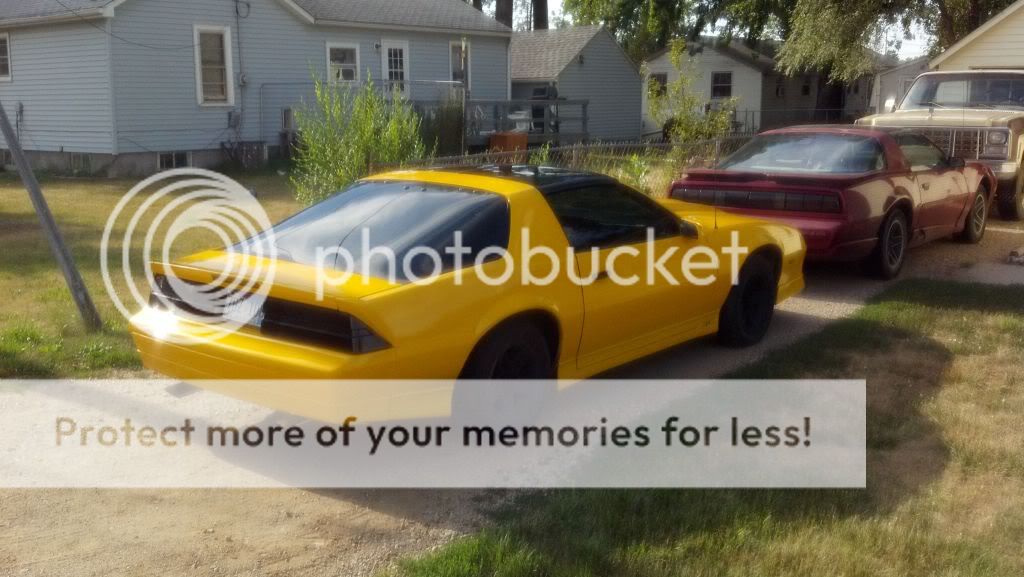

Old 07-21-2012, 05:01 AM
  #49
Join Date: Jul 2012
Location: yankton SD
Posts: 88
lsthirdgen is offline
Old 07-21-2012, 05:02 AM
  #50
Join Date: Jul 2012
Posts: 88
HA! it worked. thanks!

There ya go, nice ride btw. Got any more pics? Looks way better than the RS I just got.

Old 07-21-2012, 11:47 AM
  #53
Join Date: Jul 2012
Posts: 88
Old 07-21-2012, 11:48 AM
  #54
Join Date: Jul 2012
Posts: 88
Old 07-21-2012, 11:51 AM
  #55
Join Date: Jul 2012
Posts: 88
hmmm not sure why the one is small but here ya go. do you have pics of the rs up anywhere?

Nice BTW, what wheels you have planned in the future?
ZONES89RS is offline
Old 07-21-2012, 04:13 PM
  #58
Join Date: Jul 2012
Posts: 88
im not really sure. ill probly just keep an eye out for something i can pick up cheap. id like a set of 18s. whatever i find will get painted black for sure though,just not rattle can this time.lol
Old 07-21-2012, 08:15 PM
  #59
BLK95-Z's Avatar
Join Date: Jan 2010
Location: Ky
Posts: 672
I like the yellow with black wheels look. I think some 18" gunmetal z06 wheels would look sick with a little lower stance.
BLK95-Z is offline
Old 07-21-2012, 09:01 PM
  #60
Join Date: Jul 2012
Posts: 88
i love the look of z06 wheels on these cars but im just not willing to run 2 inch wheel spacers
