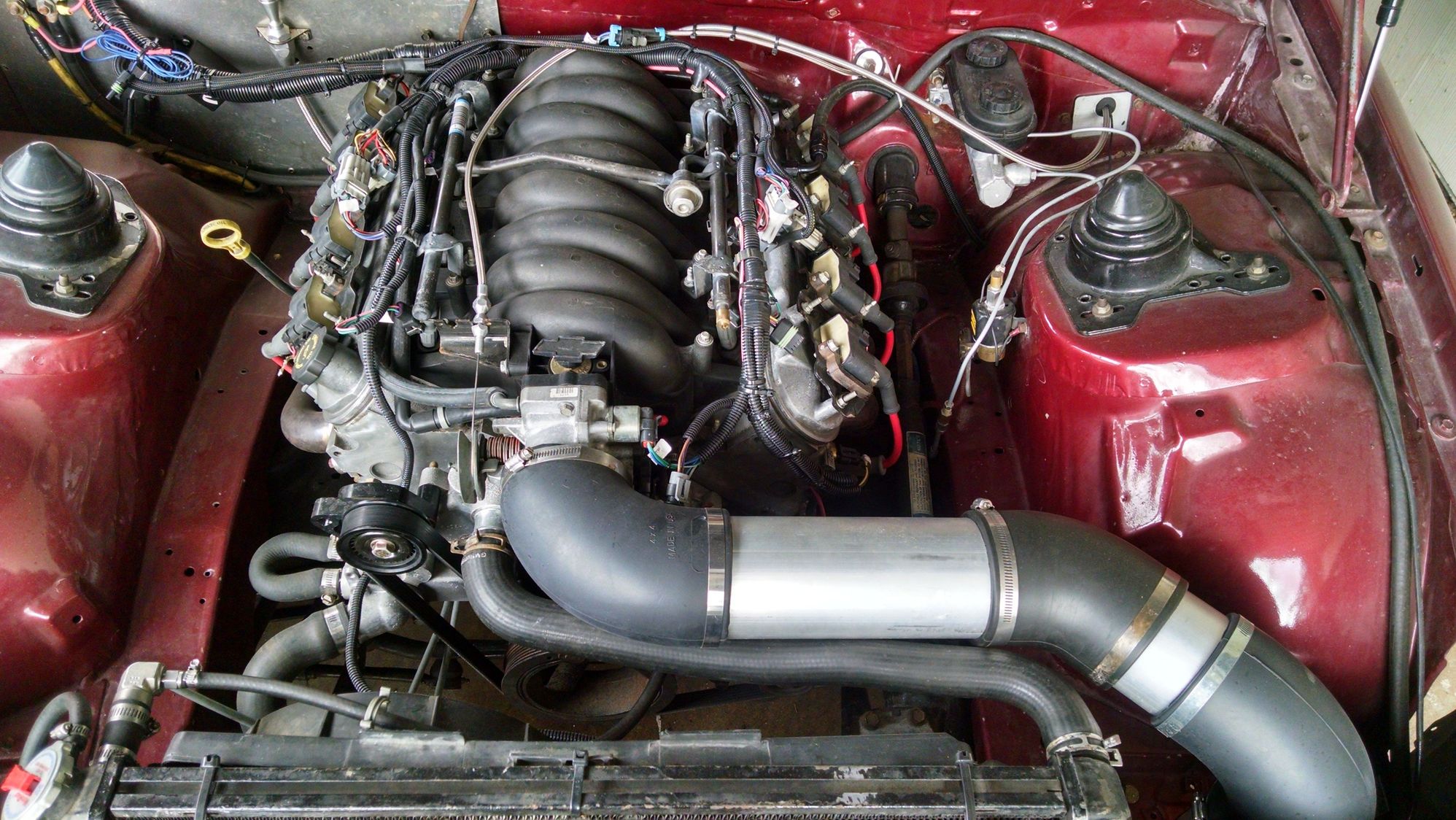

I envy you a ton for getting to run this class. My 90' LS swap Camaro drag car would have been perfect for this and competitive. It is one of the few class type deals left that can be fun without a ton of money.
https://m.youtube.com/watch?v=wjuu8qCTGbg
I have an LS1 sitting waiting on its turn, just didn't want it to get claimed this early in the season.
