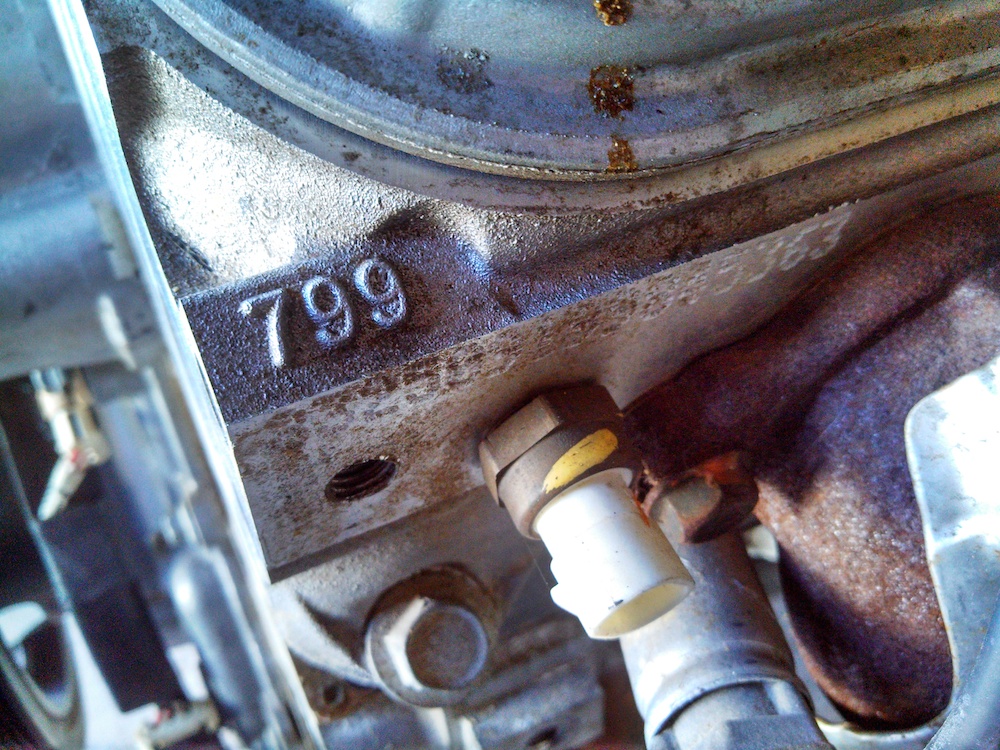

Well...I just got off the phone and pulled the trigger on a 2009 LH8. The LH8 is an aluminum block 5.3L with the good 799 heads and it does not have either the VVT or the AFM, which makes my life much easier. This engine is super clean and only has 368 miles on it. I probably paid a little too much, but you can't argue with a nearly new engine. Stay tuned for some pictures.

Well...here it is. I am very pleased with what I got. This engine is exactly as advertised and I totally believe that it only has 386 miles on it. It was shipped on Wednesday and arrived at my door this afternoon. I'll get it mounted on an engine stand over the weekend and start collecting more parts.
If anyone is ever considering getting parts from a salvage yard, I can recommend Fierge Auto Parts in Quincy, IL with confidence. They were very nice to deal with.

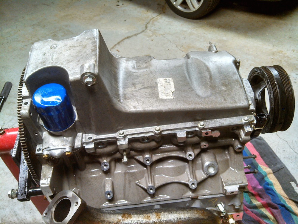

I then flipped the engine upside down. This is the stock LH8 oil pan that GM actually markets for doing swaps into various older cars. Frankly it doesn't work really well in any application because the sump is fairly deep so it tends to stick down lower than the front crossmember on cars like 64-72 a-bodies and 1st gen Camaros. It obviously won't work on the Cougar because I need a front sump pan:
So off it goes:
These engines have a full length windage tray that does a very good job of keeping the oil down in the pan instead of slinging it up into the crank.
However, when using different oil pans, you have to get the matching windage tray. Since I plan on using the 2004-2006 GTO front sump pan, the windage tray has to go too:
Here is the GTO windage tray:
Here I have the GTO pan mounted along with the Hooker exhaust manifolds. These probably will hurt ultimate performance, but I am not looking to squeeze every last ounce of performance from this engine, so fitment is more important. I am also able to reuse the MLS exhaust manifold gaskets.

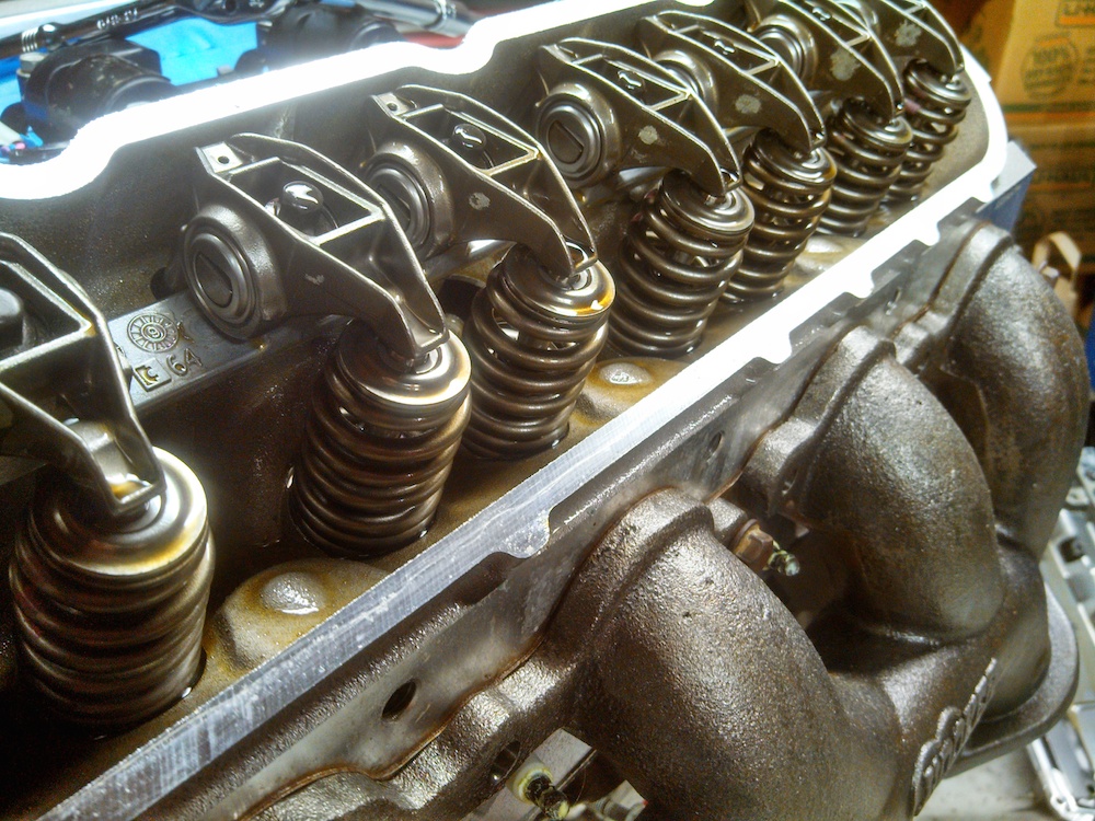

Here is a close-up of the valve train.
I will swap the springs out for stock LS9 springs and also use titanium retainers which will reduce valve train weight even further. This makes valve control easier and will allow me to raise the red-line. I plan on setting the rev-limiter in the 6750RPM range and shift at 6500rpm.
The current plan is to run the GM ASA cam. I know it is an older design but by all accounts it makes great mid-range and upper RPM power. It is also easy on the valve train since it was designed for endurance oval track racing. These cams also sound fantastic!
