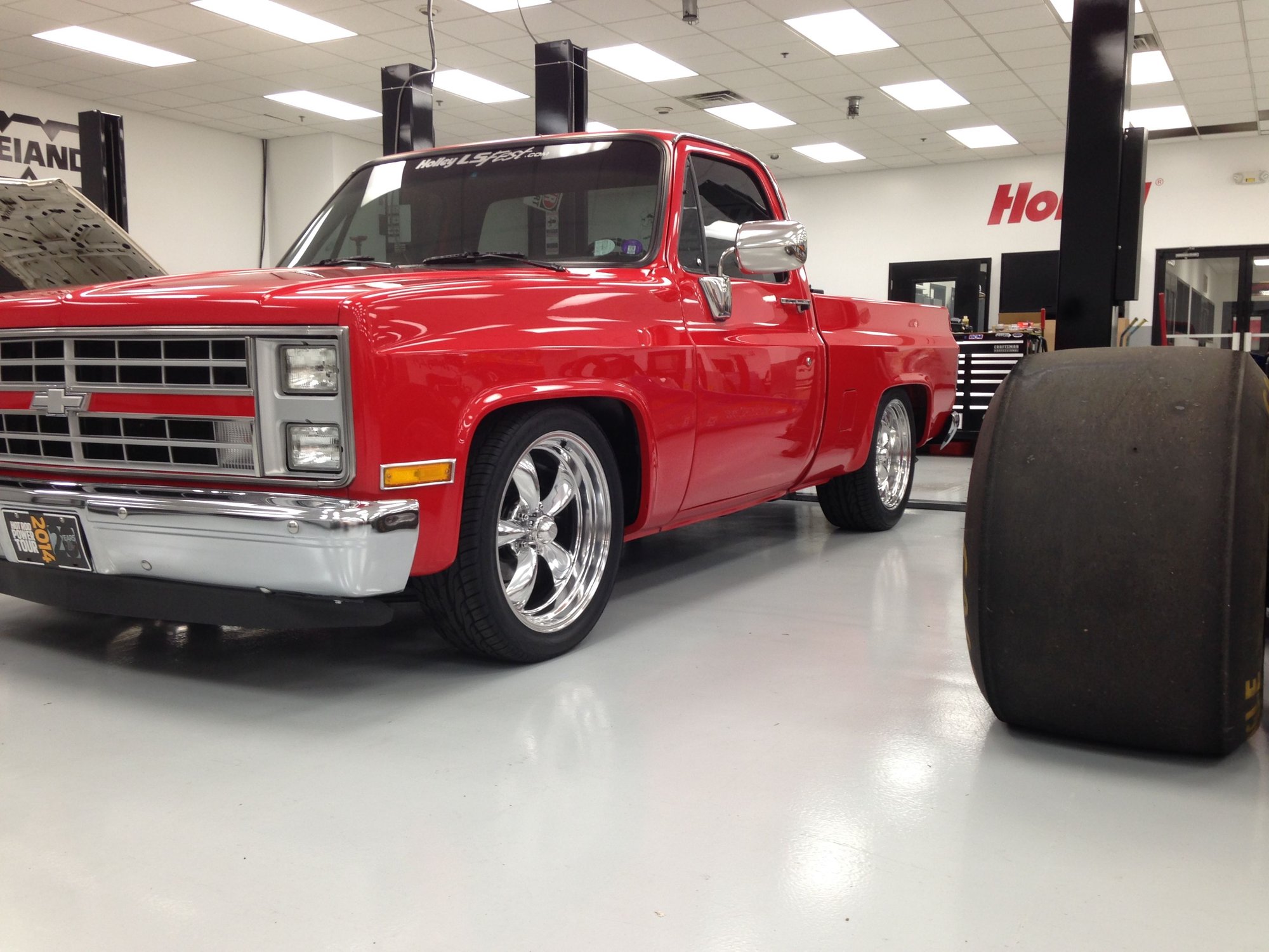

So here's some details, I built this red truck back in 2002 with a SBC/TH350, did all the body/paint work myself. Truck looked really good but there were always things I wish I had did differently. In 2012 I swapped in an LS/4l60 and tried to make the truck a more driver friendly vehicle, many cams/heads later I ended up with a 6.0/4L85 making 445RWHP. After much enjoyment, Truckin magazine spread and 3 Hot Rod Power Tours I decided it was time for some upgrades. I have always loved the factory color combos and really tired of the red paint so one for sure change will be the color combo. My end goal will be to have the ultimate driver that idles nice, rides nice, not too loud, quiet, cool factory appearing interior and just super enjoyable to drive across the states. Follow along!

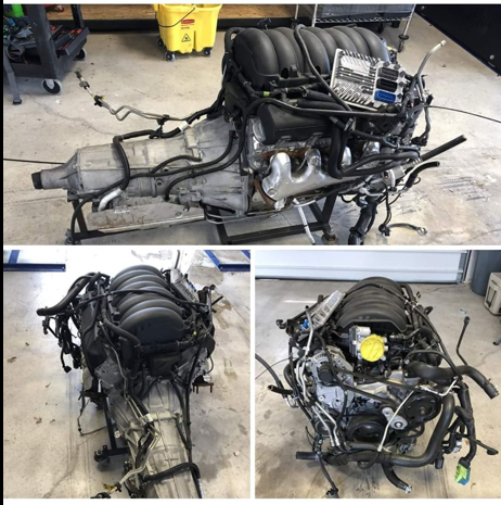

new engine L83-6L80
Old LQ9-4L85 coming out and going to another squarebody truck

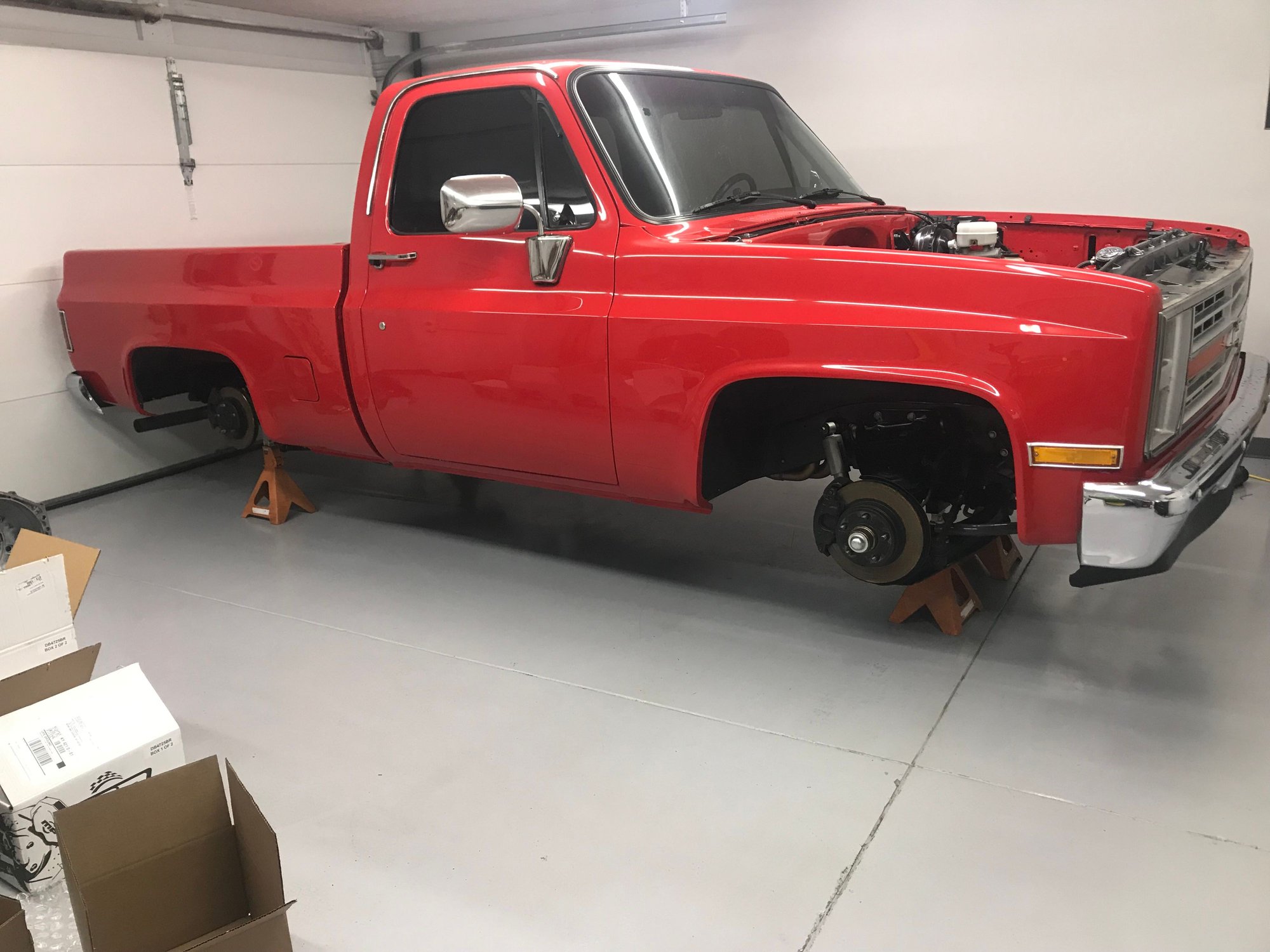

i wanted to start fresh with some OE paint doors, fender and hood to save time from taking paint thickness off the others, luckily just a few mins down the road a guy had a good buy on these and are in pretty good shape. now to fit and modify gaps!
bed dissembled, had UPol Raptor bedliner in the bed for years, I'm over that so some stripper will do the trick!

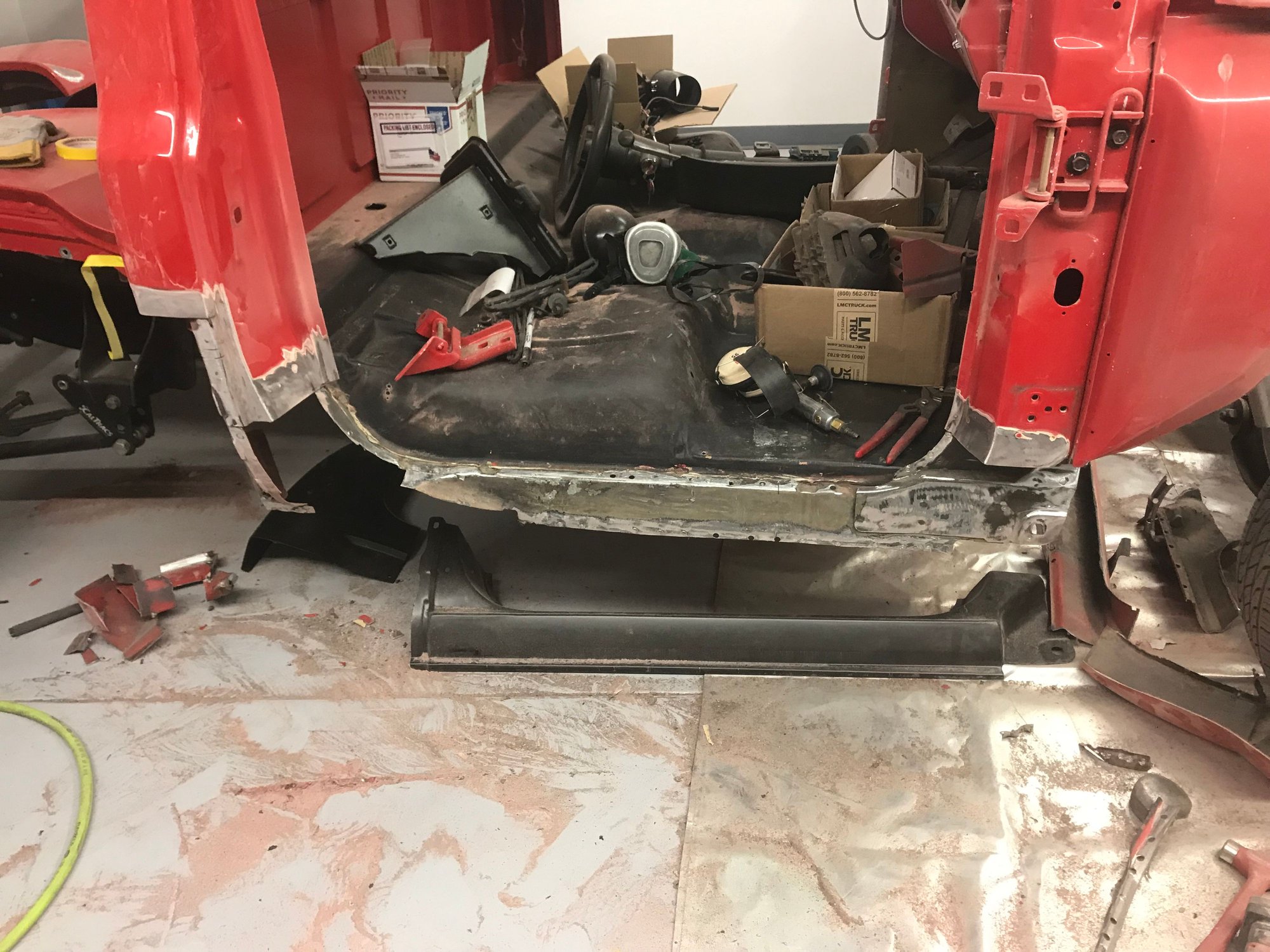

when i purchsed the truck nearly 20 years ago it had new rockers and cab corners installed, they weren't installed straight so i cut them out for a redo.
i plan to test fit anything that will require drilling before paint, started out with Vintage Air system.
I had trouble finding a few parts for my OE a/c box so i just decided to go Vintage Air, I do like that it takes up less room and gets rid of the vacuum lines and the huge duct work.

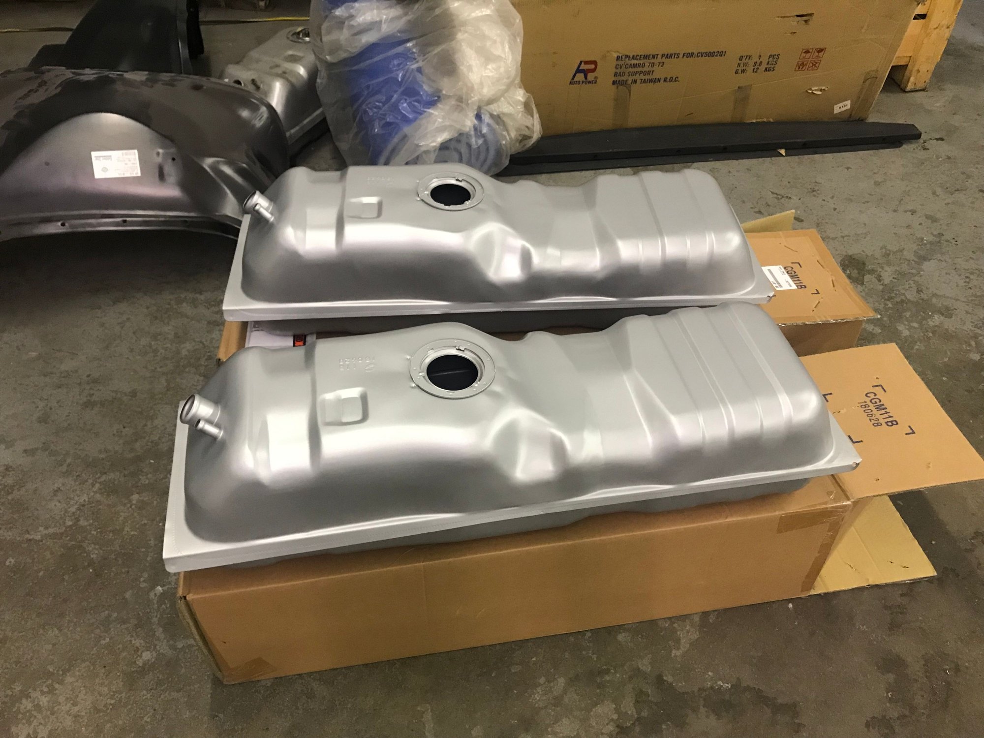

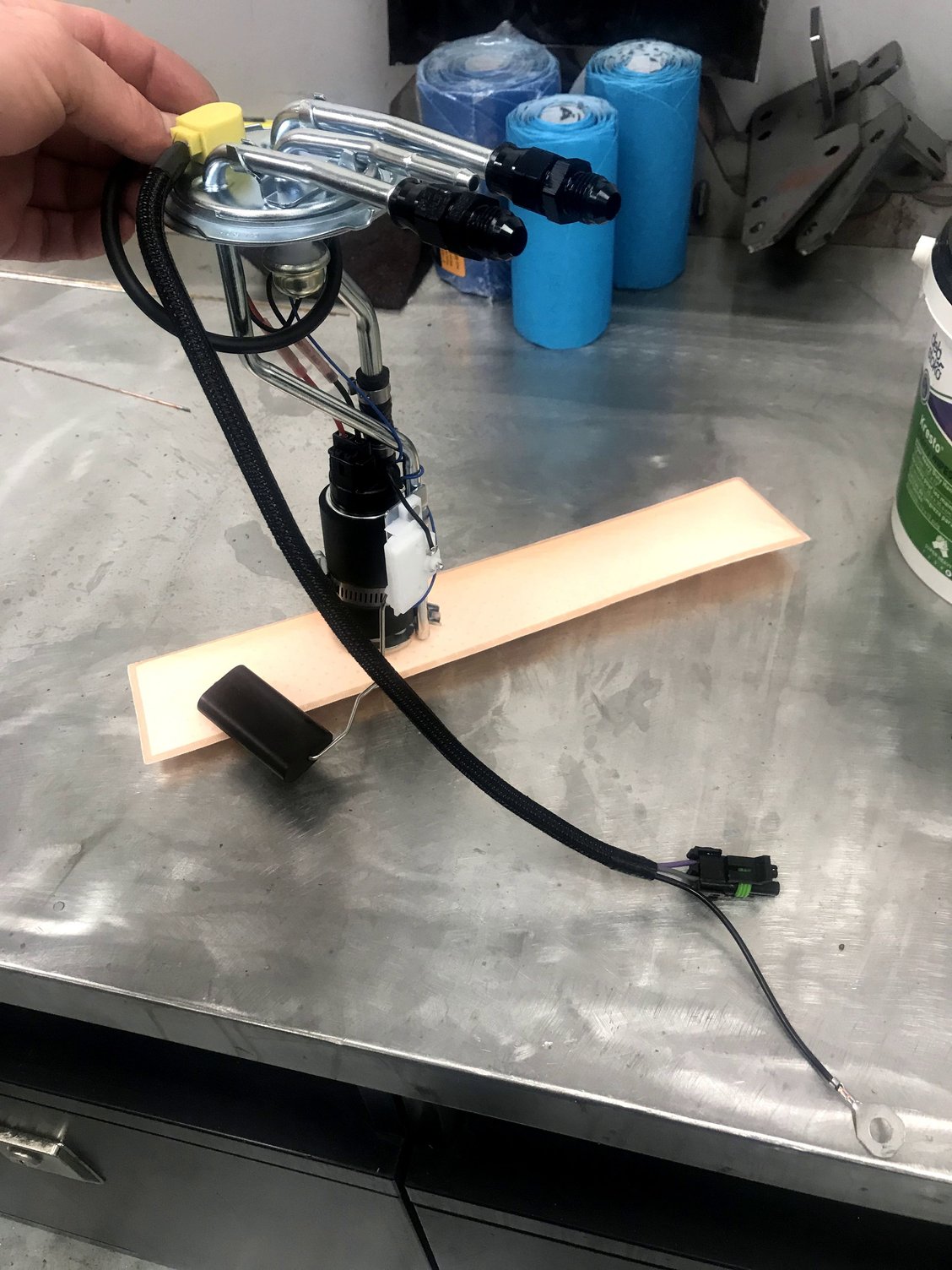

replacement fuel tanks from Holley ready to be assembled
using Earls compression fittings on feed and return along with a Holley hydramat to keep the Walbro 255 pump fed
I cut the bubble flare off the end and used these Earls comression fittings

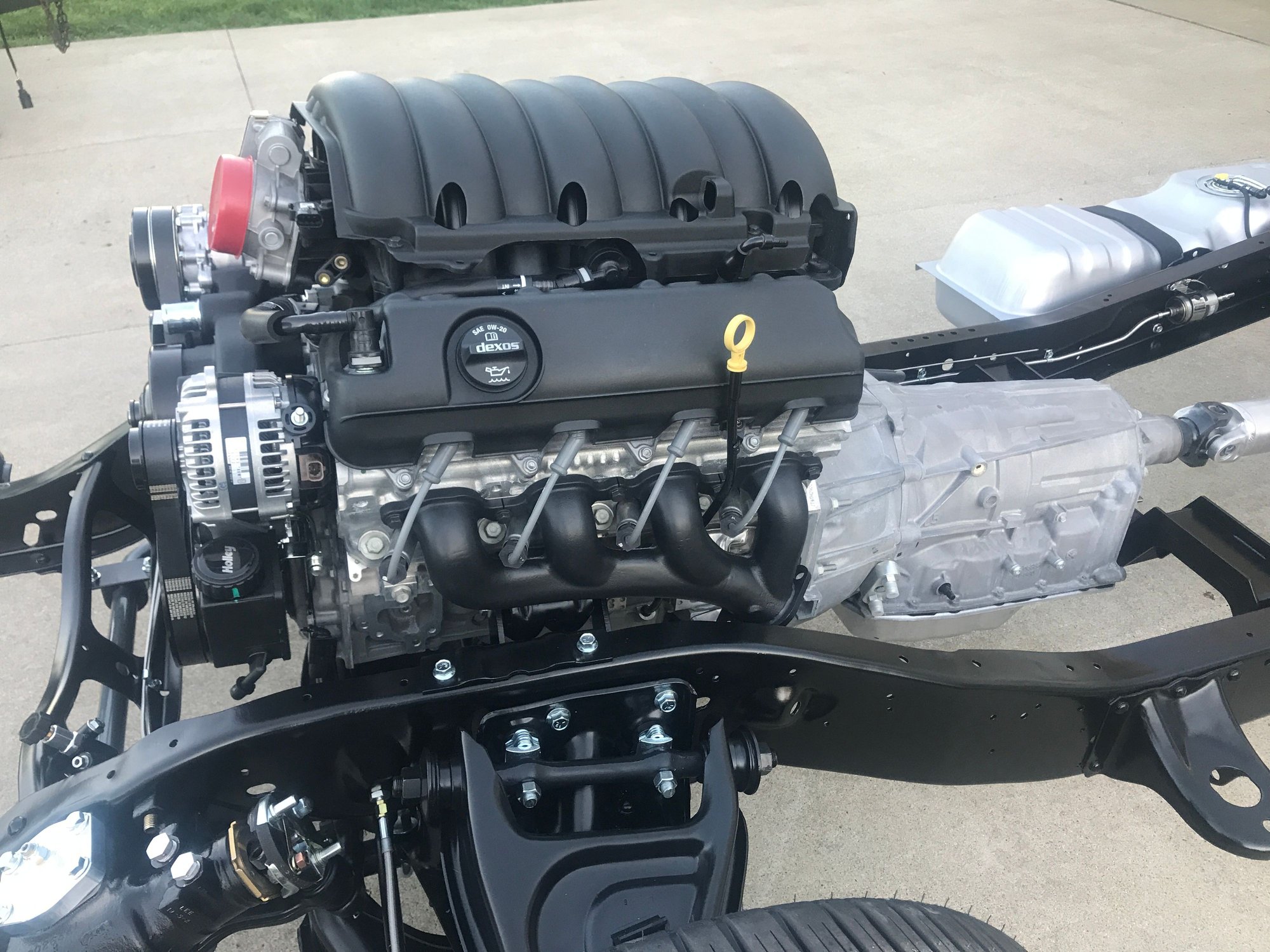

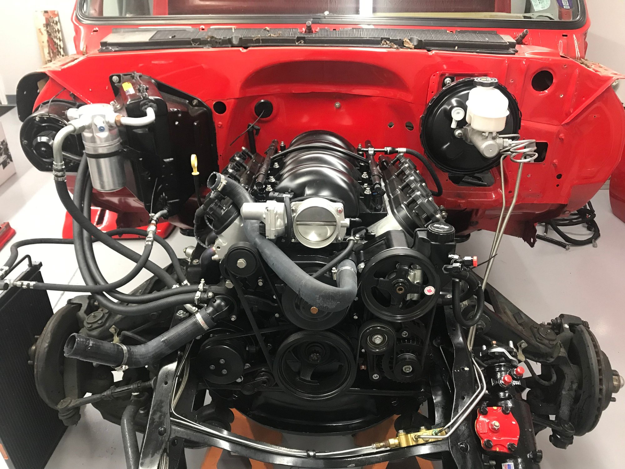

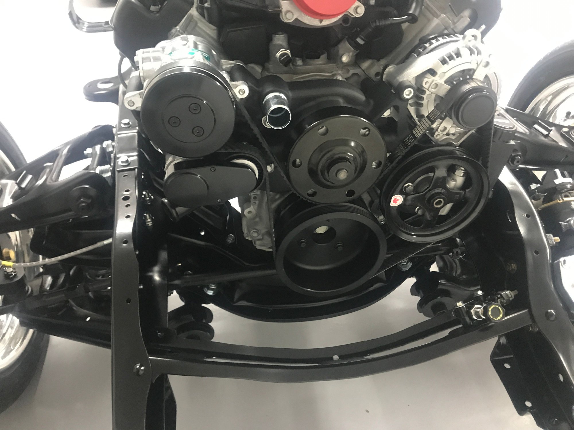

Engine test fit finished, using mounts a friend designed and a Hooker C10 crossmember everything clears great.

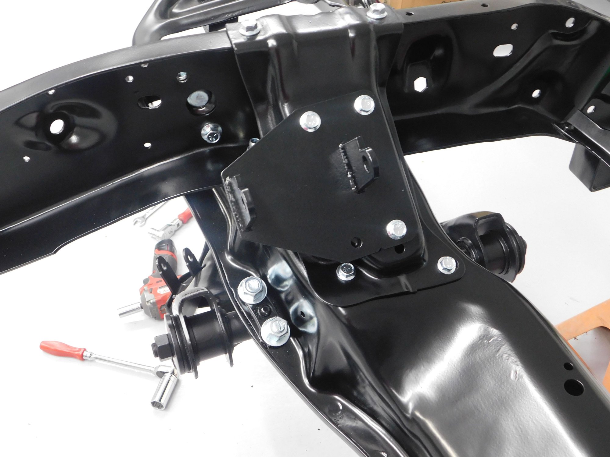

LT swap brackets that were designed by a friend work awesome

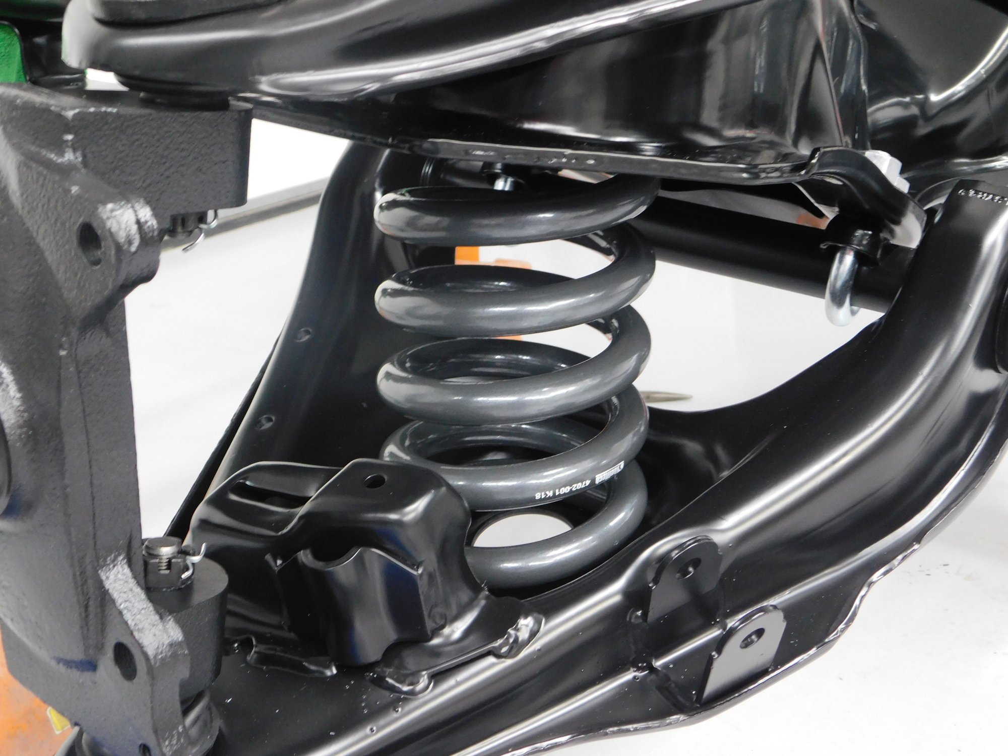

new upper and lower control arms from LMC, I did change out all the ball joints for ProForged ones
Belltech 2.5" drop springs has always been my go to for the C10's

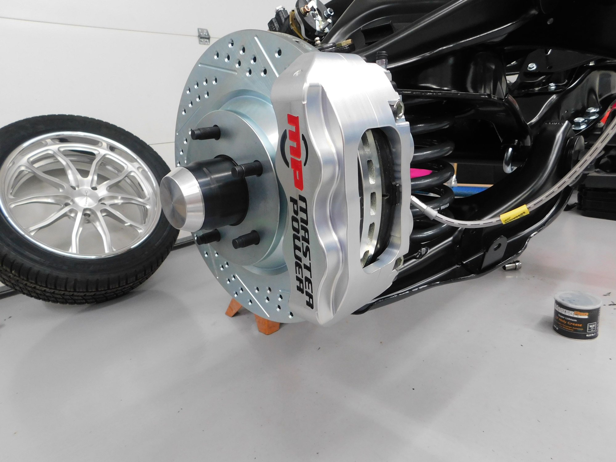

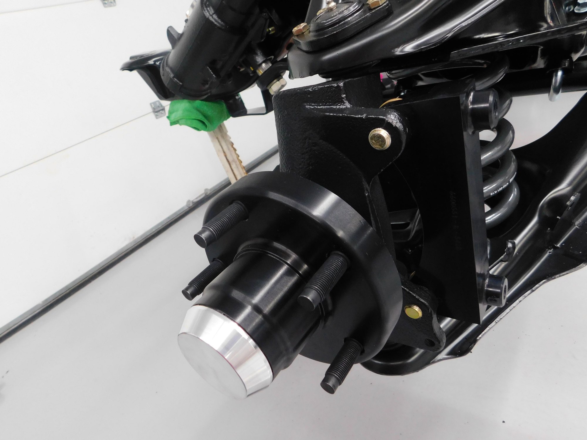

CPP modular 2.5" spindles with a hub for Master Power brakes

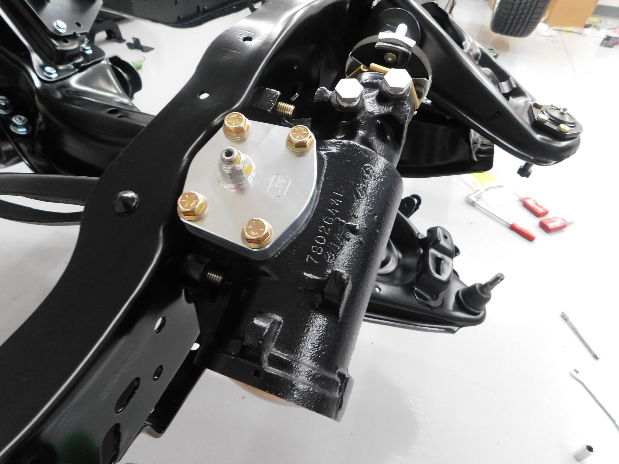

Lee Power Steering box, best box out there for these trucks!

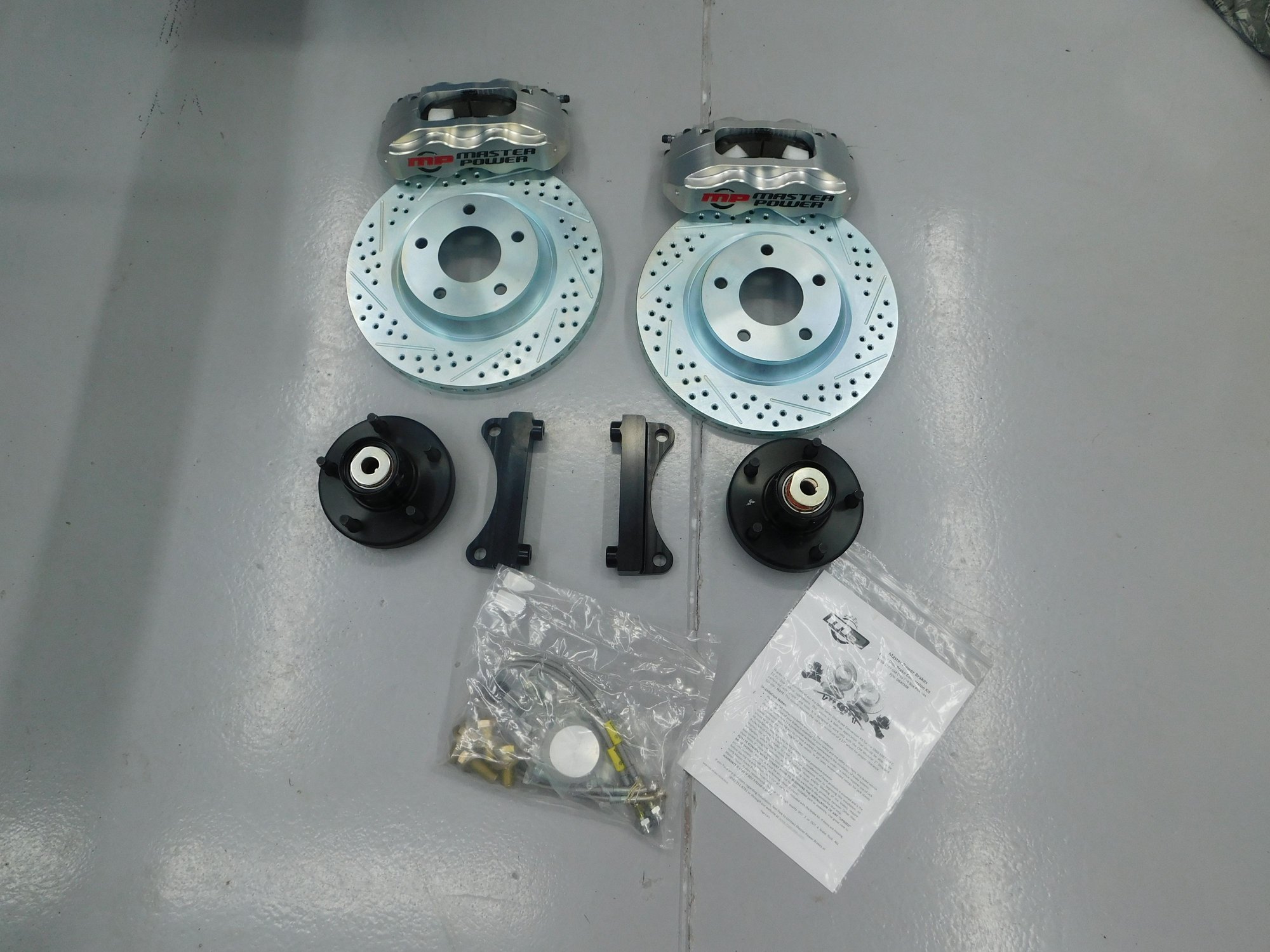

i'll be using Master Power Brakes on this build, 13" front and 12" rear
Front 4 piston caliper look awesome

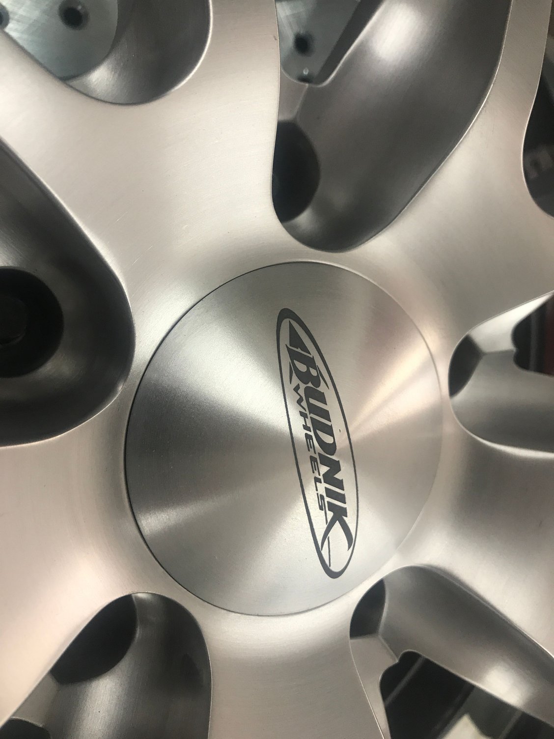

Budnik wheels, 20x10.5 and 20x8.5 with 5" backspace will fit perfect
polished lip with brushed centers

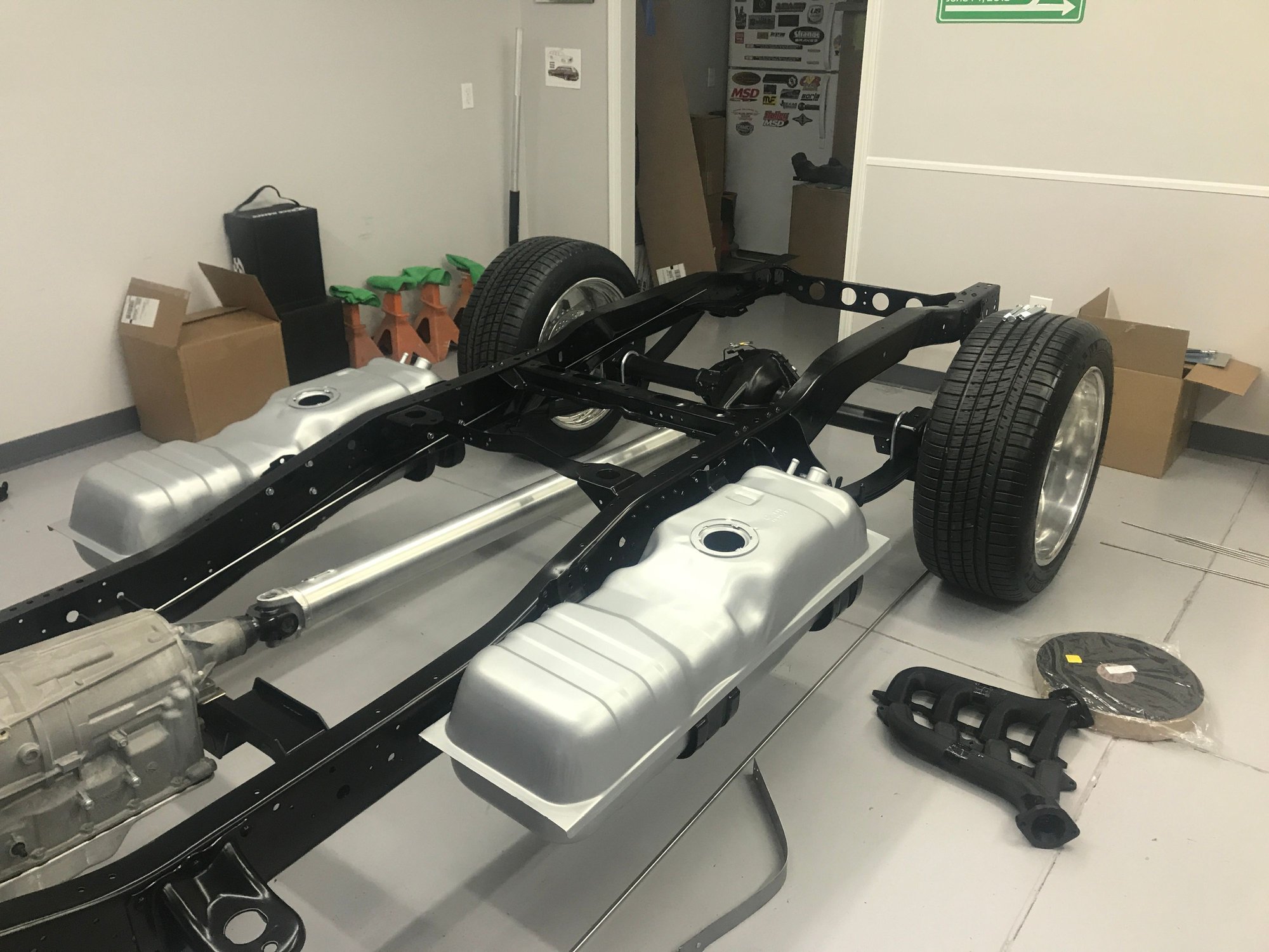

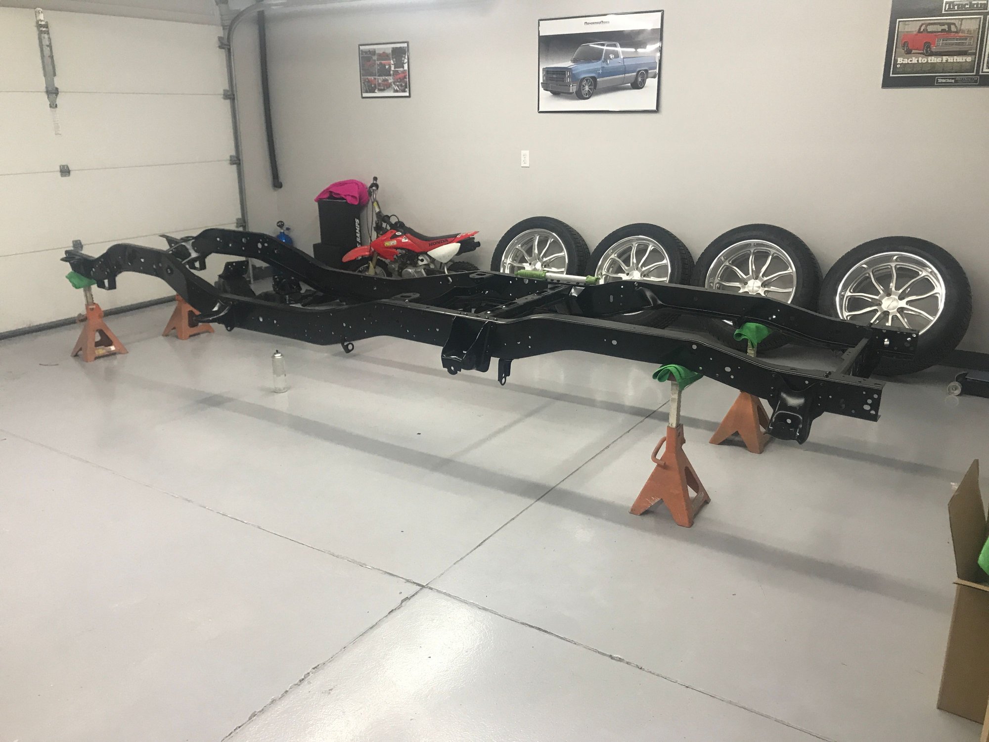

frame assembly nearing completion

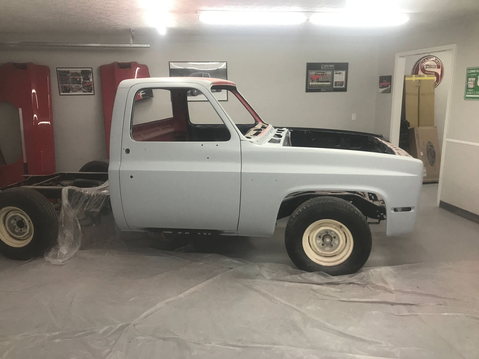

first of many paint days complete, using Tamco paint products

Dont hate me if i steal that color for myself.
Imitation is the sincerest form of flattery.
