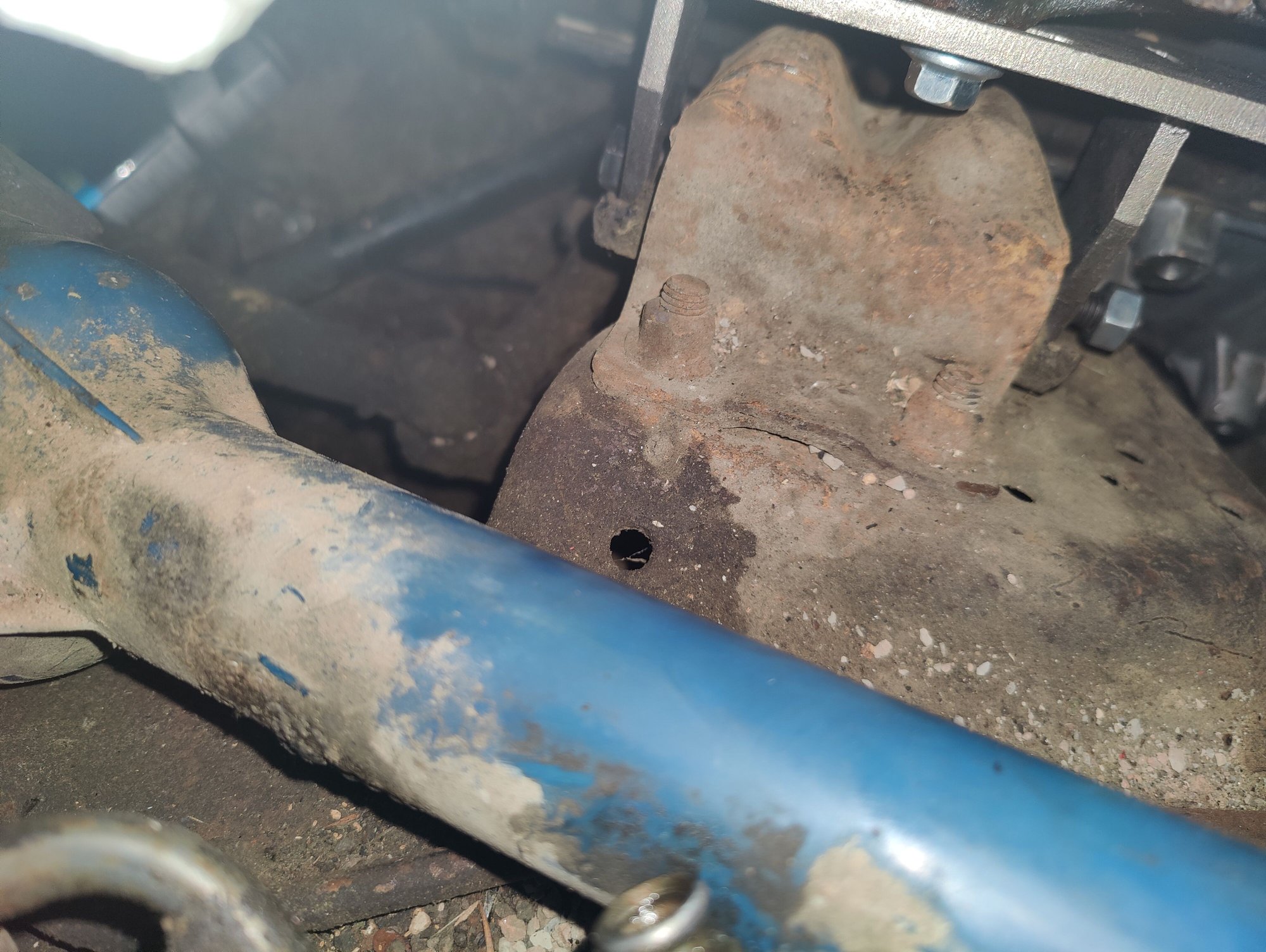

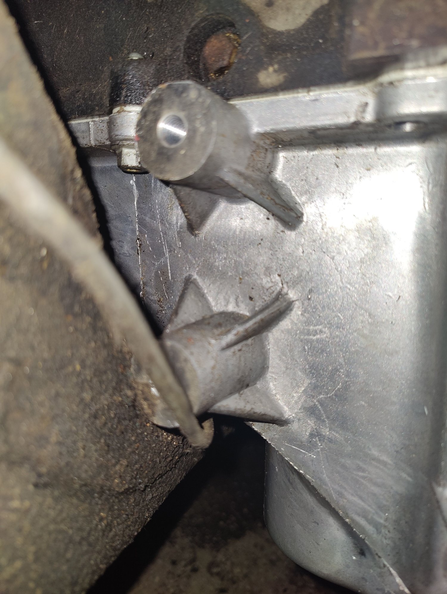

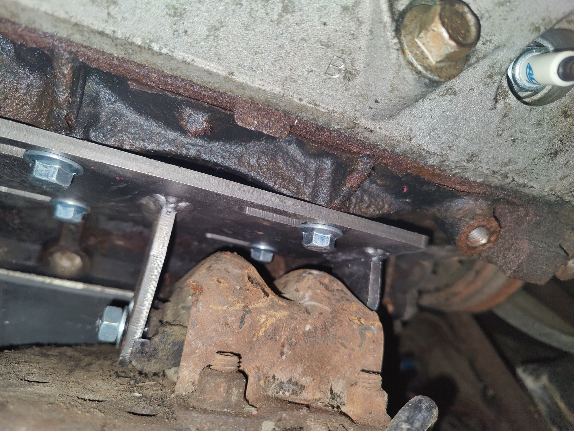

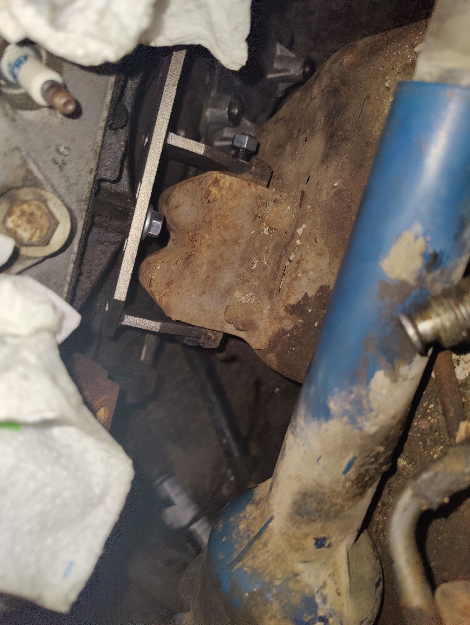

I need some help: I have a ls 5.3 with the cts-v oil pan. It is in the car (gbody) but is not aligned straight. One side of the engine is further back and will not slide forward because it is hitting the frame on the where I believe the oil cooler mounts. Has anyone else had this issue? Any advice? Thanks in advance!

So are you saying notch the frame or cut off the boss that is getting caught on the frame?

Cut the bosses off the oil pan
