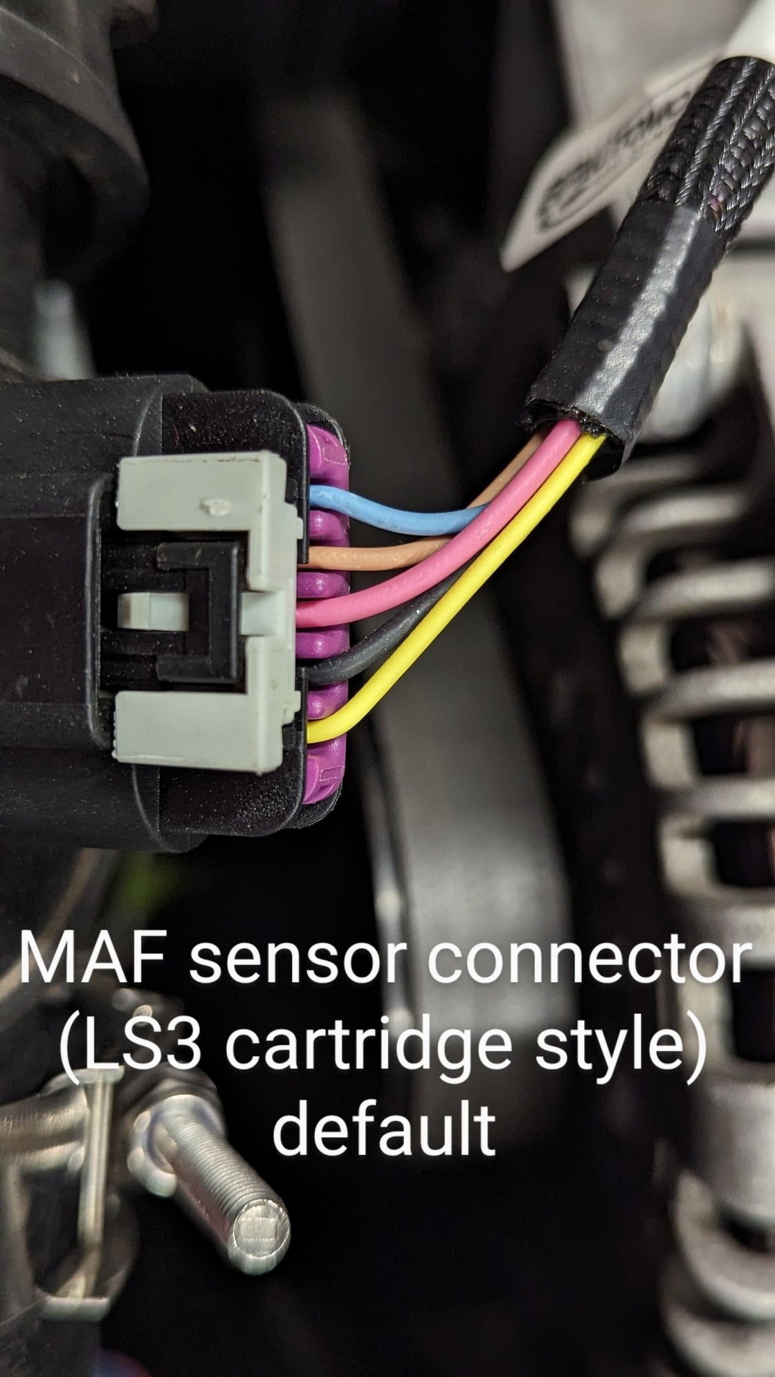

I have an L92 as well. I know I had to change the pins on the MAF sensor because when I ordered my harness I ordered it for an LS3 cartridge style since I intend to change over from the Vortec style MAF. Below is the wires I swapped to make it work for my truck MAF
