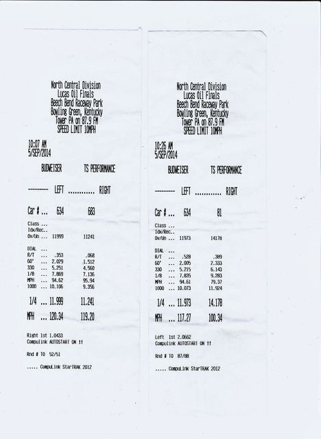

The Dynojet fudge factor between the one Mustang dyno in my arear, compared to the 3 Dynojets higher readings is 12.5% SAE more on one, 13.5% SAE more on another and 14.0% SAE more on high reading one LOL.
I think there are at least 3 ways you can back into HP from MPH. One of those 3 ways I got to match up almost same as my Mustang Dyno reading of 359 RWHP. Dynojet HP is 409 RWHP,.Curb weight of 3565 Lbs with driver an around 4 gallons of fuel (curb weight car with full tank of gas no driver is 3410 lbs and 3635 lbs with driver.
Trapped at 120.+ mph. ET 11.999 at LS Fest 1.97 60' 300 TW street tires. No burn out, no wheel spin off line, dead hook, with 52% of cars weight resting on rear tires with driver in it, almost full tank of gas because I filled up tank by mistake the night before when I arrived, . .
120 MPH trap speed only requires engine in car, in gear it traps in to be only turning 5800 RPM in order to trap at 120 MPH. That's the same RPM as Max HP for engine is achieved. Engine is a TQ one rather than HP one.
From my point of view, the ones who talk about High MPH meaning "you have more HP than Dyno shows is to help with their bruised Ego's only. That 1/4 mile long black Dyno's ET wins. not MPH or Dyno sheets....LOL
