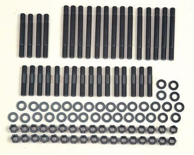

Old Feb 1, 2015 | 03:51 PM
  #59
vinceI's Avatar
Joined: Dec 2014
Posts: 211
From: Jim Thorpe Pa
Originally Posted by IronBlocked
Yes those will work on gen 3s
Correct me if im wrong but they are for a gen 4 (which is what he has I believe). wouldn't Gen 3 have 4 shorter studs?
Old Feb 1, 2015 | 03:59 PM
  #60
IronBlocked's Avatar
Joined: Jul 2014
Posts: 560
Yep you're right, 05+ uses 2 lenght whilst gen 3 uses these
