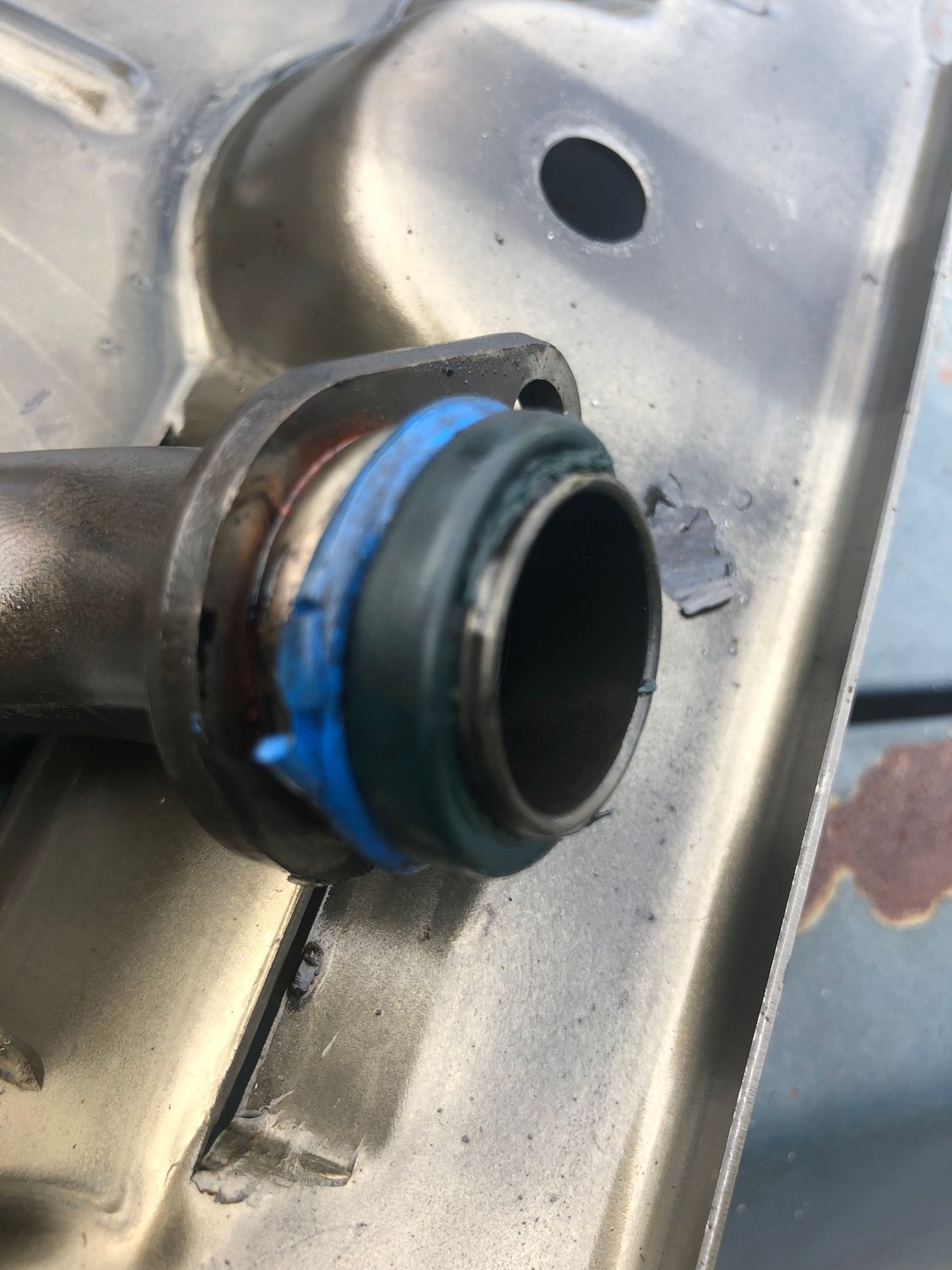

Well we we pulled the motor and did some inspection. This thing was overheated like hell. You can tell by the heat bands on the cam and crank. I think it was a low oil pressure that took out the main bearings.
#138
the 4.8 will make it's return BACK to the junkyard! haha
you can see the heat warping on the crank. The motor got crazy hot before it locked up. Unfortunately I don't have a temp or oil pressure gauge.
see bearings peaking out....
#140
Guys could this have been the cause of the catastrophic failure ? I have 2 o rings on my ls1 fbody pickup
maybe I left the original o-ring on? And also installed the new one by mistake ?
