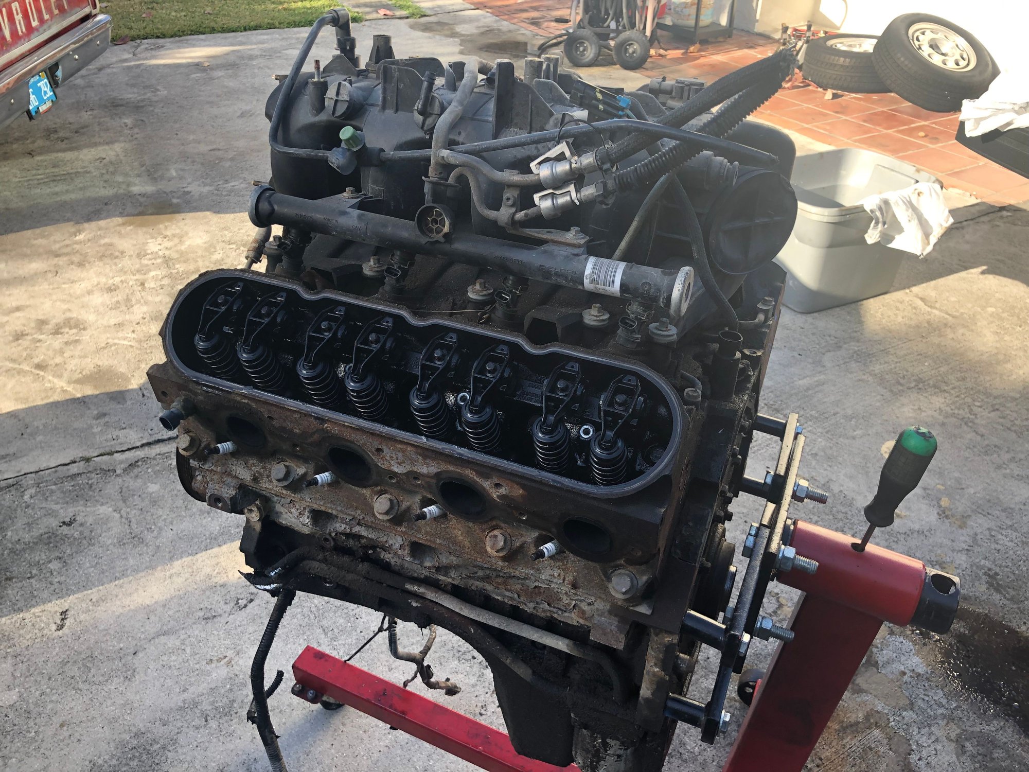

well guys, the new gen 4 4.8 that we gapped the rings on would not turn after re-assembly haha. So I believe the oil control rings were also gummed up like hell ( which I did not remove). I removed the whole bottom end and used a pick on all of the piston ring grooves. I will try to reassemble the bottom end this week. Will let you guys know.

i just used a tiny harbor freight pick took about an hour but got them pretty clean enough....

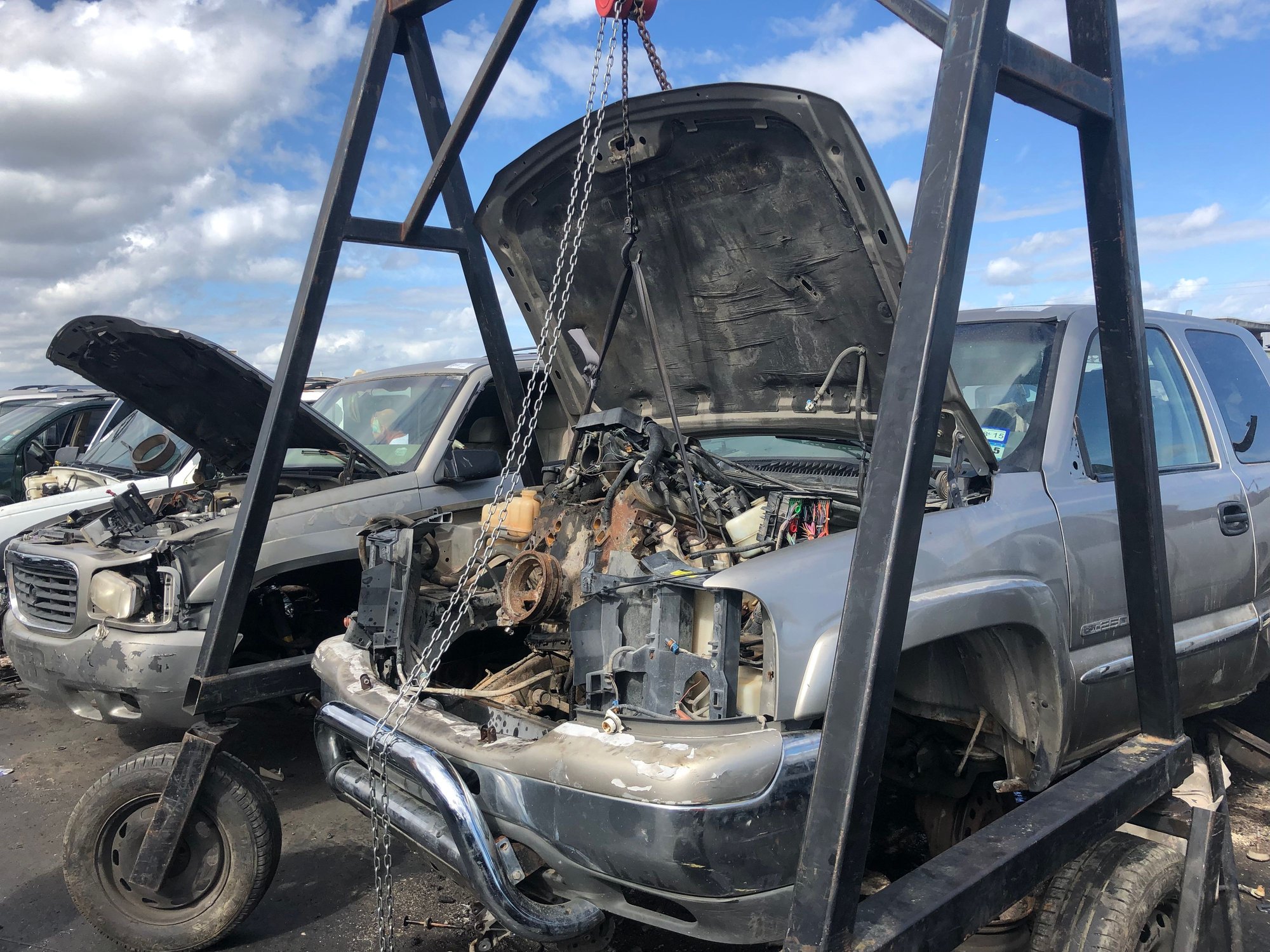

Well guys after a trip to the junkyard. I picked up a gen III 6.0 lq4. Unfortunately it has the iron heads. I really donít need this as my current converter is set up for a 4.8, and the 7875 I think may also be too small for the 6.0. Anyways I picked it up for a future setup. We will see what I do with it .....I plan getting some stock aluminum heads and some stock gen IV pistons for it.
