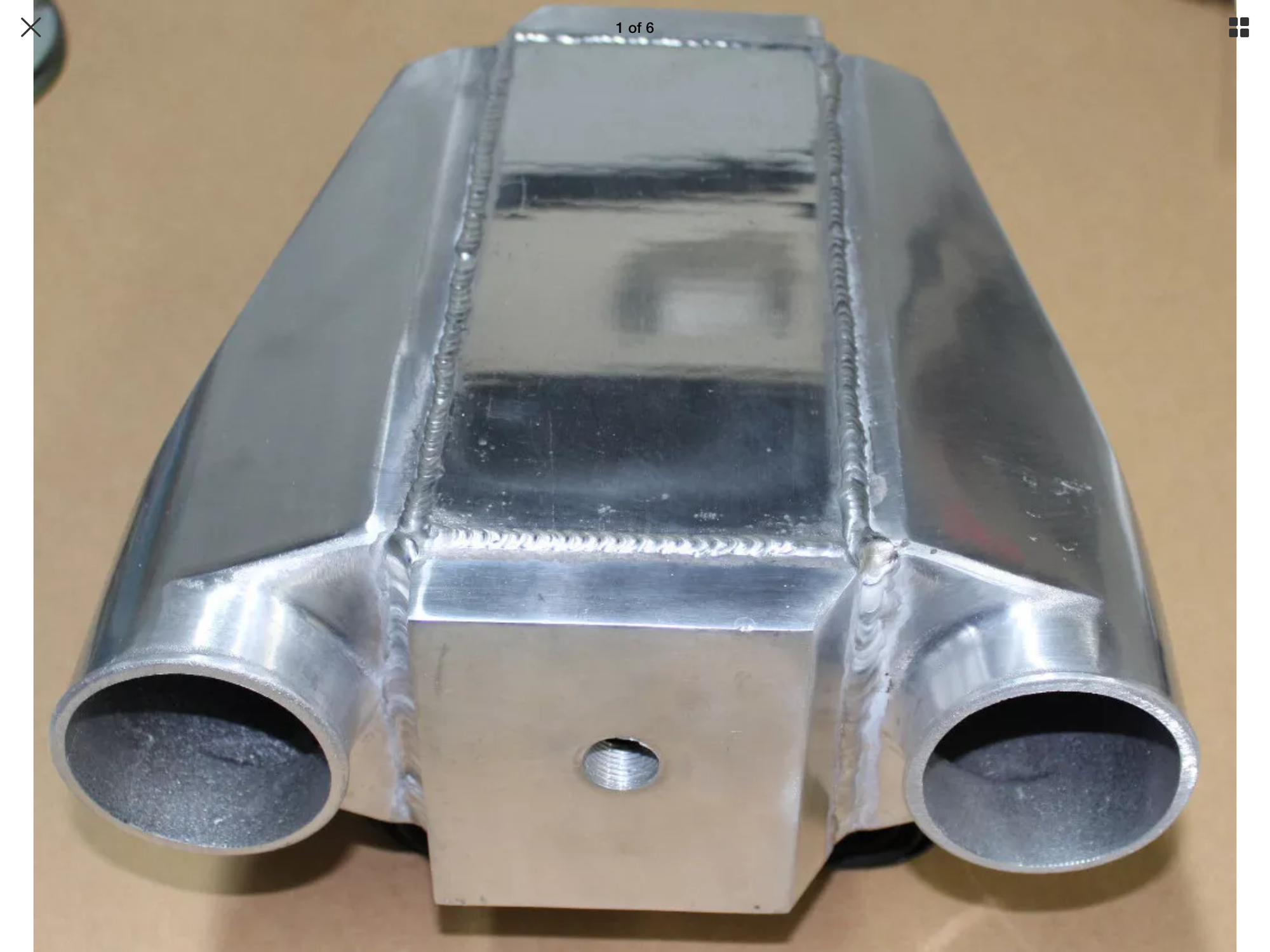

Maybe if I put my setup it will be easier to guide me on what pump to use .
This is the intercooler Overall Dimensions are12"x12"x4.5"
Core Size 10"x4.5"x4.5"
The air inlet and outlet are 3" diameter ends which will accept 3" hose couplers.
The water size connections are 1/2" NPT.
Old Mar 30, 2017 | 05:58 PM

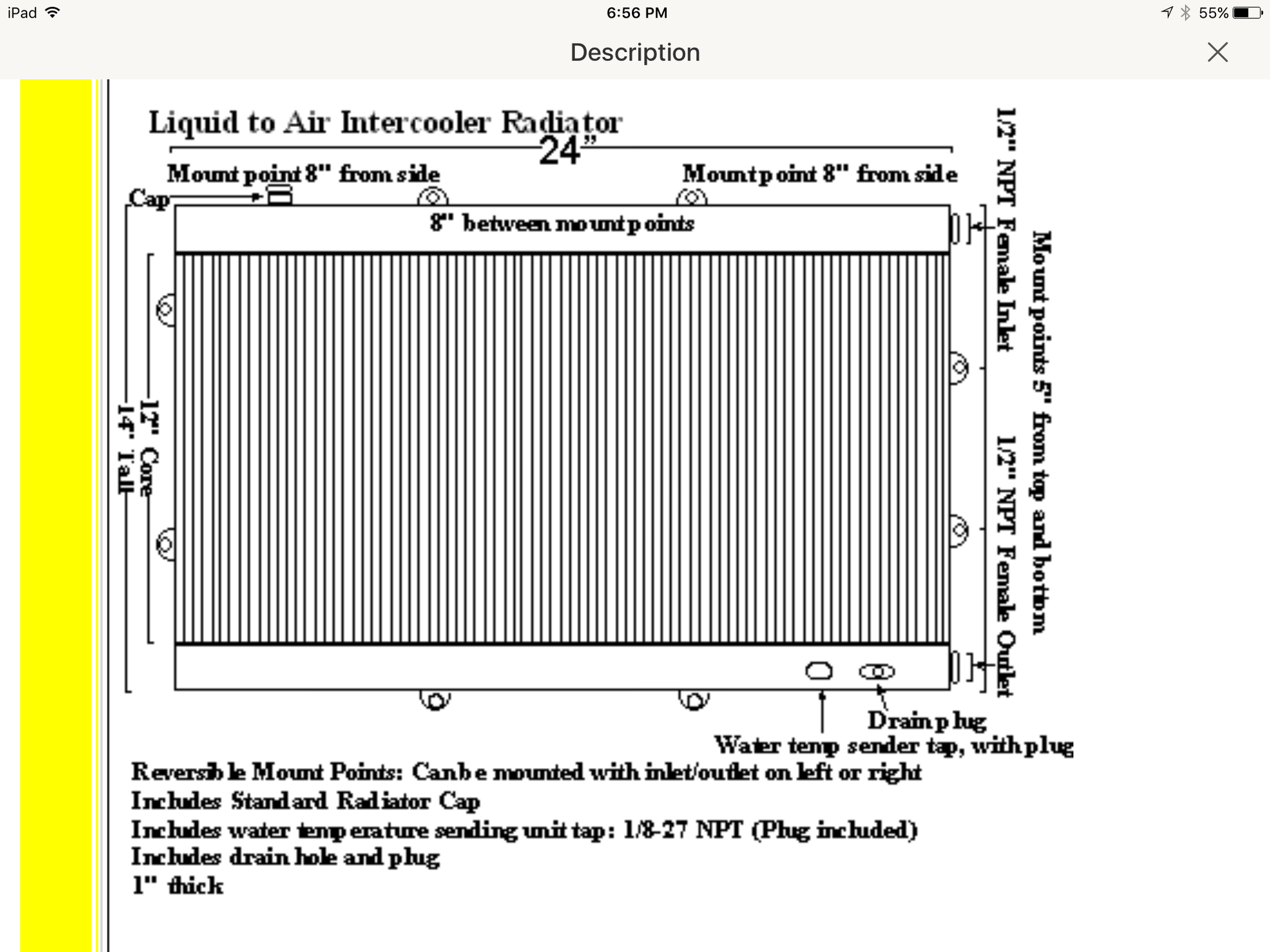

This is the radiator . That will go between the motor radiator and my condensor
Single t4 turbo 78/75

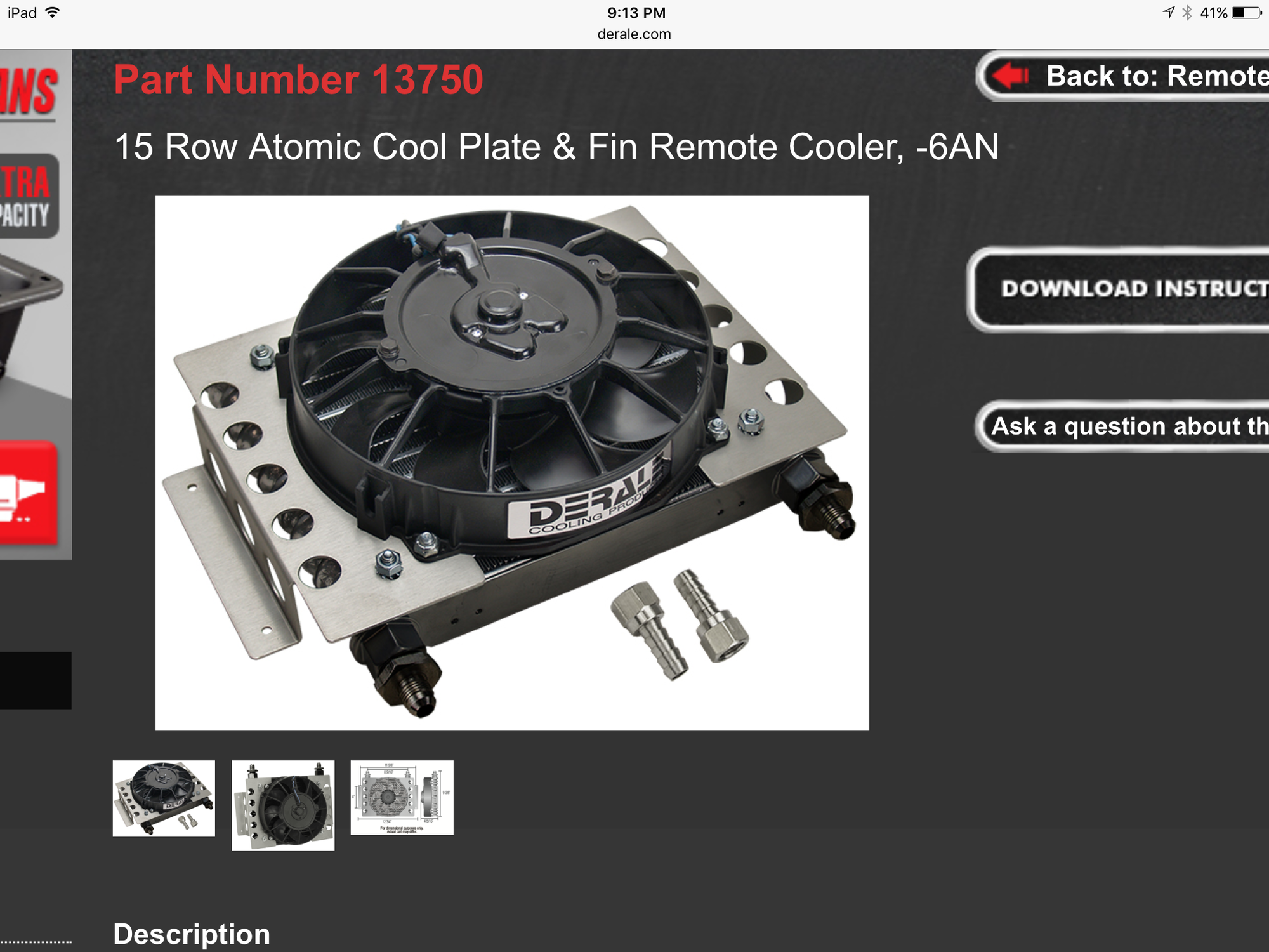

I wonder if this transmission cooler would work better to cool the water then the radiator I bought. What do you guys think.
