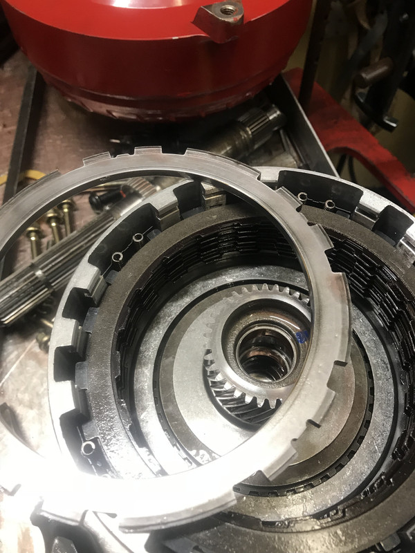

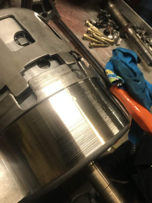

Well I got it apart. It’s probably the worst failure I’ve seen and just from a damn output shaft. It took out:
Input drum
reaction shaft
output shaft
front planet
sungear
and because I can’t seperate the reaction shaft from the sungear, I can’t use the beast sunshell.
The clutches and 2-4 band still look new there wasn’t much slippage.
Kfxguy is offline

Weird to lose an input AND output shaft at the same time, and everything in between. Do you plan on staying with the 60e? Are you opposed to a 400?
input shaft isnít broke. But the shaft breaking caused everything to hit and tore up the input shaft and drum. Along with all the other parts.
i drive this car alot, a 400 will never be in the plans. I may go 4l80 or if Iím going to spend that much money I might as well put a 6l80 in it. I think what Iím going to do is fix this trans for now as best I can, I donít have the money to do anything else at the moment. Iíll Pull the engine out next weekend and gap the rings. Fix head gaskets. New oil pan gasket. Build my bigger down pipe. Put it back together and see where Iím at. Iím going to definitely put the torque management back in because this happened right after I turned it off. This is subject to change too of course. Right now Iím pissed. And bummed about it. Iíll be thinking more clearly in a few days.
