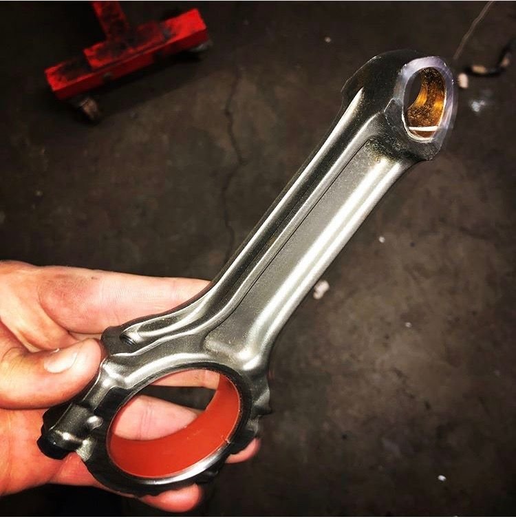

Thought this would pertain to the boosted guys, so I put it in this section. Put this video together to show that the stock GEN V LT1 crank and LT4 rods can work in a GEN 3/4 block.

Mostly because I'm a cheap **** and wanted to find an upgrade over Gen 4 LS parts on the cheap, the rods were $180 and I think are comparable to a Callies I beam and the crank is factory forged that I paid $75 plus shipping for, I have no Idea how strong the LT blocks are, but it doesn't matter since I'm using a Aluminum 5.3 block anyways,

havent watched yet but i heard the issue with LT4s is that red coating you see for the main bearings starts to peel at high power levels and wipes out the bearings and thats why they explode.. my buddys shop has a customer wanting 1000 from his 17 zl1 with a procharger.. they are replacing the rods for this reason..
Good to know.
Same, seen a bunch of LT4's all around that 1000 mark have bearing issues.

could you use just the rods on an LS crank?
Quote
I will have to do a mock up on a LS crank and see if the "strut" on the small end clears the counterweight.
