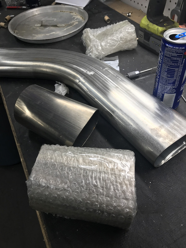

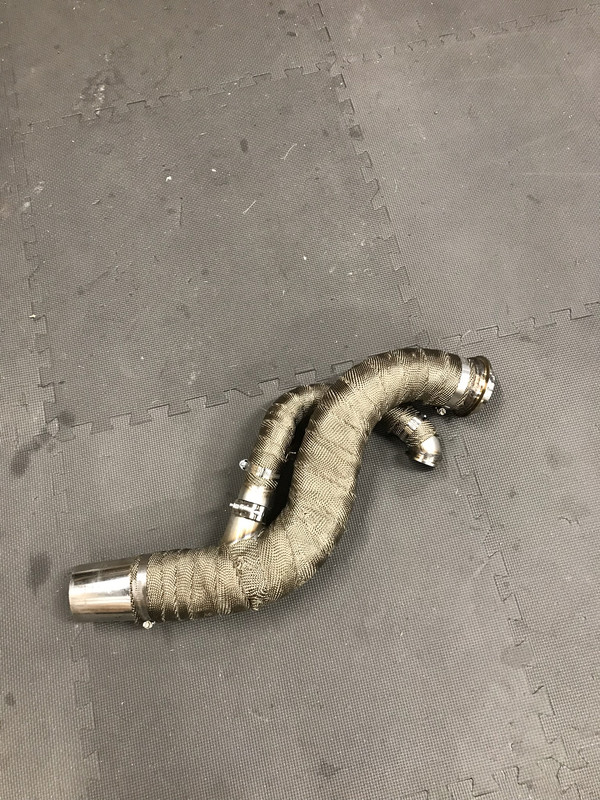

When I built my turbo setup I had to cheap out on some stuff. One thing was the downpipe. I used a 3” pipe that I had to “massage” with a BFH (big frigging hammer) and smashed it to about 2”. Oval pipe was out of budget at the time. But since then I’ve been collecting parts to do a better downpipe. I ended up getting Cx racing stainless 3.5” oval. Do you guys think I’ll pick up and power or spool faster after I build this downpipe? I need so motivation lol.
Heres what I have:
and here’s what I’m gonna use
Heres what I have:
If its really 2 inches you probably will pick up power. That said.....I love this video about NA.

Yea I watched that before. Was really surprised. I figured flow right out the turbo is pretty important and I did what I had to do at the time to get it to work. I always knew in the back of my mind that I’ll end up doing it right or better later on.
i mean is backpressure really needed when turbo? im running maybe 2 feet of exhaust out the fender lol im j.w. not bashing or anything not wondering actually more like asking...
Depends on multiple things like c.i., turbo size, pressure ratio, etc. Short distances of piping have less backpressure than a full over-axle exhaust. I had a 3 inch downpipe to a 3.5" over axle with a huge magnaflow muffler and picked up 30whp at the same boost when opening a cutout off the downpipe.
