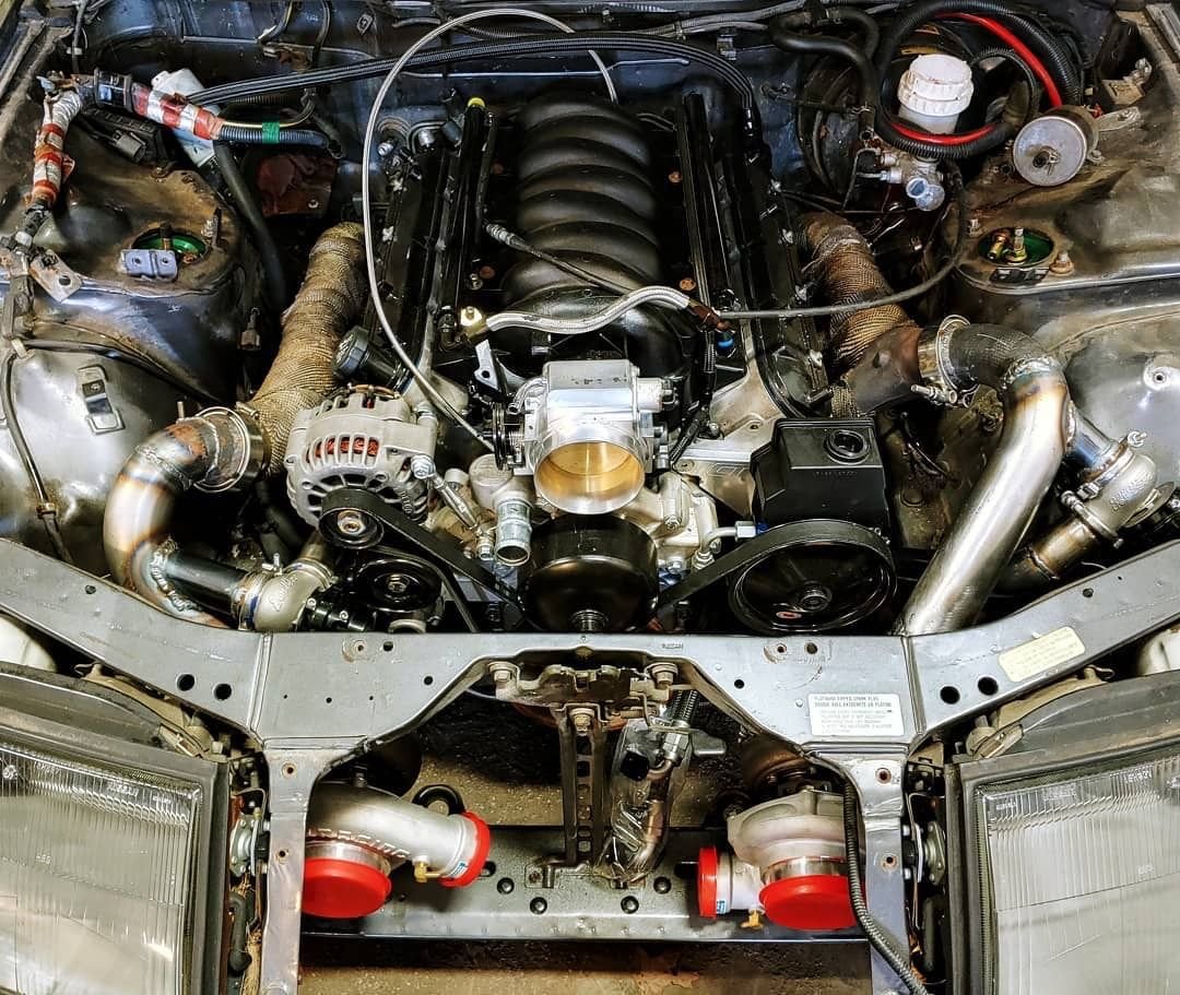

so here is my setup:
5.3 Lm7, 3200lb car
Twin Turbos:
http://vi.raptor.ebaydesc.com/ws/eBa...=0&cspheader=1
Dual 40mm precision wastegates
Truck manifolds 2.5” to 1.25’ long Pipe connected to each turbo(T4)
Full 2.5” piping with large SMICs (fits car)
full 3” exhaust with catback, also cutouts
deka 80lb injectors and aero fpr with 525pump
ls1 intake
92mm TB
706 heads
btr steel retainers and valve seats
btr dual titanium valve springs
btr harden push rods

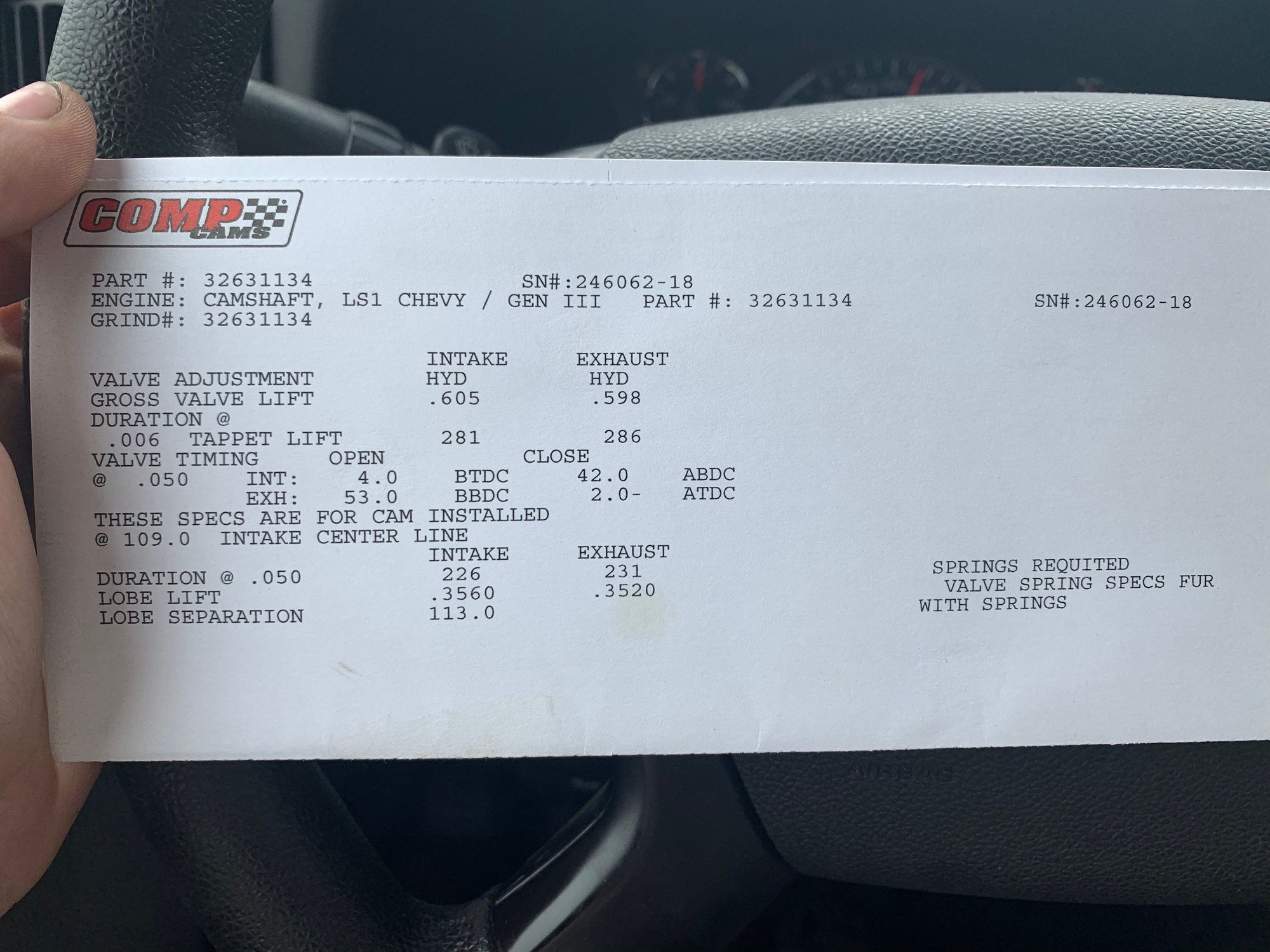

btr stage 2 cam (card in picture)
ls9 headgaskets
.030 bored block with factory resized Rods with ARP hardware
ARP head and main studs
Meth injection (not purchased yet)
3.37 rear end
5spd trans (300zx, car swap is installed on)

i mean he sounds like he has a bunch of rules because he knows what works for him. you have plenty enough goodies there to make 600+ wheel. i'm told those hellcat pumps arent much better than a normal 450.
1) if the turbos or fuel system are done at 2.5 bar there aint much to gain. that said i've never felt like the resolution between a 2.5 bar sensor, and a 3 bar sensor made them harder to tune. i just get the same 3 bar sensor from efi source so I dont have to dick around looking for data...he might be like that with his 2.5bar sensor?
2) rev it until it doesnt go faster or power falls off. I wanted to spin my 4.8 to 8 grand, the cam said "nah im done" around 6700
3) bring your AAA card in case something on the car breaks
bring good beers for if you car breaks a dyno record
bring some Malort in case it makes **** power and breaks your heart
just go into it with a good attitude and an open mind. I learn so much every time I go to the dyno, it's really a fun experience IMO

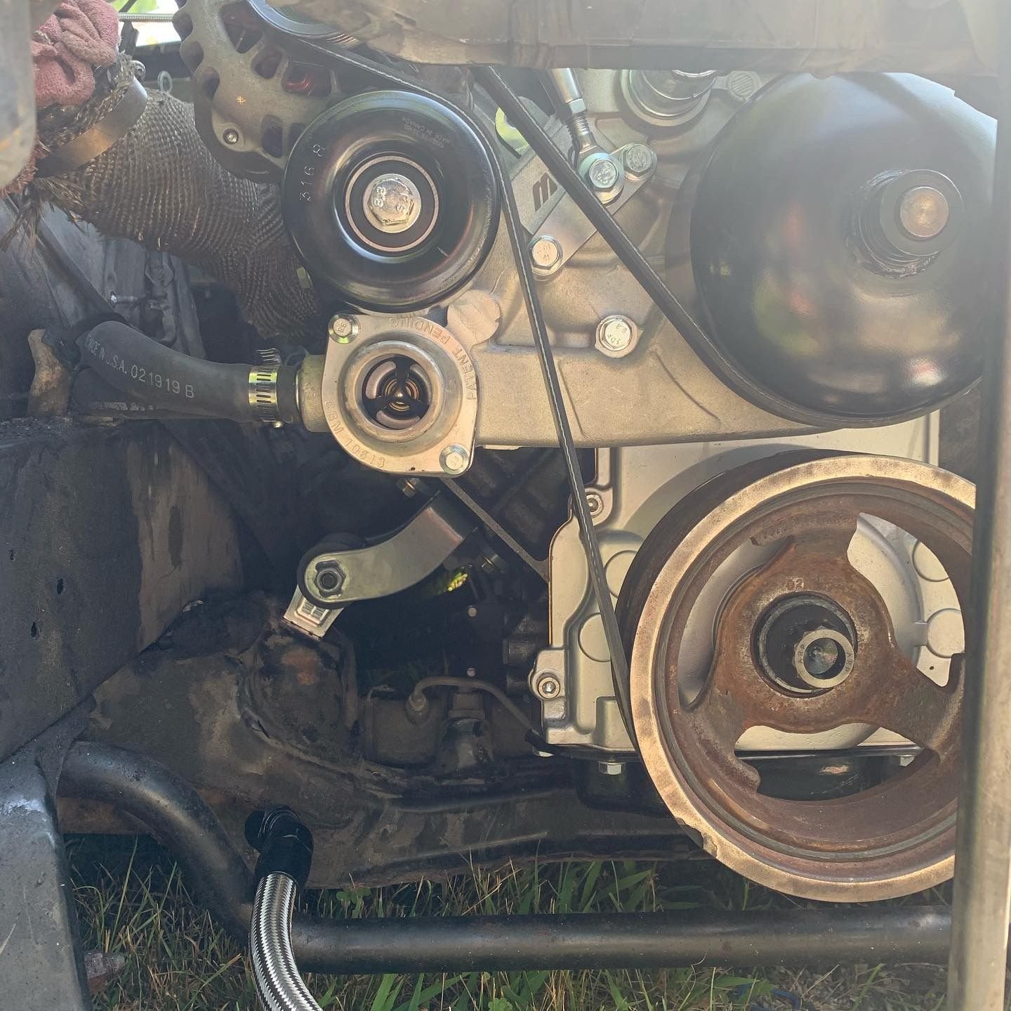

Do you guys think I’ll NEED flex pipes on my hot side?
have a buddy who think all the welds will crack and without flexpipes I’ll break other ****. He’s really being a hater but I did say I should’ve done flex pipe and the welder didn’t think was necessary.
the turbo is braced to frame.

If you have solid mounts, you likely won't have any issues. I put one flex joint in my crossover and haven't had any issues with it. I got it from Stainless Bros. Pretty quality piece.

These are my mounts. They pivot in center but stiff as hell.

yeah, should be good with that.
