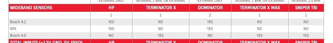

Again not bashing Holley in anyway. And yes... thank you for correcting me on the WB02.
Skimming their chart can be misleading. As one quickly looks down the WB02 section and it states NO in big letters and next to it for the HP it states YES in big letters.
So this is what my brain saw...
This is what the truth is...simply saying it doesn't have a 4.2 sensor... It has the new 4.9 which happens to be at the bottom. Again sorry for misleading anyone there. I was just briefly comparing differences. And i have to say thatls a poor chart design by Holley IMO. Most people wouldn't know the difference between sensor brands and wouldn't care. It either has one or it doesn't.
This is what the truth is...simply saying it doesn't have a 4.2 sensor... It has the new 4.9 which happens to be at the bottom. Again sorry for misleading anyone there. I was just briefly comparing differences. ANd ihave to say thats a poor chart design by Holley IMO. Most people wouldn't know the difference between sensor brands and wouldn't care. It either has one or it doesn't.
It's reassuring to know you haven't had any issues. That doesn't mean they don't exist. Simply look at any forum, they are filled with ign issues with the Holley (HP mainly). We even called the TECH dept back when the HP first came out and they tried to sell us bigger coils. Told us the factory coils didn't have enough power for boost. MANY on YB were told they needed IGN1 smart coils as well.
The harness is part of the Holley kit. It's "plug and play" So if it's a wiring issue (and the installer isn't completely incompetent ), its a Holley wiring issue... that may or may not be revised and corrected by now? I've known MANY people that have had an issue. Very capable people that have it wired correctly. I'm not saying it isn't a software or configuration issue... I'm saying there was no support form Holley to correct the issue and TONS of people had/have problems with no clear defined answer as to why.
The harness is plug n play but wiring the grounds, power, ignition and I/O are not, most of the issues we see are ground related. The more I/O's or more custom stuff the more complex it gets, not as simple as plugging in an engine harness. We have sold and tuned hundreds and hundreds of holley systems and have only had 2 bad ECU's (they had bad batch years ago) other than that we dont see the issues you see online. Its almost always install or tuner error, here are just a couple examples off the top of my head that came into the shop.
