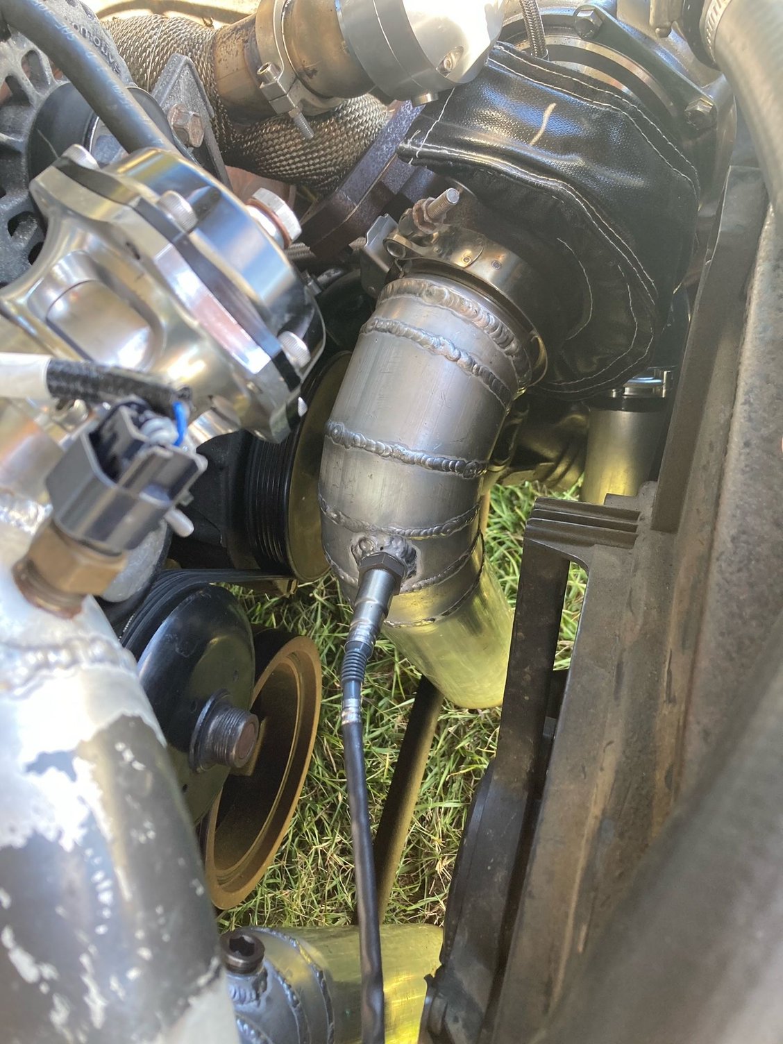

i guess maybe it was the heat, but my o2 failed in less than 1000 miles. brand new terminator x.
it seems to read correctly where it is, i think its about 12" from the end of the downpipe.

Do you need the wideband all the time or just for tuning? Just thinking if it’s for tuning you could run a longer section with the sensor built in. The. Once you are happy / it’s safe you can run the shorter pipes?
Looking at the chassis / car could you not make some AC cobra style down pipes that extend back? Might look pretty cool!
