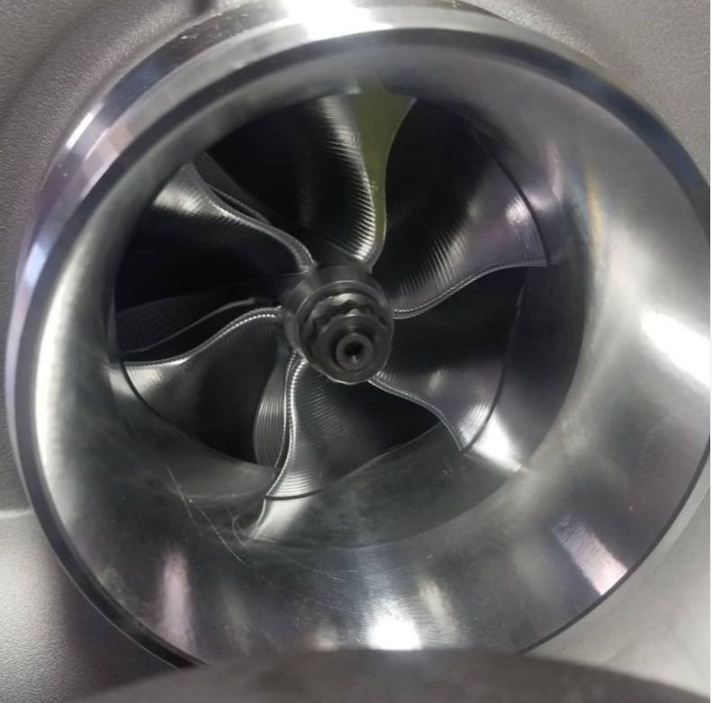

My son has the GEN2.5 Billet 78/75 on his car, but no race or even drive time yet.
His is 4" exhaust, 3" compressor outlet, 4" inlet, NOT V bands (except on exhaust, obviously), but regular slip fit compressor outlet, just like both of mine...

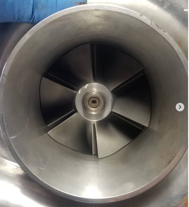

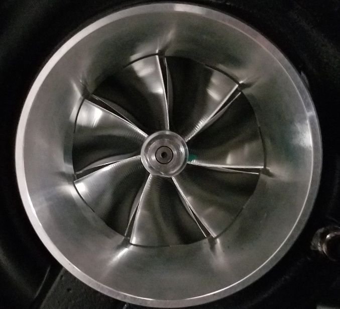

FWIW, Viren told my son that, ALL ELSE BEING EQUAL, the NEXTGEN should make 50 MORE HP than the CAST version, and...
The GEN2.5 should make 50 MORE HP than the NEXTGEN (aka GEN2)...

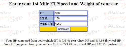

Here's what WALLACE RACING Calculator says for a 9.94 (Cast 78/75 turbo)

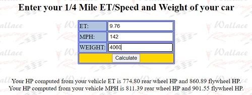

Now, I'm not putting a whole lot of faith into the accuracy of their calculator, as far as it's HP numbers, but there is indeed a 40-70hp gain/difference from CAST to BILLET NextGen, depending on what numbers you go by and use to compare...
And here's what WALLACE RACING Calculator says for a 9.76 (Gen 2 aka NextGen Billet 78/75 turbo)
CAST 78/75
NEXTGEN BILLET 78/75
GEN2.5 78/75
