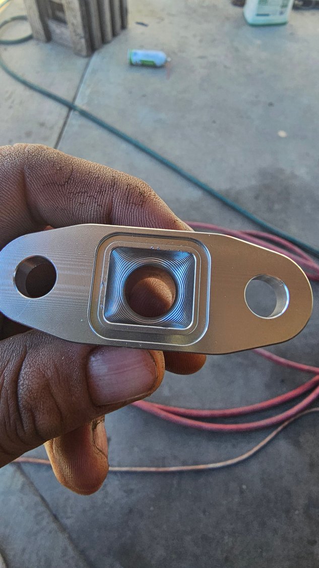

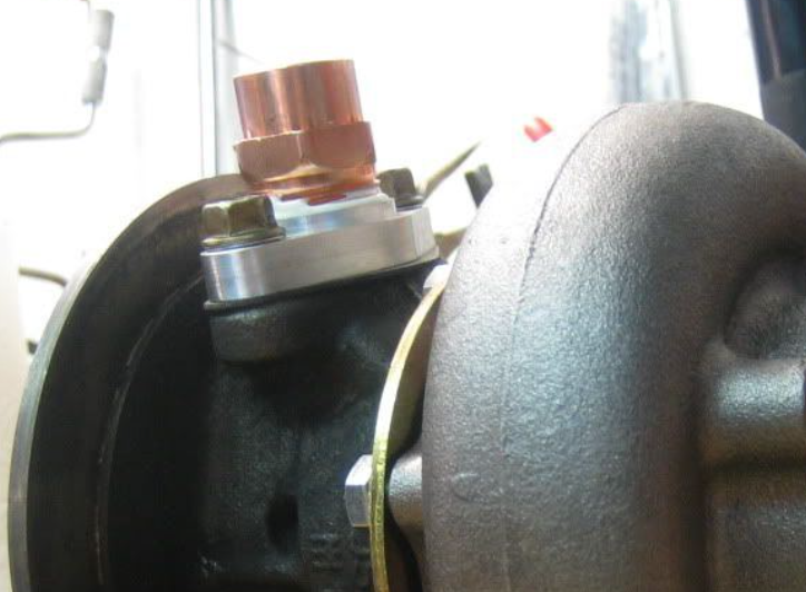

precision turbo suggested i use their high flow drains. there drains measure the same as my -10 15/32. But the base is machined with a taper.
do you think the high flow really makes a difference?

I can’t imagine that drain fitting you show will do much and I bet its not cheap. I’d buy one of the cheap 3/4 NPT threaded drains and go from there. Thin wall SS tubing or even ¾ copper tubing works well.

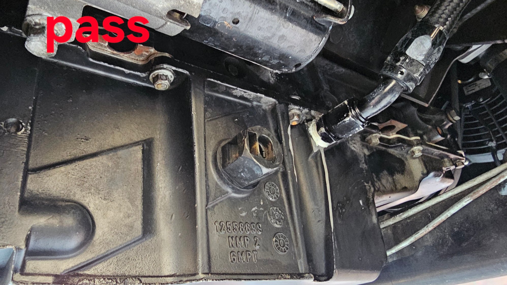

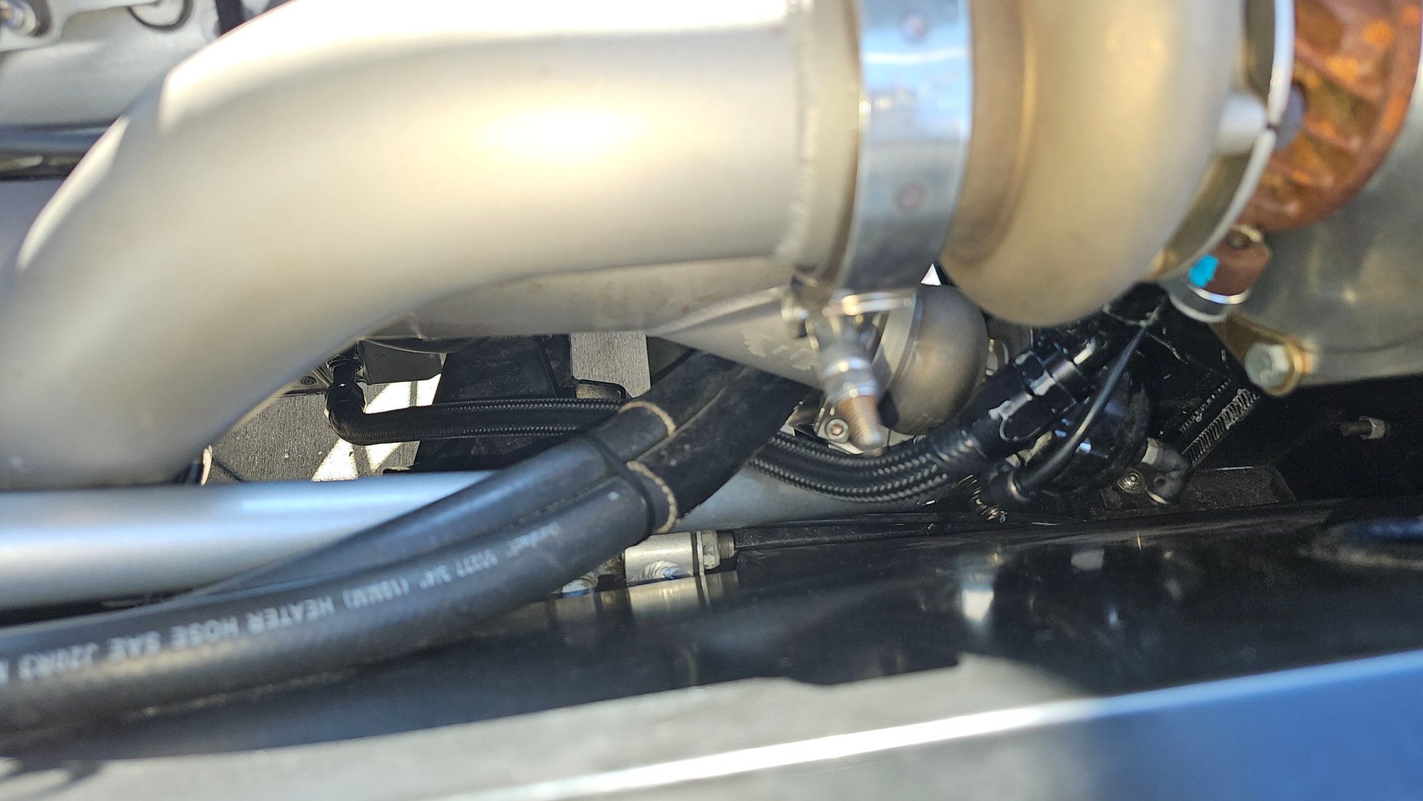

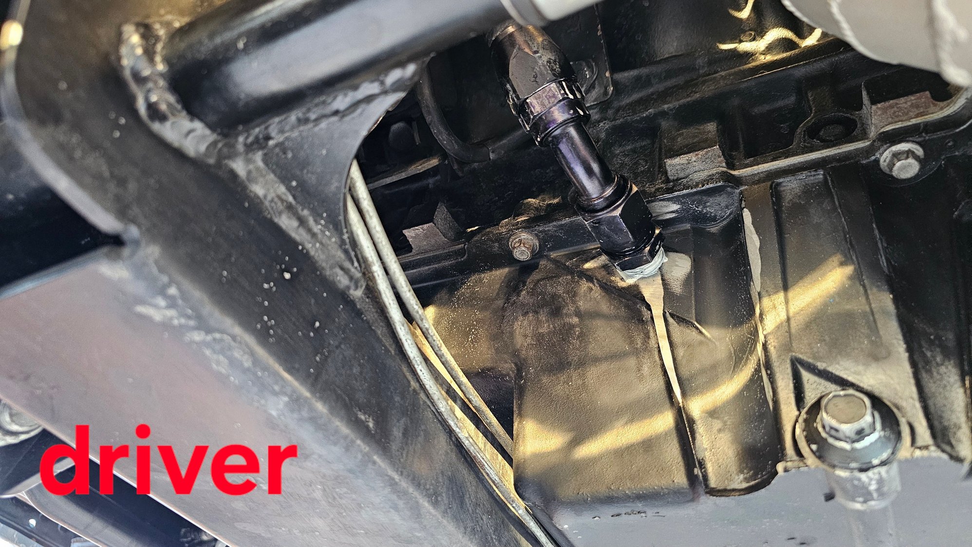

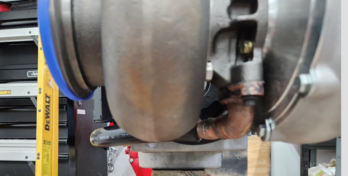

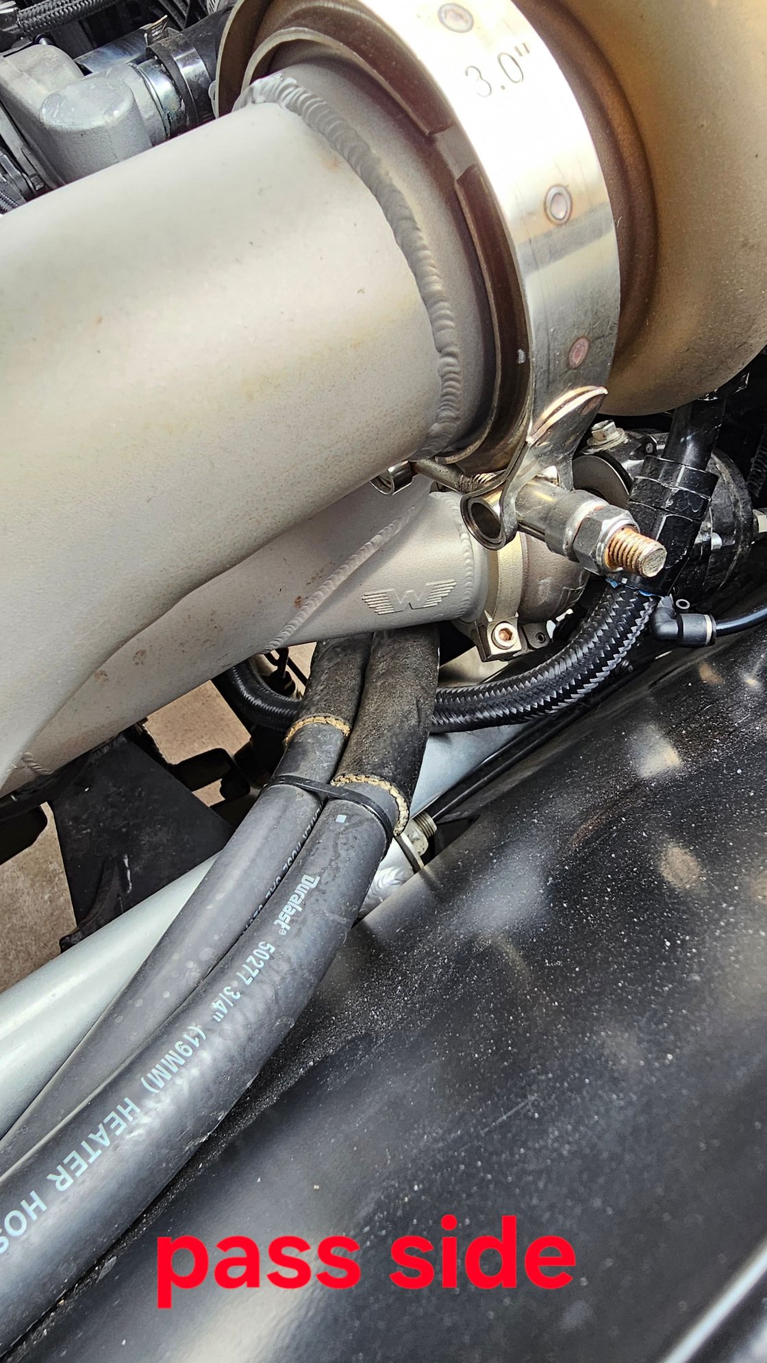

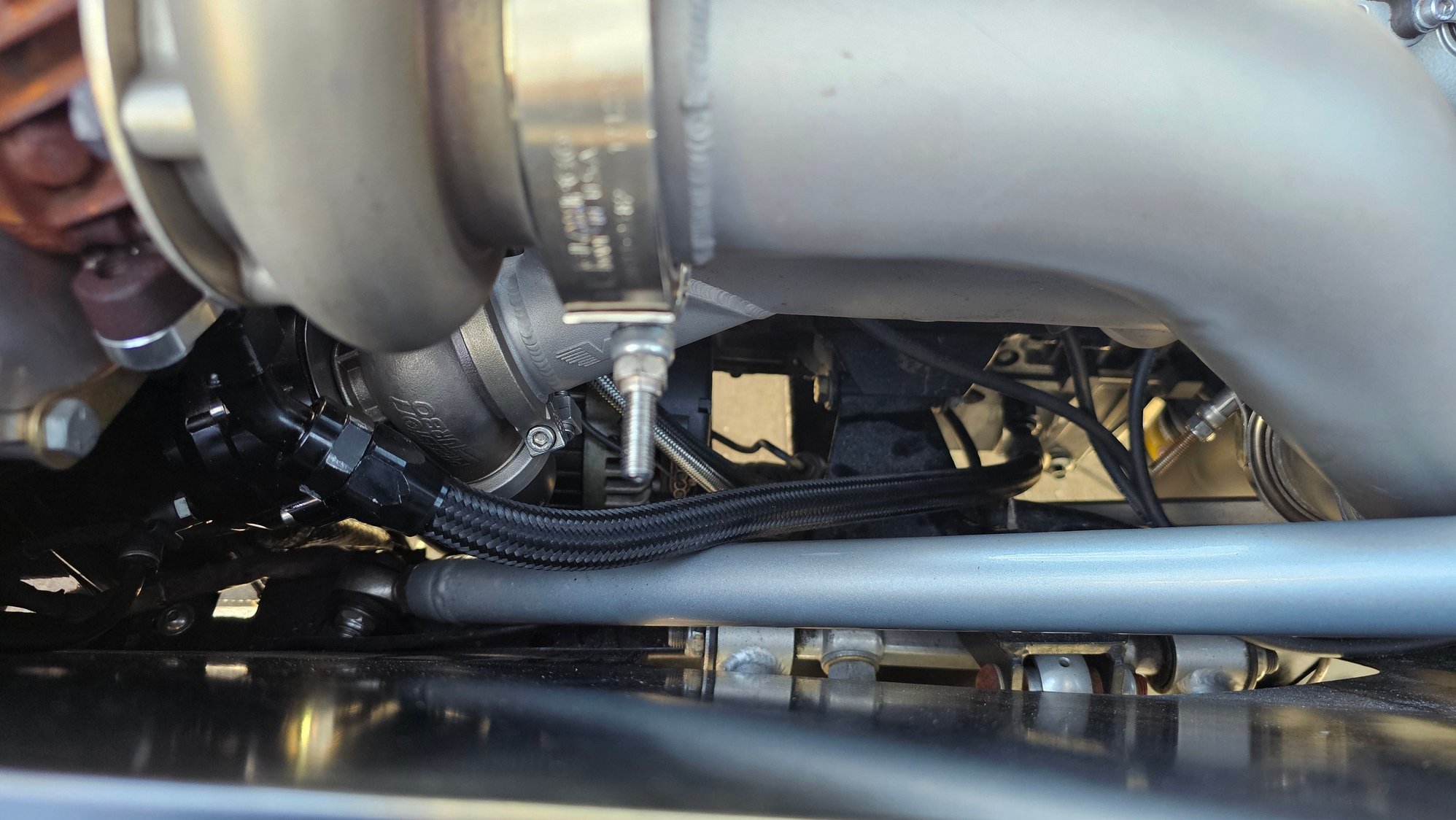

So I changed a couple things on the drain. I went with a high flow drain, now draining into the oil pan. And now the lines are more straight down compared to how it was. And I went with a .060 restrictor. And it still smokes pretty bad. Not as bad as before. But still pretty bad.
I can't believe that the hoses are not vertical enough. that its causing a back up.
Do you think I might have to much oil pressure?
im around 65-70 oil pressure. Precision turbo said that the turbo will take all the pressure that I can give it. But I think there has to be a limit on how much pressure the turbo can handle.
Here's some pics of the set up. Not the best pics. But my engine bay is pretty tight.

As for the drain on the oil pan. Do you see a issue where I put the drain? Should it have been away from the sump or something else?

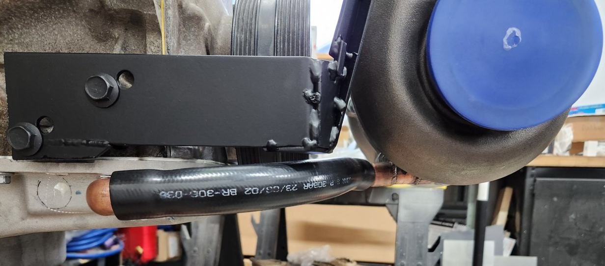

This is one of the worst examples you can have location wise and it still worked well with no issues. Even with an immediate 90 and almost horizontal drain (both huge no no's) 3/4 copper pipe made this setup work. Large diameter is your friend.
Type M (thin wall) copper tubing and fittings are .875 ID. Type L is .785 ID
one of mine
