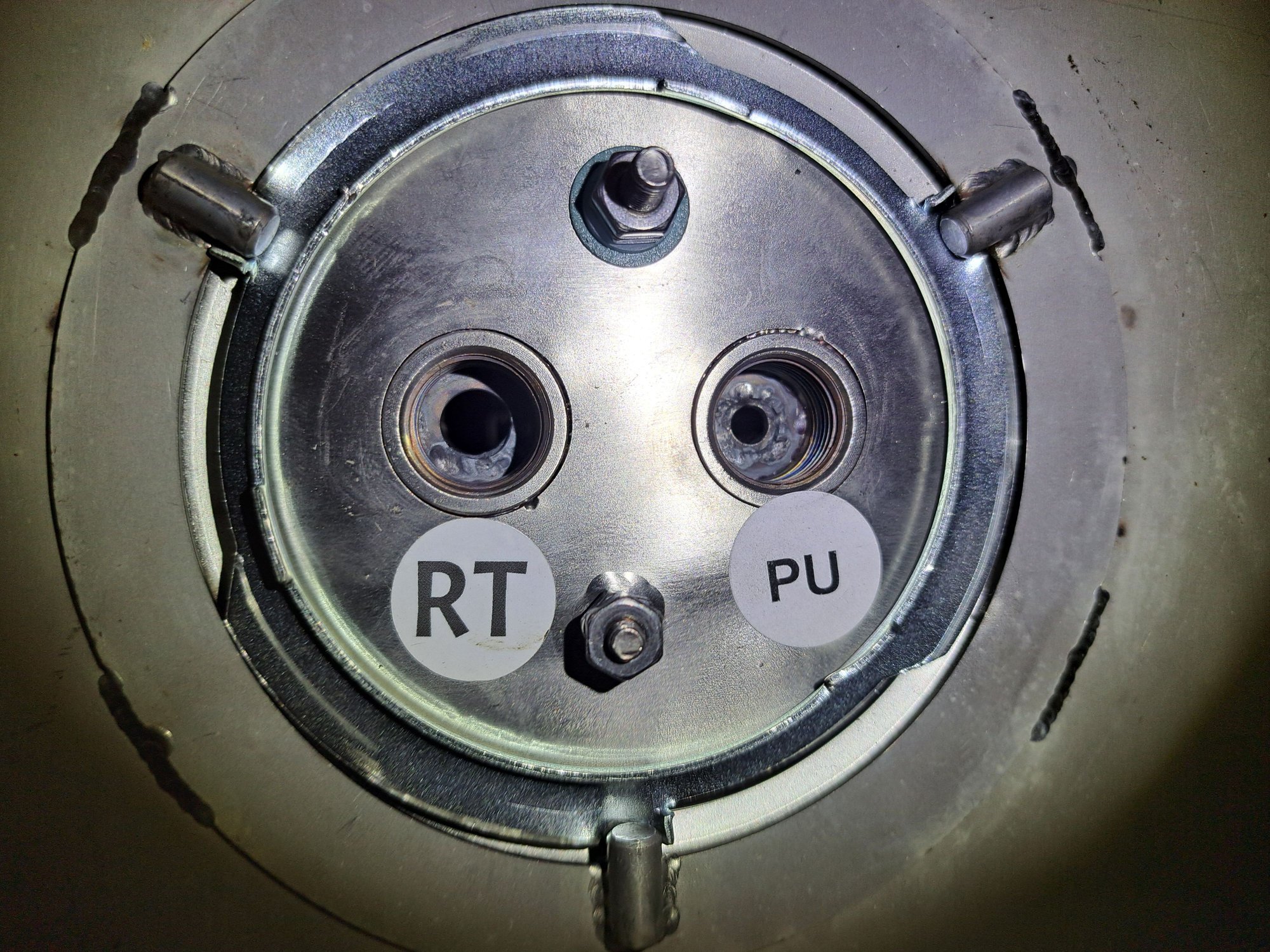

Question! I purchased a stainless fuel tank for my 1st gen camaro. It's nice, gives me extra clearance, etc. It comes with a 450lph pump, they say it'll handle up to 1100hp na,fi. But I pull the plastic plugs to inspect I see that the return port i.d. is 5/16 and the outlet port is 3/16 i.d. I checked both with drill bits. I asked the the company, who built the tank,
and they said it shouldn't be a problem since that's the size of the outlet nipple of the actual pump itself. Does it not matter since it's pushing the fuel and that 3/16 it's pushing through might be a couple inches?
