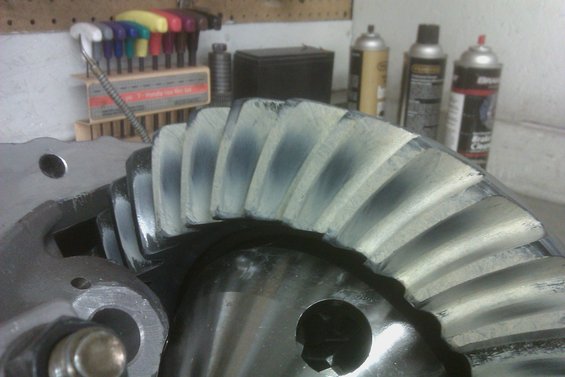

Setting up gears can drive you up the wall. Most think that becasue everything is brand new and set up right that there should be no noise. Thats not always the case. I would love to see how these rear ends are mass produced, and setup.
I bought a pinion depth tool, built a case spreader, and built 2 10 bolts side by side. Same ratio and brand of gear, same pattern, by the book. One made noise one did not. It had to be coming from differences in the housing. The one making noise is in my car, the other is in my buddies....
This is some of my work, Motive 3.89 in a 9 inch that made all kinds on noise
If you can find something wrong with it by all means let me know.

Coast or drive noise? light or heavy load? What's your backlash and preload? TTR?
You can have a pattern that's too perfect. Then the gear teeth are literally slapping together, like clapping hands instead of laying together smoothly.
That is a beautiful footprint, though. I'd take out a little backlash first (easiest) and see what it did for the noise.
Edit: being a 9" I'd play around with the pinion shims first. Go up or down a few thousands. 5 bolts (6?) and the pinion yanks right out. Love it!
