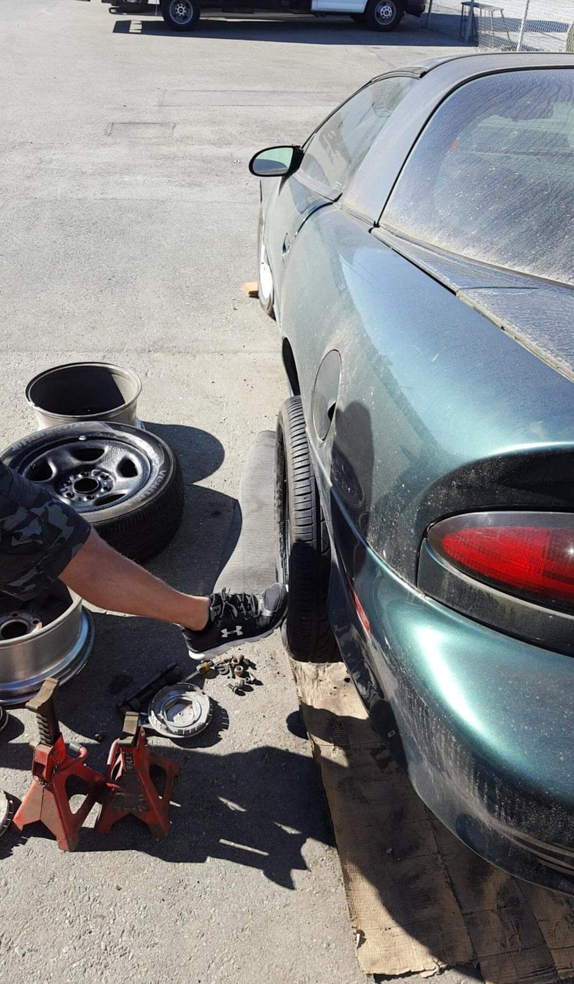

Cool. Any pics of the car itself?
I IM'd the OP and woke him up! Thanks for checking back in.
AnotherWs6 is offline   Reply With Quote
Old 02-01-2017, 12:05 AM   #65
Soul Crusher's Avatar
Join Date: Sep 2007
Location: Surrey, BC
Posts: 230
Those are the best I've got of the rear end in the car. It belongs to a friend of mine in Canada. I can ask him to take some more pictures of there's anything you need to see. We had to build our own torq arm too.

Would be nice to see some shots of it installed underneath the car. How much work was involved in it ?

This is actually my car, I can try and get some shots of it installed this weekend. It wasn't that bad labour wise, we actually put more effort into taking the 8.5 out of the truck in the scrap yard. As far as I recall we spent 3 nights working on it to get it ready to go under the car... so like 6 hours of work and 6 hours of drinking beer
