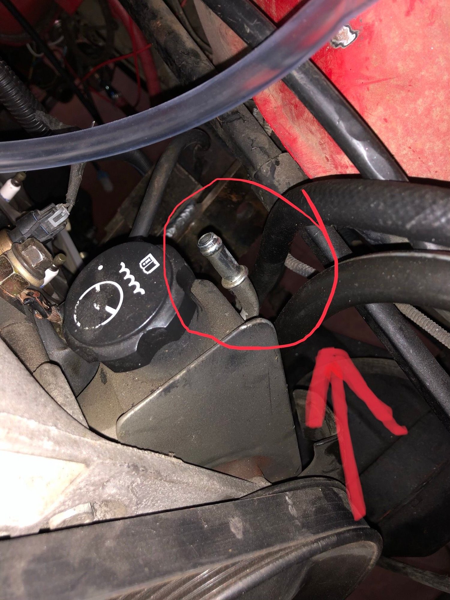

Hey guys,
I’m not sure where this should be posted. Does anyone know what this fitting is for? Motor is an ‘05 5.3.
Thanks!

It's a return fitting. What's this in, or what did it come out of? 99% it would of been in a hydro boost set up, if you're not using it then just get a cap for it.

Its going into a Jeep Yj and it is out of an ‘05 Avalanche. And ok thanks, i will plug it.
