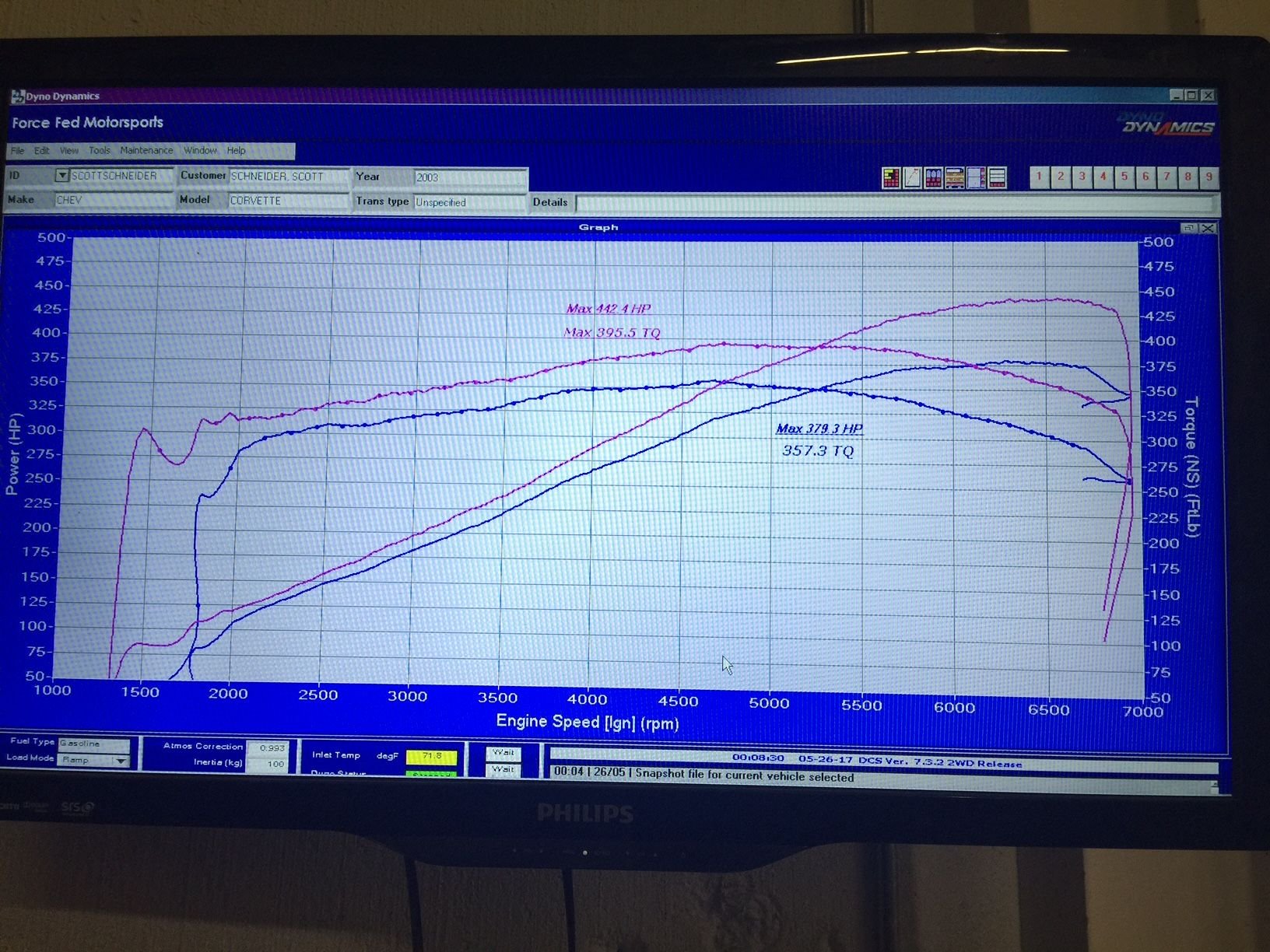

I'd like to see that TPIS add more to my ported FASt 102. Car is an 03C5Z with the stock cam and heads. I'm willing to bet most of the idle problems are from the TB itself.
442/395
