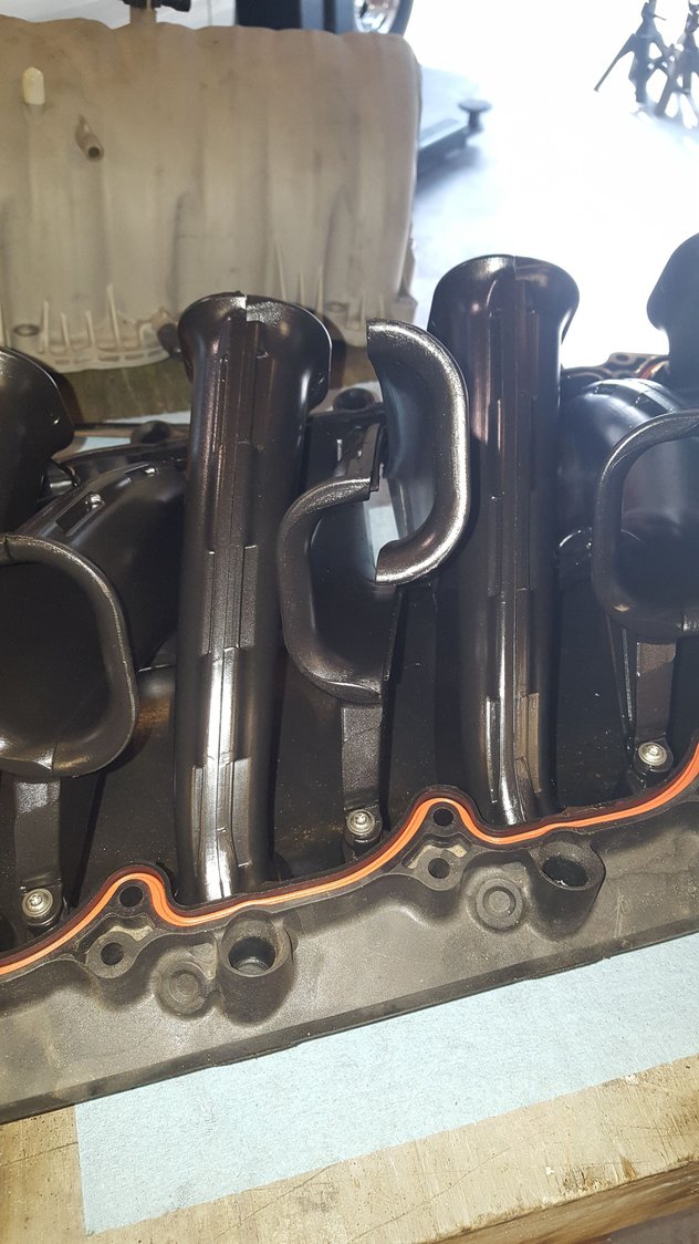

Anybody have a fix for this. I contacted fast to see what they have to say. This is less than a year old with only a few passes on it.

O ya it broke on it's own. I tore motor down to fix another issue and found the runner blocking the intake port.

Did you buy It new. If so fast will make good on it. Thats a defect. They wont want to see that on here. lol.
How did you even figure out to remove the upper and find that? Or did you just come across it while doing something else?
Old Apr 1, 2018 | 09:08 AM
garygnu's Avatar
Joined: Feb 2009
Posts: 5,445
try to glue it make together with some super glue .
Old Apr 1, 2018 | 09:35 AM
Fishmasterdan's Avatar
Joined: Oct 2015
Posts: 310
Likes: 24
Was replacing a head gasket. Took the intake off and you could hear it rattling around.

You can weld it back together with a plastic welder. Due to this company not being a sponsor i can not mention their name but if you have one close by to you it cost about $ 70 dollars to purchase it and it comes with plastic rods to use as weld material. It works a whole lot better than just using a soldering iron.

Get you some 3m 08223 univeral adhesive. They may make different size tubes but this **** is great. It will easily hold your runners together.

They sell the runners dont they? Buy one and replace it.
I tried to buy some shorter ones before but it never got a response from them.
I ended up epoxying it back together to get by, until I can get it resolved from FAST.

Got ahold of fast/comp cams. My intake is 16 months old. 4 months past warranty.
They won't sell me a single runner. Had to buy all new runners. But at least they sold them to me for 1/2 price.
I am not mad at fast but not happy with there crappy runner design. I ordered a new accufab super Vic kit.

Well new parts came in. They sent a whole new one. I was skeptical at first how this would work out. Fast/ Comp cams has exceeded what I expected...

Originally Posted by onebadbowtie86
A whole new intake??
Yes. Gaskets bolts ECT. Brand new like you get when you order one.
