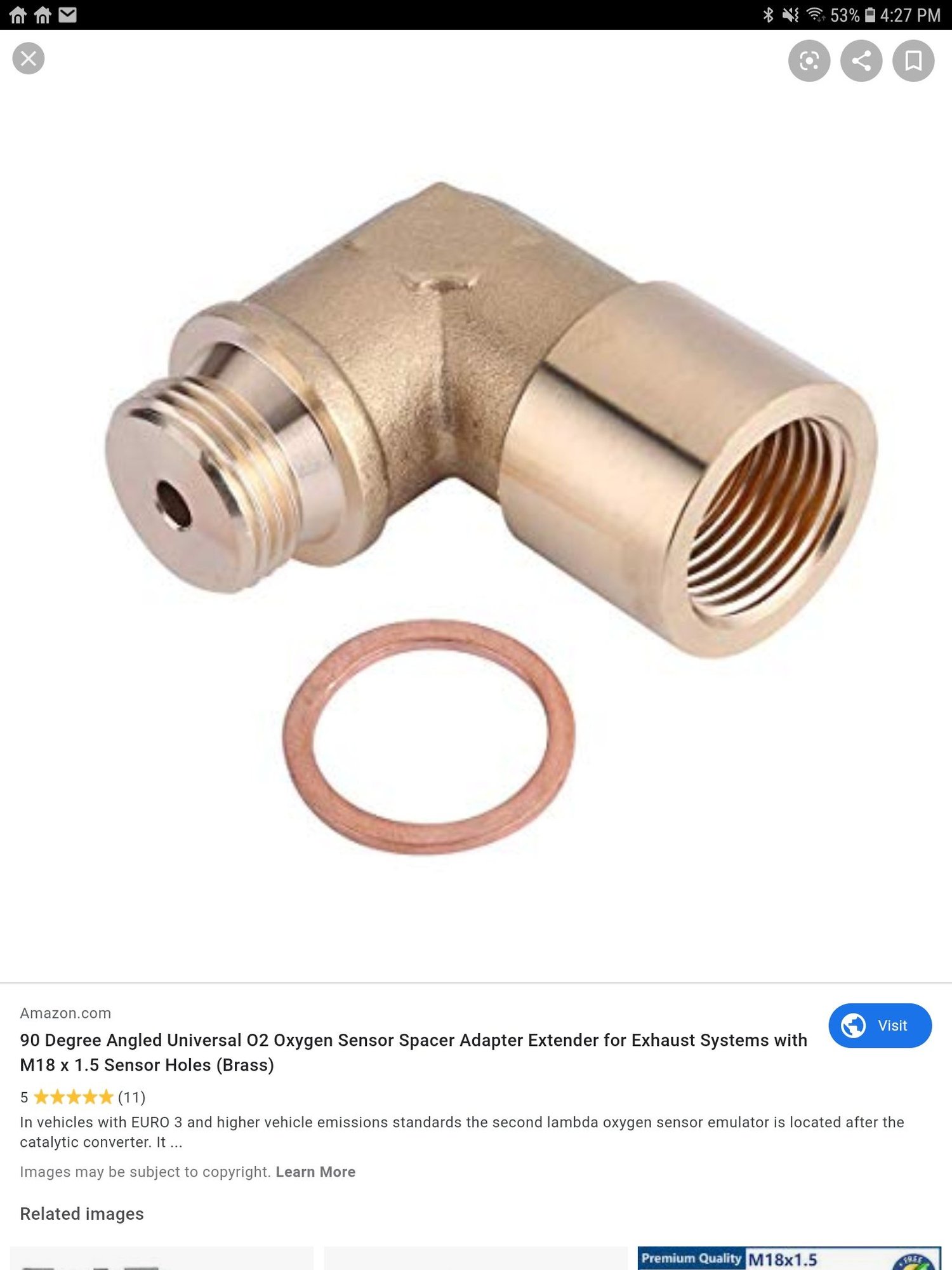

I've used these in the past when clearance was an issue. The only thing is you need to mod them.
You have to drill them out a lot bigger so your primary O2 works properly.

Originally Posted by Dragls
I wouldn't use that for a sensor that I actually wanted to read correctly. That's basically the same thing as an spark plug anti fouler people use to keep the 420/430 codes from coming on. The reason the codes don't come on is because the 02 sensor isn't really seeing the exhaust gasses.
