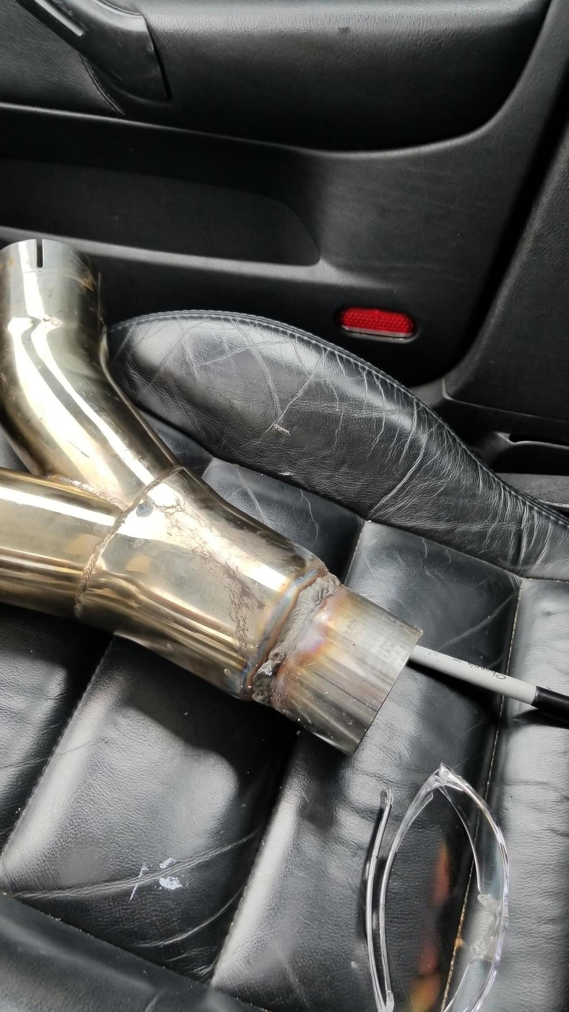

So I'm wondering about the Y-pipe, right now I have a TSP Y which I cut and welded to stay 3" instead of 2.75", shown below.
So I'm trying to decide what to do, do I cut the TSP Y again and weld in a 3.5" piece? Or should I go with the Flowmaster merge? Or is there another option?
It would certainly be easiest to cut and weld the TSP Y, then upsize my cutout to 3.5" and neck back down to 3" for the cat-back, also this allows me to keep it all stainless steel which I like. Would a Magnaflow merge with a 4" cutout be worth a significant amount more power? Are there other merges out there made of stainless steel that would do the job well?

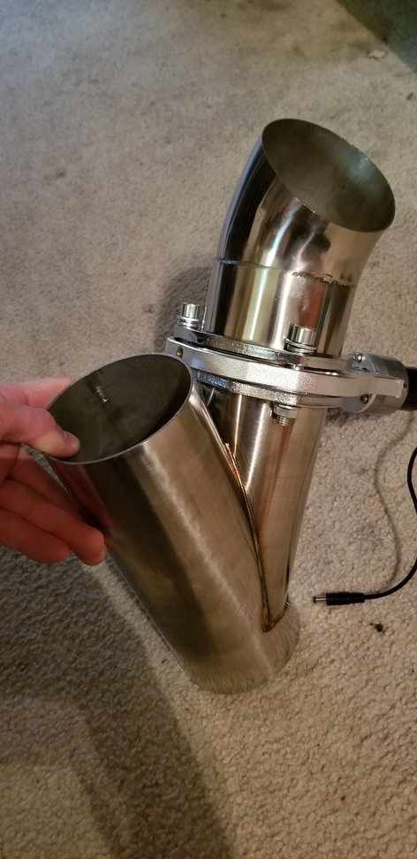

Old Jan 14, 2020 | 05:13 PM
98CayenneT/A's Avatar
Joined: Nov 2013
Posts: 3,913
Likes: 366
From: White Bear, Mn
Here is my 4in. cutout that came with a turn down. It's a Evil Energy and has been working just fine.
