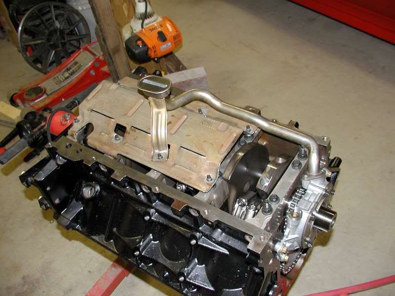

I didn't realize it until last night, but the used f-body oil pan I bought didn't have a windage tray. I could just to buy one if it matters, but my question is, does it? The truck pan has some oil drainage vents that the f-body pan doesn't have, but is that a negative? If anything, won't it help with oil drain back? Are there any reasons not to use the cut down truck windage tray? This is my truck tray cut down to work with the f-body pan:

i have both and after comparing them they look near identical to me other than length,as long as its not making contact with the crank or any other parts it looks like it would be fine to me,extra drains shouldnt hurt anything either

I have done this before and it works fine.
I did the exact same thing here. I don't see any issue why this would be problem either. The front of that pan is like an inch and a half from the crank and you aren't going to get any foaming from this being this close in my opinion. I'm just gonna run it like this and see what happens.
