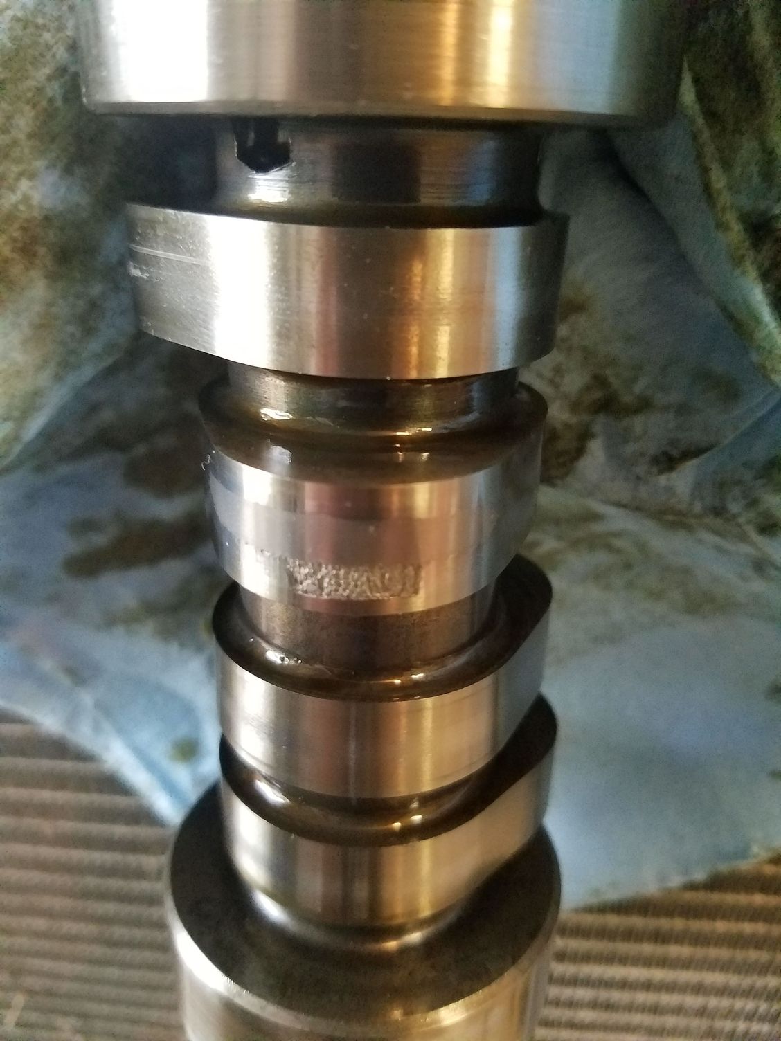

Basically what I ended up doing
Was a new ls6 cam that went in....... not something cheap.
Thats an odd looking wear spot. It does indeed look like the cam just lost a bit of metal. Bad casting i guess?
Thats very similar to the fail mode when a cam does not break in right, But you can see the roller mark isn't right on top of it, looks like the surface hardening spalled off.
It made a little intermittent noise that started to get worse. Then I keep getting a flashing engine light and the tick was getting kinda loud. Nothing crazy but it started getting much worse then when it first started
Im going to have do disagree, the lifter that rode the lobe with damage was in perfect shape, or looked fine. The lifter pictured is 1 lobe back. It looks bad, but the lobe it rode had minimal marks. I honestly think the cam as already mentioned shed some metal for whatever reason.
That metal ended up in the next inline lifter which caused the roller to fail or atleast start to fail.
