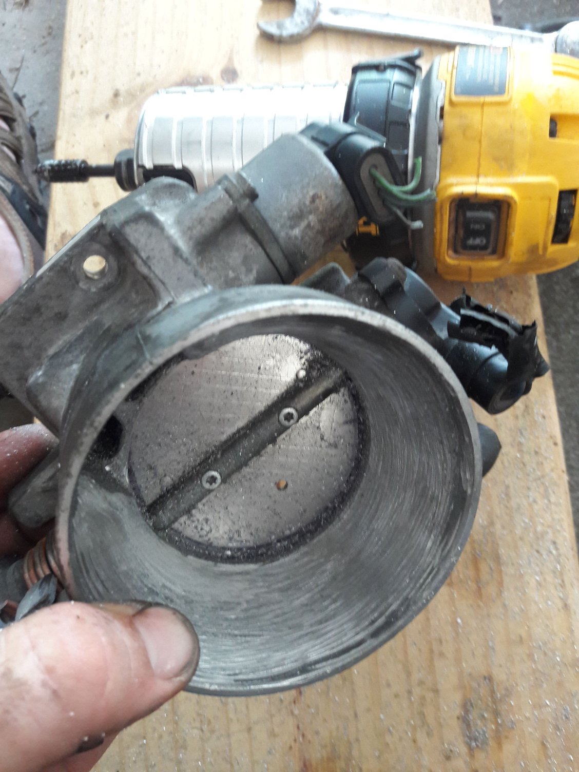

ok so today i tried my hand at porting. i opted to practice on the TB first to get some practice. I found that my dewalt router actually works really good..if they made a flex hose extension that fit it would be the ****. i have a set of porting burs otw from amazon. so once i get those we will see if i have what it takes
Old Jul 13, 2017 | 01:54 PM
Rick5.3's Avatar
Joined: Jul 2017
Posts: 57
i decided to go.for.broke..fortune favors the bold
