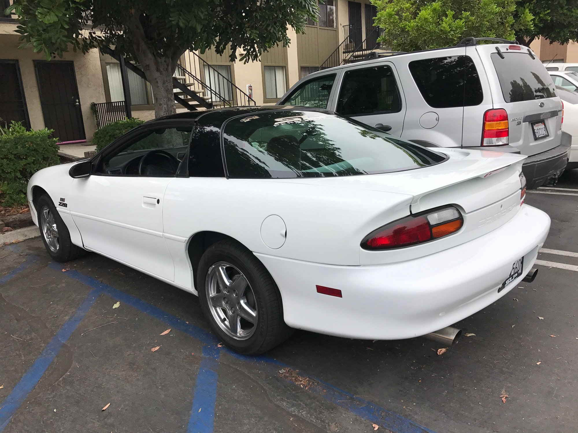

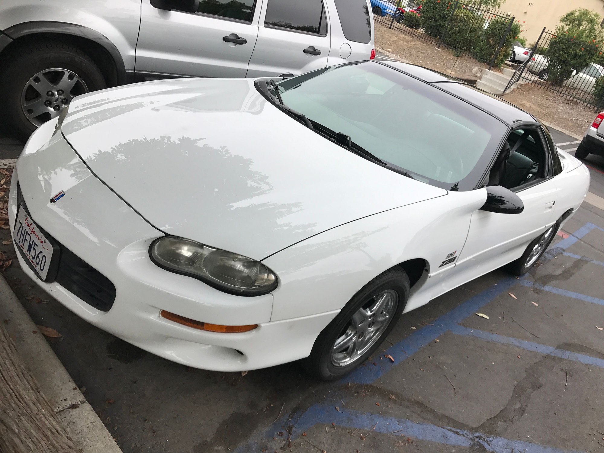

My baby is finally back home, running perfectly, being broken in. All I need is a good tune I'll be fine...until the next set of upgrades.
I want to thank everyone for your help, specially to Mike and the tech support at the WS6STORE for the help and best customer service. They helped me from beginning to end.
No wonder they are loved in the LS community. My baby
