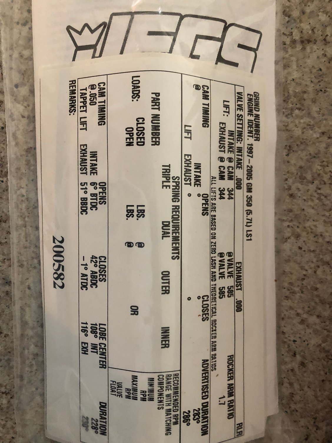

Alright so I just re-watched one of Happel’s videos on installing the cam-he has a link to the “sloppy stage II” cam and it’s an Elgin E1839P: rpm range 2000-4800, .575(intake and exhaust valve lift), 220/224 intake/exhaust duration on 112 lsa.
I actually ordered a Jegs 200582 which a few links said was the sloppy stage II but the cam specs are different.
jegs 200582:
.585/.582 lift, rpm 2500-6500, 228/230 duration on a 112 lsa.
another search on sloppy mechanics wiki links the Elgin e1840P which has .585/.585 lift, 112 lsa, 283/286 duration. The wiki page links to the jegs 200582,
mom guessing either choice are pretty similar or he used a couple slightly different cams for different builds?

I've always understood that the stage 2 is 228/230 .585" lift with 112lsa.
Jegs 200582 is all of this. From the website:
"1997-2004 GM LS Series (Gen III)
Lift: 0.585"/0.585"
Duration @ 0.050": 228°/230°
Advertised Duration: 283°/286°
Lobe Separation: 112°
RPM Range: 2,500-6,500 RPM"
With that, you can see that you listed the advertised duration for the Elgin cam. From Elgin's website http://www.elginind.com/ and
http://catalog.elginind.com/elgin/technicallookupPage# , they are the same specs.

Hardtop Brian is right that jegs cam is the one matt recommends. those are the correct specs. matt has one in his wifes truck with a turbo if i remember correctly

I just finished installing the Elgin E1839P. The 2000-4800 rpm range is an obvious print error. Probably discouraged a few people that did not know any better.

Well jegs came through! Lol
like I said in the OP I’m pretty sure they had it priced incorrectly since the eBay ad I bought it from didn’t have the cam specs-just the 200582 and jegs had the same cam in another ad with full specs listed. fast shipping. Woo hoo lol
