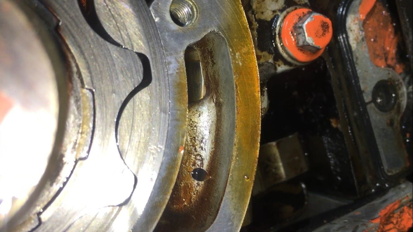

Now, I think I have some good news as to what my issue is, but maybe I am just seeing things that aren't actually there.
I tore the front timing cover off and got to the oil pump today. I couldn't look straight at the relief valve but I could get pictures and it looks to me like the valve is open.
Maybe someone who knows exactly what to look for could let me know if I'm right, or break the bad news that the valve is indeed closed.

Default G Rotor Oil Pump Tech
Hi Russ, your pictures are great.
The material on the drain plug could be from the Oil Pump Rotors.
A Rotor "side view" picture could tell BOTH inner/outer condition.
The "G" rotor pump MUST ALWAYS be INSPECTED before reuse with NO wear observed.
The smallest amount of wear on the rotors (sides) has a GREAT effect on pump output.
SO I ASK, What method did you use to install/align the pump onto the crankshaft center ?
Your report could be of great help to LS-1 tech members.
Lance
