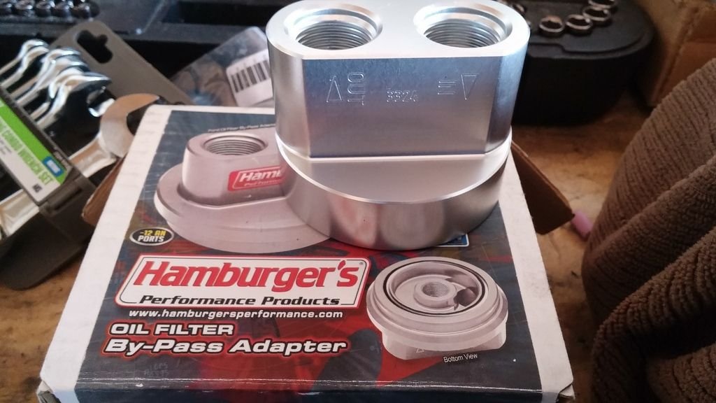

This is what I used for my remote set up.
I used the "CV lightweight Remote oil filter mount - (CV746)" to mount the filter.
