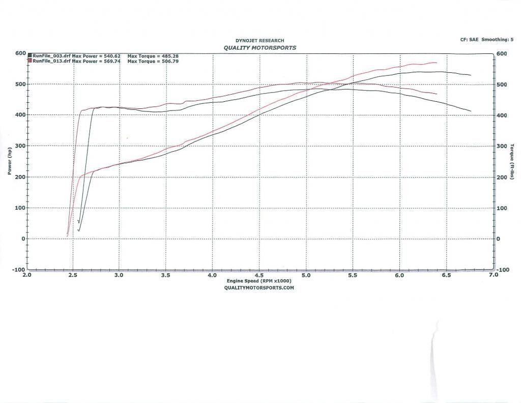

Ive got PRC 285 on my ERL 434, 580/507
Tq is 400+ at 2500 at the wheels

Me and ^^^ this guy used the same shop and had almost identical builds. The one thing I'll say: be fore diving off into FRH heads make sure and look for results. As me and Millenium found out my heads didn't perform as well as his PRC's which is indicated by 2 factors: 1) both my HP and Tq #'s were lower and 2) my cam was bigger!
We both built ERL 434 w/ Ported LS7's, stock intake manifolds, and almost identical valve train parts... at the same shop... using the same dyno... And our builds were finished very closely time wise.

dyno stops at 6300 on this dyno, motor runs to 7100 and never noses over or stops pulling
This is thru a ported LS7 intake, 1 3/4" headers and cats
