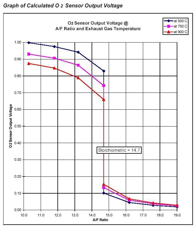

ran my buddies mid 12 second GTO tonight on the worst of nights to race 75*+ dewpoint, 85 degrees, just awful. First run he was about a car and a half two cars ahead of me, but he got the jump by a long shot, second time around I held his rear bumper up to 110 before we let off, but he claimed his trans was having trouble shifting :rollseyes: all in all though, i was happy with how the car performed, probably not a 12 second car just yet but it definitely has low 13's in it to be that close with the goat. The distance he put on my 14.6 second integra when we raced one time was about 10 bus lengths. lol So this was a drastic improvement.
Thought id post a clip of my log file from the race and show what ive been reading. High end MAF table (which was set to stock at the time) was showing a bit lean, LTFT was adding 5.5% fuel based a previous value from closed loop, and it was putting me right in the ballpark of what i shoot for, for o2mv's on an NA car. KR could be phantom so i increased the decay rate by 50% to see if this goes away or if its timing table related. Possible my exhaust which is STILL RATTLING is causing this. Shifts are almost exactly on point, raised my 2-3 mph up by 1mph to bring it in a little closer to 6200. You can see that the KPA in the area i posted below is dropping off towards redline, 96kpa or so, which is about 2-3 in-hg, which means the car is pulling increasing amounts of vacuum and outflowing the manifold.

You really need a wideband man As that 02 MV reading, can be off. which im sure you know

Yeh i know, ill never know if its at the ideal afr for making power without a wideband for accuracy, but this ballparks it and keeps it from running crazy lean or crazy rich. If I knew the o2 temp id be able to pinpoint it more accurately but I have to just assume that its running at normal operating temp. At the track ill be able to add or subtract fuel and see what nets better results.

That was one of my first investments. And I hope you set your stoich to whatever gas your using it should be more like 14.2 for gas with up to 10% ethanol and of course your normal 14.68 to 14.7 for ethanol free.

Nah, in fact i always tune them a little leaner, something around like 15.2 or so for part throttle cruising. On the honda's i used to go as high as 16 for cruising which would net some pretty nice gas mileage but I wont risk that on 8 cylinders. Granted of course, its also important to check plugs when doing this as well. You start running the cylinder too hot and your gonna run into trouble.
