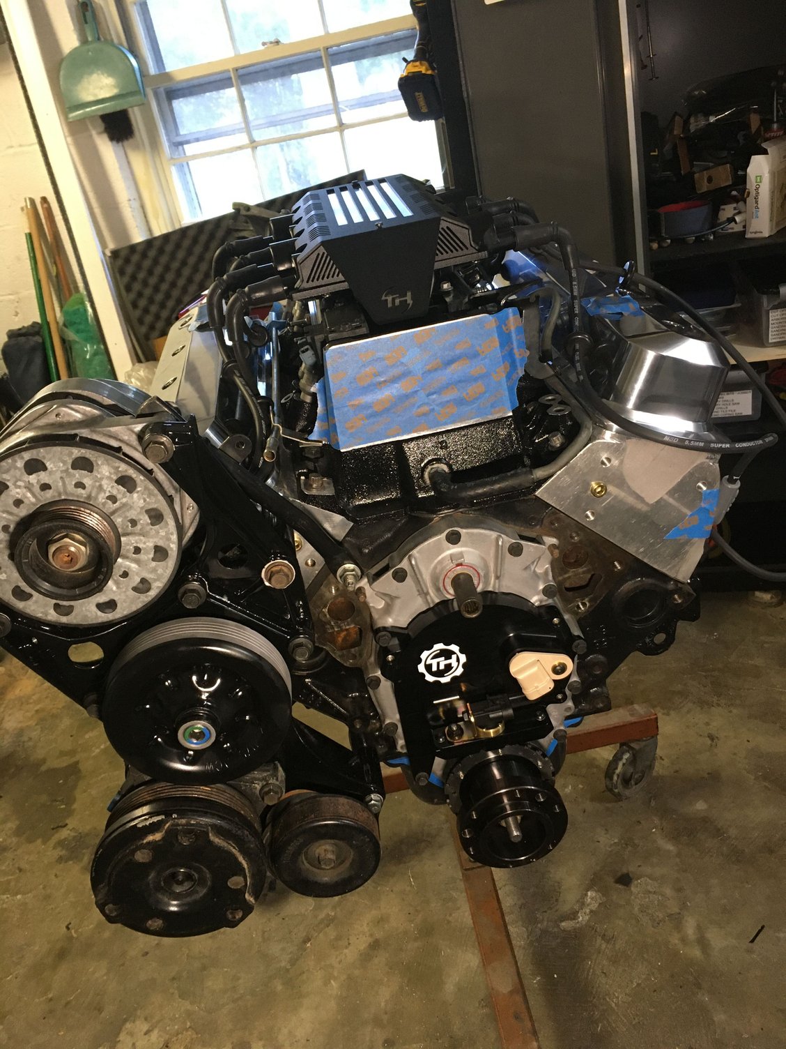

Sorry, I am resurrecting this year dead thread. I have searched, and this seems to be specifically what I am looking for. I am rebuilding my LT1 Impala with a Torqhead 24X and a new RMCR stage 2 (V2hd Ti-trim) centrifugal:
I am totally ignorant to tuning and the 24X, and I have no idea what the tuner will need once I get that far (I am probably 3 months away from finishing my build). Does it make sense for me to get the GM part number 15865791 MAF sensor installed for the tuner, or are there other choices that work better?
Thank you for anything you can teach me.
Mike

Thank you Moe! I do appreciate your input and I know you are more than capable of tuning (MAF) forced induction LT1’s, but with my goals, and the research and information I had found; I decided to go speed density. (This was the tuners suggestion as well)
luckily, I am close enough to get the car completed and flatbed it to the tuner before I screw anything up.

Doug is familiar with the Gen2 LT1 needs and differences. The Gen2 details did make finding a local tuner very difficult.
Truth be told, if I hadn’t already “pregnant” with the completed 396 LT1 build, I would have just done a supercharged LSX swap.
thank you to all who chimed in to help me!

Still at least a month away from tuning. Just finished buying and remounting an Impala accessory drive system (my old supercharger required a Corvette accessory drive). I have to get the engine back in, and I expect the RMCR supercharger kit to arrive sometime in mid-July.
