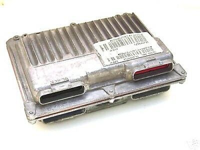

I would try a different scanner first.. then check all of your grounds and connections, including the PCM. Make sure both PCM harnesses are screwed in tight.

If PCM has not been tuned, I would have it reflashed turning off deleted equipment. PCM defaults for the different codes can problematic, it's best just make them go away.

1995 LT1 PCMs dont have screw type connectors unlike the later LS1 PCMs. His should just be the click type that have the "clips" that attach to the socket housing. Like a typical pigtail/sensor connection just to clear up any future confusion for LT guys.
