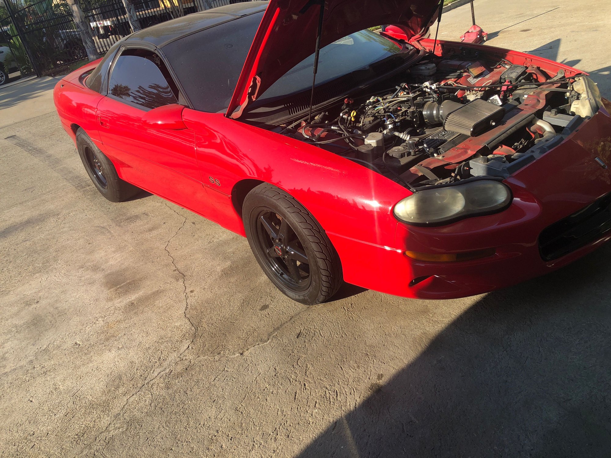

I have a 2002 camaro Ss with a fresh lq9 370 upgraded injectors and 340 stealth fuel pump it idles good and drives good but as soon as I try to go wot it bogs and goes nowhere
i put a afr wideband and at idle itís 12-13 cruising 12.7-13.4 as soon as I try wot it goes lean 15.8-16.2..any ideas can it be the tune ?
