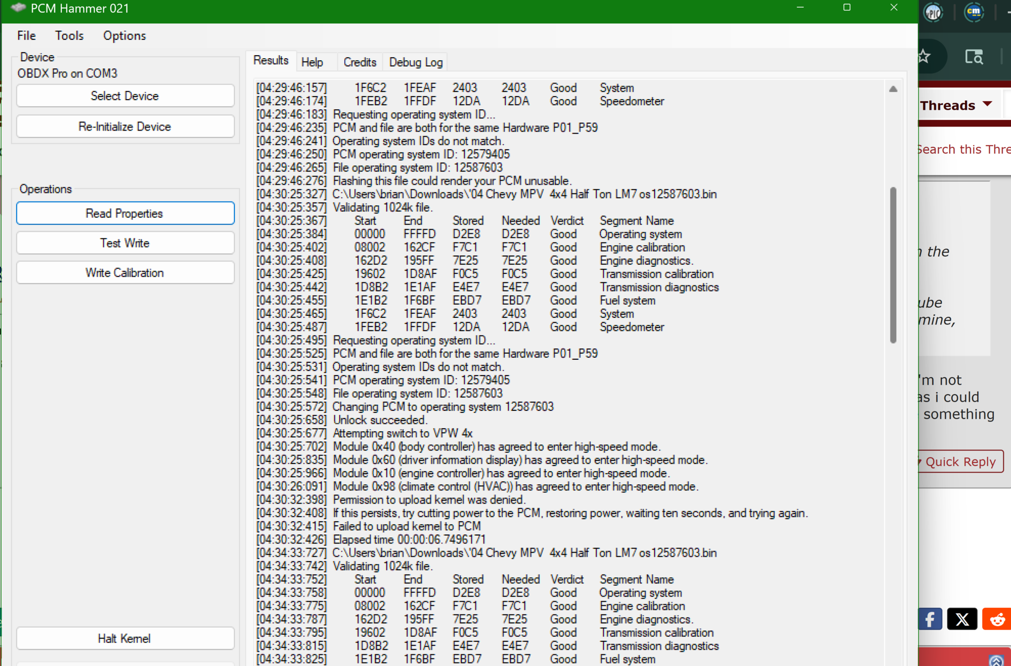

Ok uploaded the corvette OS and Bin and now I have a no start situation. not even turning over no click no nothing. Lights on dash come on but that's it. Yes i verified the antitheft was turned off. I think so anyway.

Did you notice the last few messages from when you flashed the OS? I suspect that there was something in there about running into trouble during the flash.
This process will almost certainly bring it back:
https://ls1tech.com/forums/pcm-diagn...ck-bypass.html

Did not work. Tried back up PCM and got same result. What else could have happened to cause this to happen? PCM Hammer says all the sections are ok just can't get the OS and fails out at that point every time even after grounding that spot on the board right before it tries to communicate. Really bummed out I was right there, SMOG lined up and just needed to get the registration fees together and now this....

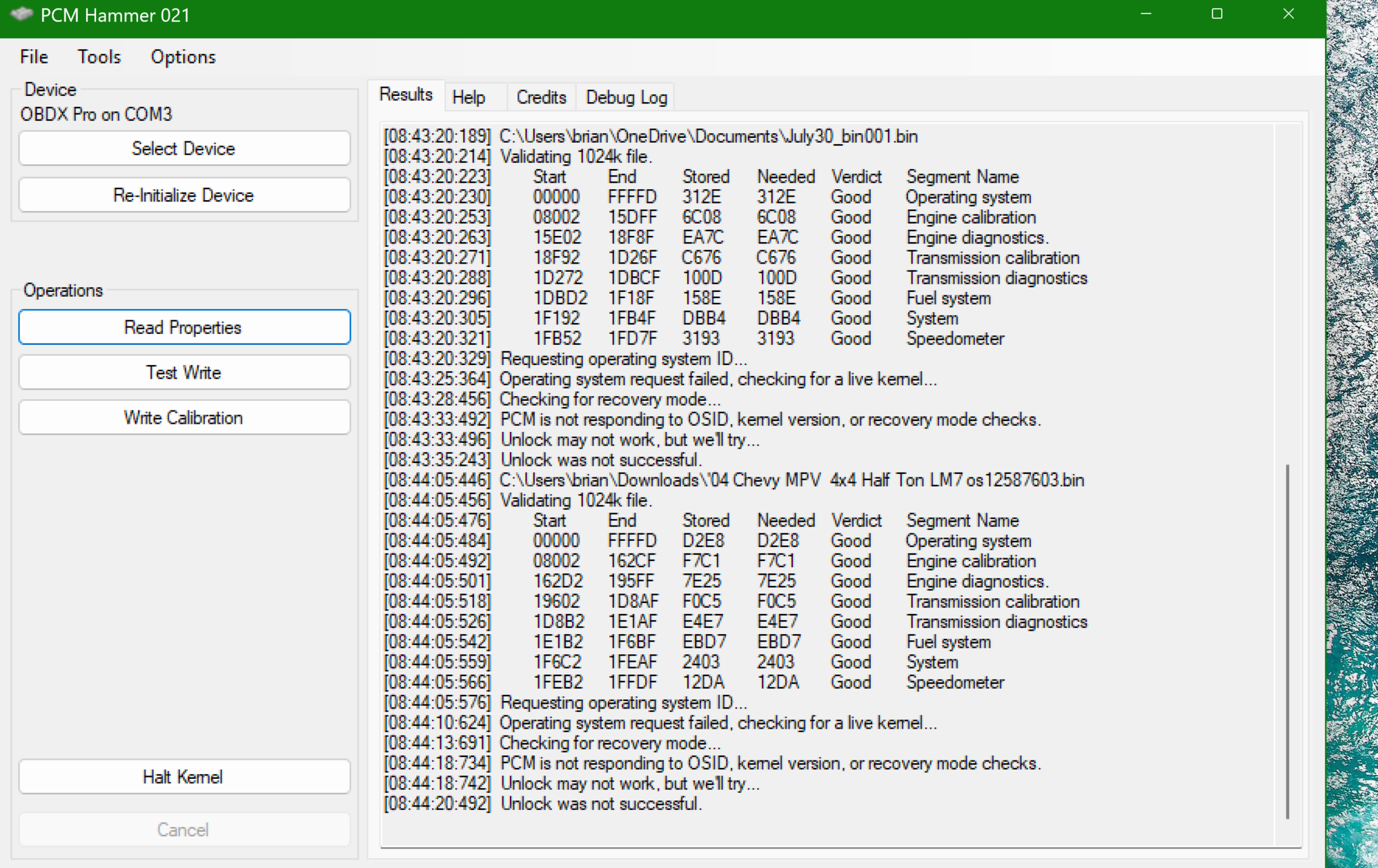

just too further confuse me this just happened. got it to read and then it won't and won't let me write to it

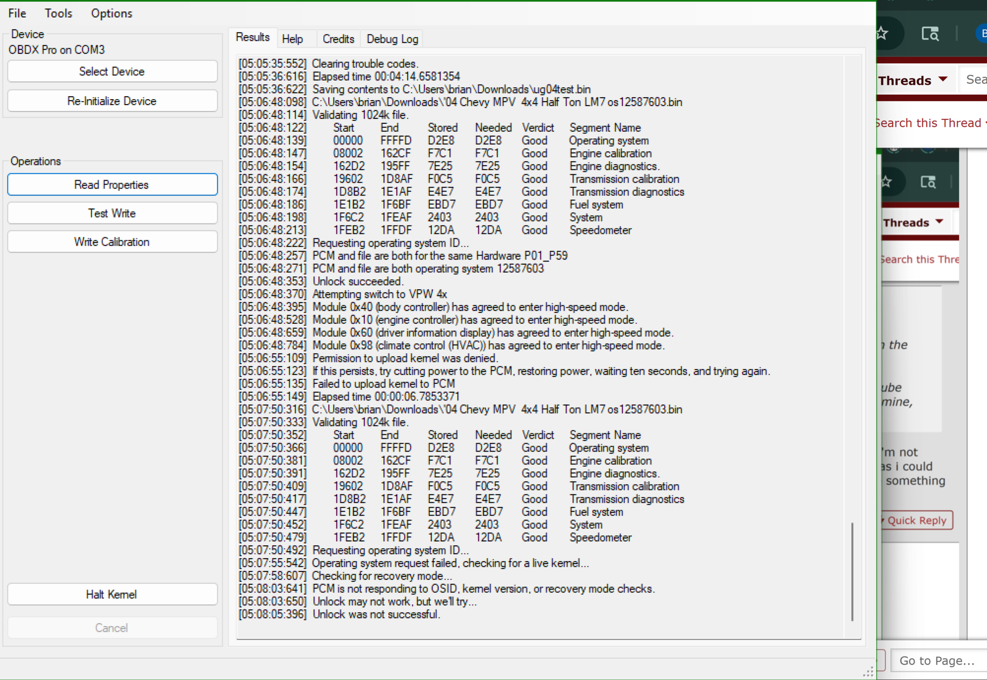

One more thing - I get that "permission to upload the kernel was denied" error every once in a while, both on my desk and in my car.
Power off, power on, wait for the 10-second timer... it almost always works after that.
It's pretty random and I still don't understand what causes it or how to avoid it.
But in the second screenshot, where it tries to ask the PCM for the operating system ID and doesn't get a response... that usually means that the wiring is bad or the PCM is bricked. Since the PCM worked fine right before that, I'm guessing it's a wiring problem.

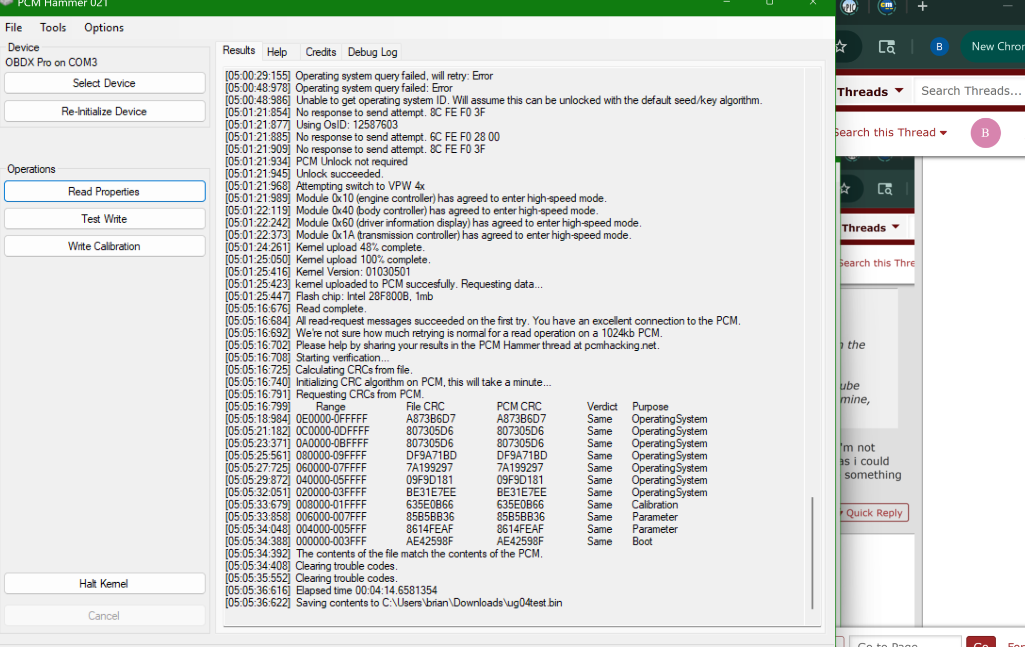

I'm gonna run thru wiring and check them both on the bench and see whats up I can find out that way. Not much choice since it is the only 2 I have and both have vats enabeled or just bricked so bad fuel pump doesnt come on. So getting one running isnt an option at this point untill I sort out whats wrong with them.

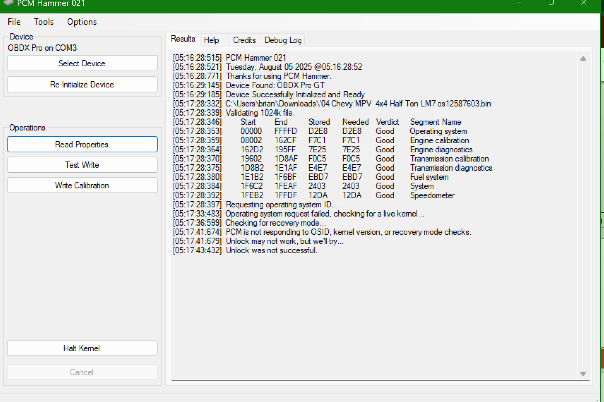

any wiring problem I should be looking at first? all my connections seem to be there no wires pulled out of connectors or twisted weird looms or anything to cause alarm visually.
that is what I just got on the bench.

The PCM just needs power to 2 pins, ground to 1 pin, and 1 communication line... double and triple check. And check the voltage. The fact that one PCM gave you a successful read makes me that that one is probably healthy, so if you can't talk to it with a bench harness, I'd be inclined to think that the harness is the problem.
It would be interesting to see what messages are sent from the PCM when power is applied. Or how many messages. When a healthy PCM gets power it spews a ton for messages for a few seconds, then it sends a message every couple seconds.
If I remember right, when a PCM with a single corrupted flash block boots up it will send a much smaller number of messages, followed by a message every half-second or so.
Does the OBDX have a light that blinks when there's a message coming from the PCM? That might be interesting to watch.
