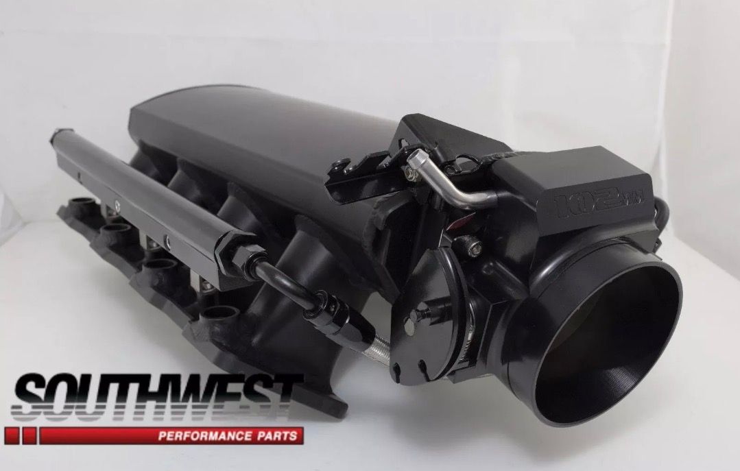

Is that this particular intake? Seems for 500$ I would not have to buy a LS3 intake and a throttle body to match my cable drive and just find injectors. Just worried the LS3 would keep power down low better?

Quote:
yea looks about the same I bought it from top street performance . Ls3 would give you better low end but I don't believe enough to make a huge difference and you will pick up more up top and it fit perfect I was impressed I will hopefully be running again and dyno next week so hopefully I can post some graphs

So you actually used this? Wasn't sure if you only mocked it up. Was it the same style throttle body?
Yea the same thing I can't see a see a difference my butterfly was a different color rn but I can't see I think it looks good with silver fuel rains and tb just imo

Ok, I cannot find anyone that says it works worth a **** or have any feedback at all really.

Ok, someone told me there was a video of the front of a intake like this flexing when the throttle was mashed. Any idea if yours did that?
Honestly I think most people just hate becuase it's not named fast or made in the USA 🇺🇸 I know that it out preformed and out flowed the Holley sniper mine doesn't flex or get heat soaked like all these ppl say look if your looking at intakes like this your not trying to spend alotnof money it's a good deal and from 4200 rpm and up it does very well if I could afford a hand made masterpiece I would be I can't and what I got was a good price and works well for me gives me some show and some go sometimes just do it and stop listening to all the master internet technicians and machinists and gurus there's alotnof ppl who know there stuff and most just go off hear say

Posts: 3,190
I think the story came from some knock offs of another builders design. There are only so many ways you can build a low profile sheet metal intake. There were accusations of thinner gauge steel since they were form china, as well as the smoothing of the plenum not being present or the runners being rough on the inside, and both of these affecting the performance of the intake. Lets be honest though, if you are going sheet metal to begin with you should be aware of the low end peformance loss on a stock engine. my 414 in my sig is a l92 with ls3 intake and it makes 400rwtq at 3000rpm. I wouldnt say its giving up much. Would i gain some from a sheetmetal. Im not sure it may just shift the numbers around more than anything. Given I dont race it, im not really after peak numbers so if one day I decide I want that look id probably go the less expensive route as well.
there has always been a stigma about cheap chinese steel, how valid it is im not sure. I think if I were really after the peak power and head heads that could make use of the volume id probably go for the real deal. Wasnt there a dyno comparison recently amongst intakes and one of the ebay knockoffs was on it? may have to look at that. A stock ls would likely loose a lot of low end power with this though and that would be a trade off you would need to accept. Now if you are a cube monster you probably wouldnt even notice the initial drop off.
