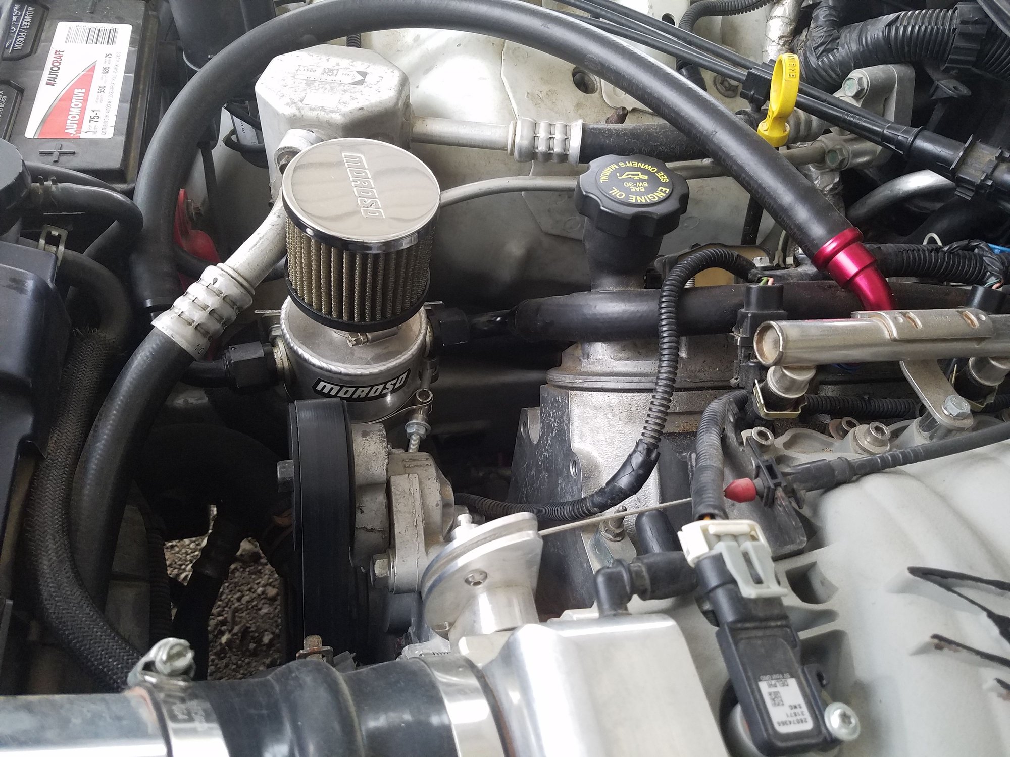

Guess how much oil I get from this breather can when I open the drain. Zero! My engine oil stays in the engine! Guess how much oil makes its way into my intake manifold. You guessed it! ZERO And you know what? That's a good thing! Just saying
Of course not, you're not pulling any vacuum through it. It's strickly a breather can and you're not pushing any fresh air in your crankcase either.
mikedamageinc is offline
Old 01-12-2019, 11:13 AM
01CamaroSSTx's Avatar
Join Date: Feb 2015
Location: Texas
Posts: 638
And I need fresh air in the crankcase for what reason?

Yeah everything is capped off and the only things pulling vacuum are the A/C and brake booster. I went this direction to keep the blowby gases and moisture out of the intake manifold so it does not mix with the air/fuel mixture. This is not a daily driven vehicle but I run a full synthetic oil and change it every 2,000-3,000 miles It would not pass a visual inspection for emissions but can be easily remedied by simply swapping to factory valve covers and connecting the hoses back up like stock..
You could have skipped the catch can and just put the filter on the vent tube. What do you mean your a/c is pulling vacuum?

There is also a very small line that plugs into the back of the intake manifold and I believe it has something to do with the air conditioner.
