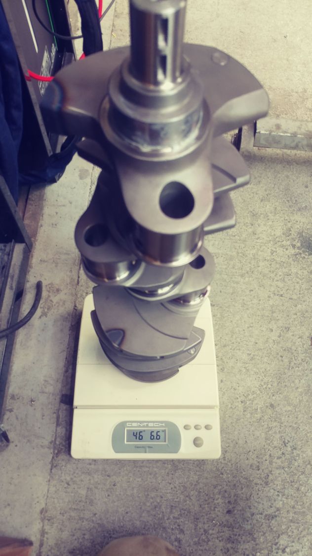

Wanted to share this pic I thought I had but didn't see it this is what my crank weighed in at after balancing there was some mallory added.
