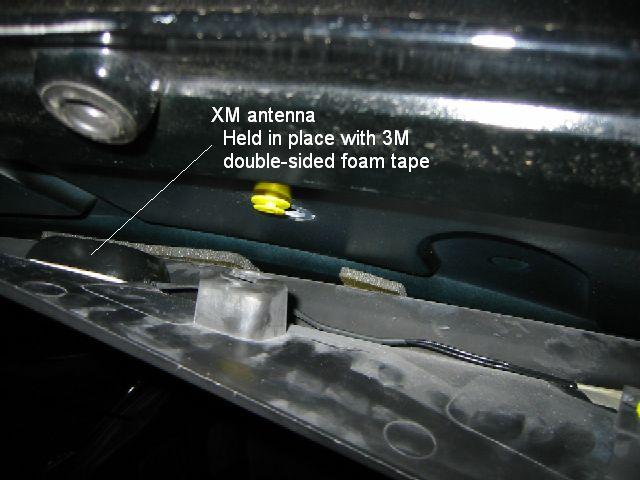

I had this exact problem myself two weeks ago. VIP1 gave me some excellent ideas and I followed them - works like a charm. Mount it IN the hatch. Well here, let me copy and paste the PM he sent me:
Actually I have XM, but thats besides the point.
The panel is just held in with some plastic "trees" in some spots. If you start at the back and pull down, you can look in with a flash light and see where they are to concentrate your effort. Be careful to pull evenly on them and not yank so that you don't damage the panel or the plastic "trees", Sometimes the panel will come down and the plastic "trees" will stay behind. If that happens, don't panic. They are just attached to the panel in a slot. Pull them down from where they are stuck and re-insert them in the slot from which they let go. If any get damaged, they are replaceable. You can typically find them in the Help! isle at auto parts stores (Pepboys has a bigger section).
In the pictures, you can see raised boxes/towers on the panel. The plastic trees are on those. The plastic tree pulled out of the middle one in the first picture (you can see it better in the second picture), but you can still see the yellow plastic trees on the other two.

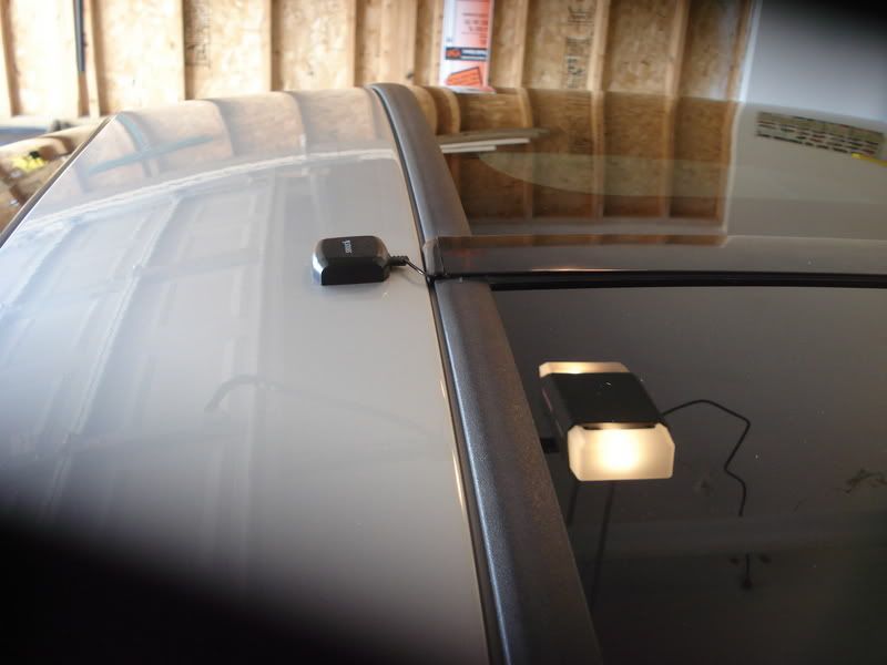

I hate drop outs so I mounted mine right behind the black t-roof divider so that it blends in somewhat. I was going to paint it body color but it looks okay like it is. I ran the wire under a seam under the roof panels and continued it through the plastic molding, under the door panels, under the carpet, through the glove box, behind the bezel to the radio.

Yeh, I have thought about mounting mine on the T-Top divider.. It'd blend in even more there..
However, some guys are mounting it completely hidden and getting zero cut outs so I think I'll try that..
