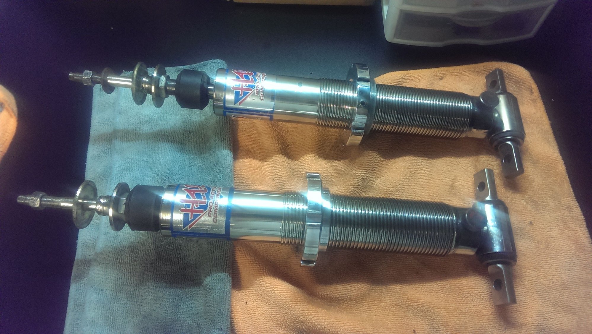

A friend gave me a set of shocks he had sitting in the garage for some time. He said nothing was wrong with them when he took them off, he just went with a different type.

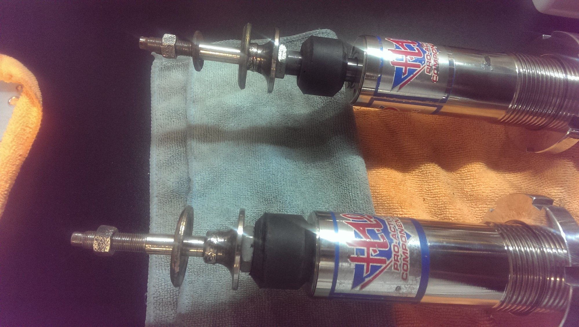

Before I take mine off I just need to know are they missing any parts at all. Each shock has one bushing on the top, 1 curve washer and one has one small washer.
I did replace the bottom bushings.

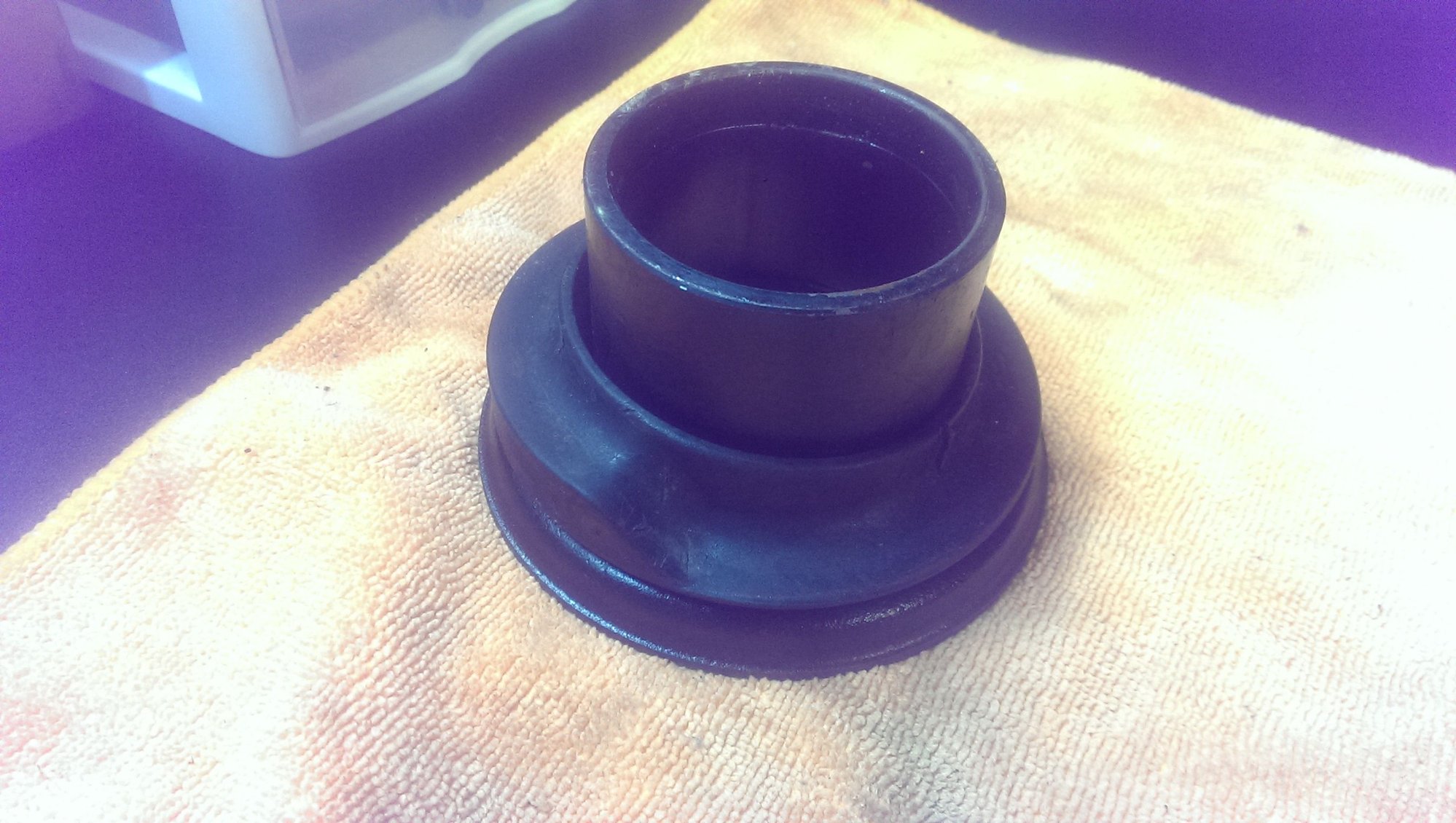

And it had this piece in the box. Not sure if I need it, I only have one.
Am I missing anything to install these on my 01 Camaro?
Thanks.

Are they coilovers?
Also: Shocks = rear
Struts = front

They are coilovers/front struts. Thanks.

Where are the springs?
You can re-use your front top hats but I just bought new ones for mine.
I believe the black rubber seat is for the spring but I could be wrong.. Vikings were a little different.

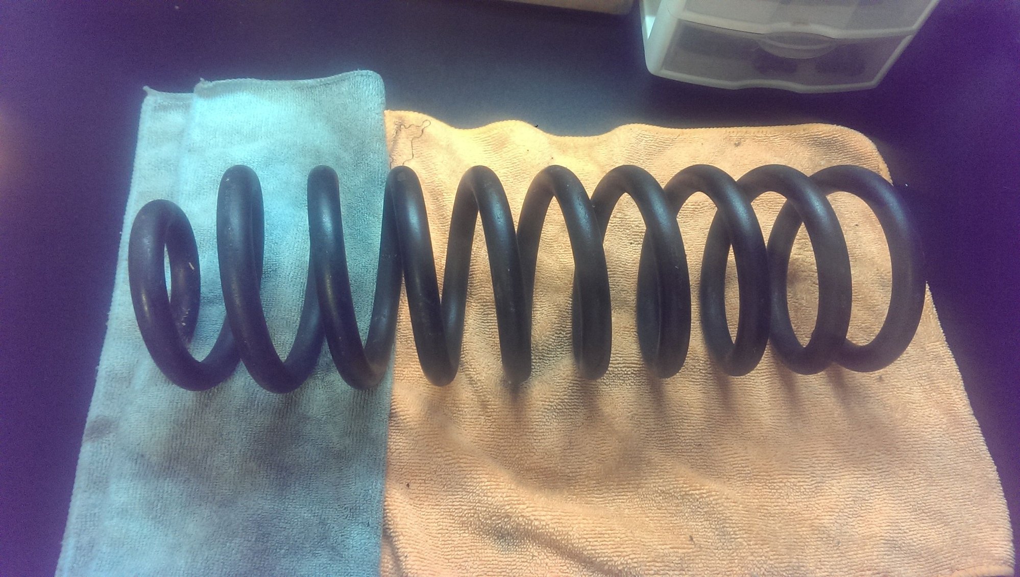

Here's a pic of one of the springs that go with it.
Okay so I am able to use the factory top hat off my factory shocks?
So I just need to find out if the rubber seat goes to the shock.
Thanks!

Yup! Just compress the stock spring and unscrew the little top hat screw from them (make sure the spring stays compressed. Then youll need to make sure your height adjuster on the coilover is all the way to the bottom so the spring fits with the top hat. Looks like you have a new screw on the coilover for the top hat (my old one was rusted as hell).
Now that I see that spring that's exactly what the rubber seat is for.. should sit right on top of the height adjuster

And are the isolators the same has the rubber seat I posted a picture of?

It looks like the rubber seat sits on the height adjuster and then the spring sits in that.. someone correct me if I'm wrong.

Different part. The Moog ones I mentioned go inside of the top of the upper mount. Spreads the load from the shock/spring so it doesn't pull through the mount. The rubber part you showed comes from the makers of those coilovers only. Different part.
