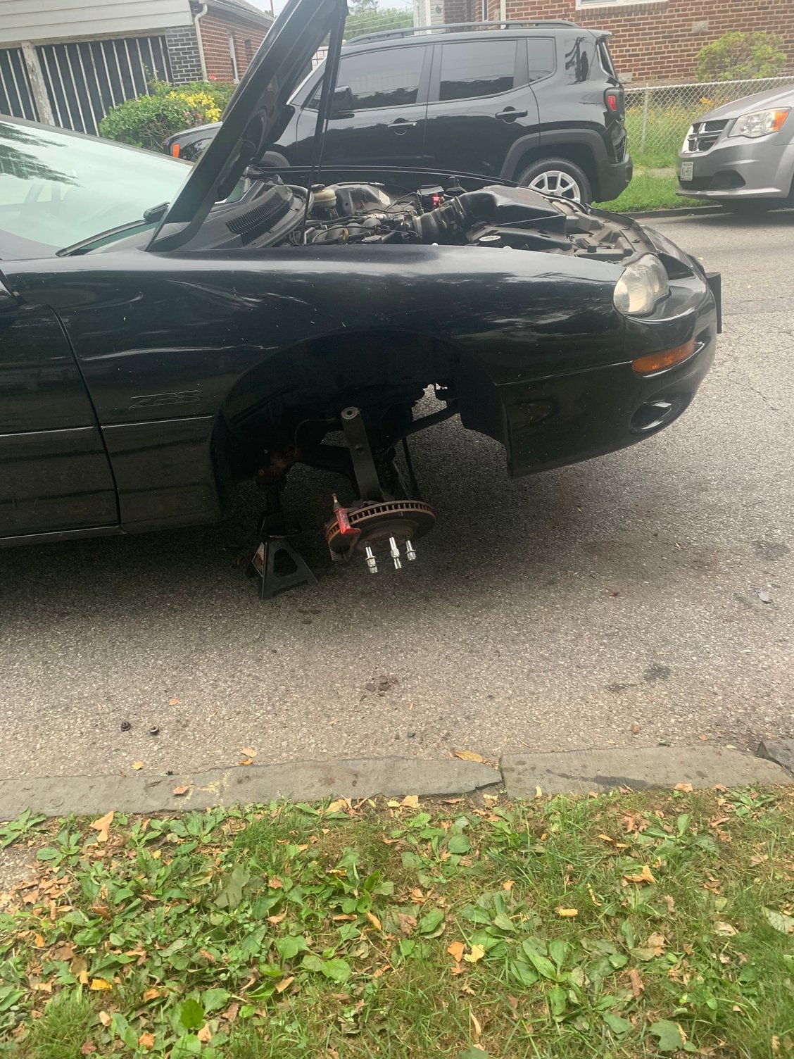

I need to replace upper right control arm and part is discontinued from dealer .I need part recommendation ,I found
mevotech its made in china.

Mevotech seems to be the only available, option is a 'used' one.

I guess mevotech it is.The original one I got over 161,000 miles on it. I got my moneys worth.

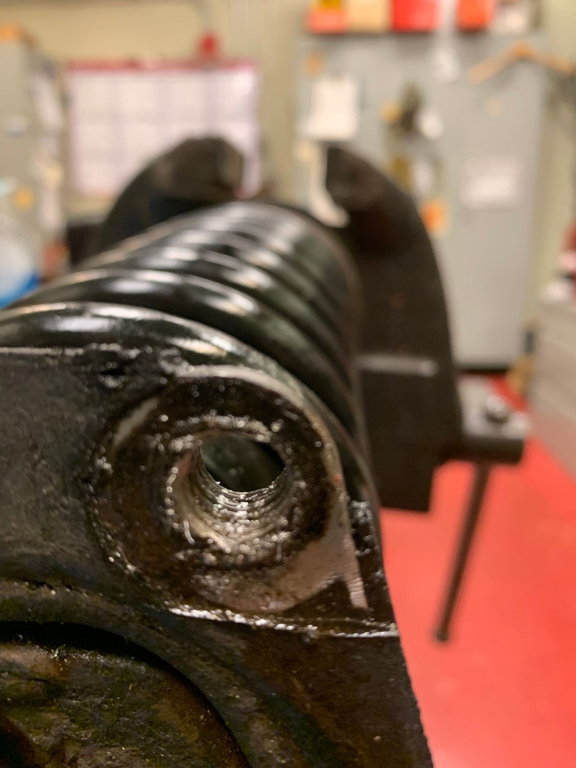

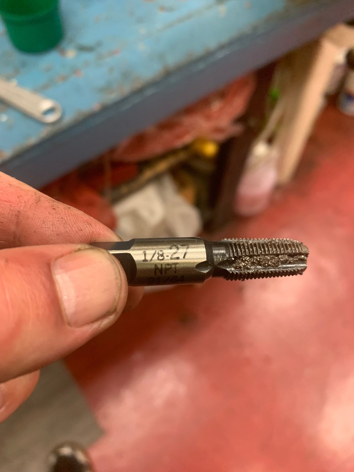

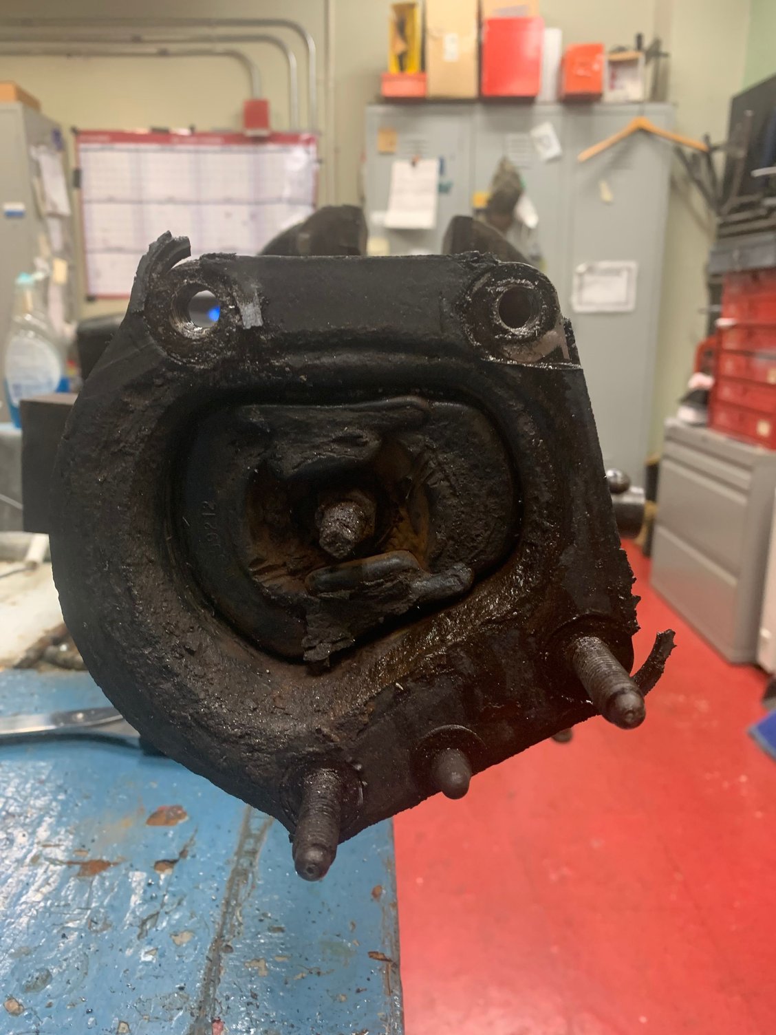

I did the passenger side I wound up going with the movatech. My only issue was I snapped the two bolts on the upper strut it was a nightmare to get them out I had to drill out the broken bolts then I had to re-tap the holes the strut mount is discontinued.

You can buy replacements at your local part store.

Who knew I drilled four different size bits .
